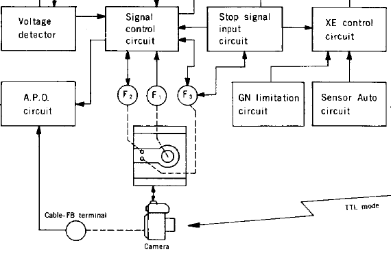

I found this page in the Minolta X-series service manual. I'm not sure what the X contact is, or the F1 contact, but I suppose I can figure it out. It might be a broken wire inside the camera, but something that is only involved in the flash operation because the rest of the camera functions normally.
I also considered using a flash sync cable to see if the flash could fire that way, but I'd have to buy one first.
the X contact would probably be the X-Sync connection, the center terminal in the Hot shoe. the other one should be one of the smaller ones where the flash has a chat with the Camera.
found this block diagram of a Minolta 360PX flash. This might identify the contacts. the flash shoe is near the centre of the Diagram.
