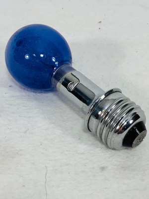

Anyone know of a good E27 (Edison) flashgun with a universal bracket (not dedicated to say a Speed Graphic).
I have a bunch of E27 bulbs I'd like use, and while building one would be doable, I know it's going to take a long time to get it in a finished state.
Is the Minicam guns good?https://www.cameramanuals.org/flashes_meters/minicam_flash_units.pdf
Seems to be the only brand I can readily find.

I have a bunch of E27 bulbs. Is the Minicam guns good?Seems to be the only brand I can readily find.
I find this surprising. I never ever came across any screw-base bulb nor any respective flash.
Helge
Jun 27, 2018
3,938
Denmark
You’d be surprised what hides in peoples attics and cellar rooms.
I too had never seen one, other than in museum settings until recently. And then about a year ago I was overwhelmed with opportunities to buy screw bulbs.
I have plenty for the foreseeable future right now.
Don’t pay eBay prices or anything close and don’t buy them in anything but lots.
Five to teen at a time simply gets too expensive.
Screwbulbs live a dangerous life in that people mistake them for old, possibly faulty, regular bulbs. Kids discover a few and waste them on pointless games.
Or they are held hostage forever by greedy idiots who get ideas from eBay about how much something is “worth”.
Never ever pay more than €$£ 0.3 per bulb.
En masse you should pay a lot less.
They are not collectors items, no museum is interested in more.
They are useable great photographic items. But is never more than a means to an end.
