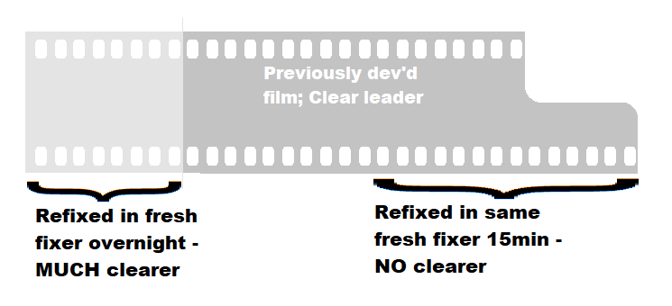

I saved the clear leader from the last 35mm film I developed (HP5+). I put half of it in fresh fixer, forgot about it, and it soaked overnight. The re-fixed side is noticeably clearer than the unfixed side. That said, the film didn't look particularly unfixed to begin with -- this is just a routine test I do.
So I repeated the test using a more reasonable time of 15 minutes, and the re-fixed side is no clearer.
What's going on here? I would expect 15 minutes in freshly mixed fixer (Ilford Rapid Fixer 1+4) to be sufficient.

I think you are saying that you developed and fixed a roll of film. You then cut off the clear part of the leader immediately before the developed frames and then dipped half of this clear leader in fix again overnight. The re-fixed( second fix) half after many hours overnight looked no different from the once fixed leader whereas it is normally clearer? A third fix of 15 mins made no difference to things.
If the leader was fully developed and fixed when the whole roll was developed and fixed fully, I am unclear why a second overnight fix would make any difference. The leader is already fully fixed. isn't it? However I have never tried this so cannot speak from experience. It may be that my confusion arises from misunderstanding what you actually did.

Thanks for the diagram but I am still confused. The darker part on the right as we look at the leader, looks to be that first part of a film leader which is exposed to light when you load the film into the camera. Isn't this part zapped ( a good "Superman" comic word:D) with light so on developing and fixing goes black. The part on the left is that section which doesn't see any light but is wound on to the camera beyond the section that contains the exposed frames.
Both the light and the dark sections of the leader are meant to be fully developed and fixed in the processing stages. If they are, then is it not the case that that neither the light nor dark sections can be visibly affected further with more fixing but see my qualifications of this statement below?
If my understanding of the chemical process is correct then it suggests that the clear section may not have been fullyfixed during processing and a second fix ( the overnight fix) fully fixed it so that it showed as clearer. The dark exposed leader section was also not fully fixed during processing but being exposed and thus dark, full fixing might not show up a detectable difference?
If I am right then it may suggest that the whole film wasn't fully fixed so the exposed and processed frames are not fully fixed,. Whether this will matter in the long run might be a function of how close to fully and correctly fixed the film was during normal processing. If the fixer was fresh and the fixing time in processing was correct, then it might simply be that the "much clearer" leader post overnight fixing is a clear leader that has now been seriously over-fixed by several hours so more fixing of the exposed frames of the film is not beneficial and might be detrimental but of course your question may not be directed at whether the film was correctly fixed. I have never seen the effect of fixing for several hours on a film but clearly from everything I have heard, it can be over fixed.
Have I now understood what you did correctly and if so, do my conclusions make sense?

Makes sense, but the diagram with the cut leader drawn out was just meant to show that I was working with the film leader. I cut off the fully exposed portion for this test, so I was only ever working with clear (unexposed) film. Sorry for the confusion.

It's most likely that the antihalation dye in the film base is being 'soaked out' by the long immersion in your fixer overnight.
A second, and probably less likely cause might be fog produced by physical development due to light exposure since it's the portion of the leader that is always outside the canister that is the portion that is slightly darker.
Neither case is anything to worry about.
It looks to me like there was some base fog (which there always is--that's not a defect) and the fixing overnight bleached that back to the clear plastic, removing the base fog.
Haven't any of you taken an out of date B&W film and run it through fixer to get clear film?. I don't remember any base fog still in the film after ten minutes in thiosulfate fixer plus wash. Remember 35mm has the most base fog and might take longer. I don't think even fresh thiosulfate would bleach base fog in ten minutes and would be surprised if leaving it in that fixer all night would do it. My point is this is one of those things we can find out in our own darkrooms. using thiosulfate fixer, not quick-fix............Regards!
bvy,
First, your fixer is likely working just fine; fully-fixed film has a lot of other stuff in it, most of which is supposed to be there, that keeps the film from being completely clear.
Fixing way too long (e.g., overnight) could:
1. Bleach out the base fog on the film. Every developed film has some base fog. It is a normal result. This makes the clear portions of film a bit denser than the clear plastic base would be, but that's how the system works; it's supposed to be there. If you had fixed a negative with an image that long, the image would be bleached as well.
2. Remove other components in the emulsion. There are some sensitizing dyes, etc. that often are still in the emulsion in residual amounts even after proper processing. While not altogether desirable, these are also accepted in fully-processed film because more fixing or other treatments needed to remove the dyes would adversely affect the image. So, they are kind of supposed to be there too.
3. Remove the emulsion entirely. The gelatin emulsion on the film itself can be removed through extended wet time. The gelatin swells and separates from the film base. If this happens, then the remaining acetate film base is very, very transparent in comparison to the film with the emulsion on it. The emulsion is definitely supposed to be there :smile:
Any of the above could explain what you are seeing. However, whatever the reason, it is not underfixing that causes this. Don't blame the fixer or the time-tested and accepted tests for proper fixing time.
