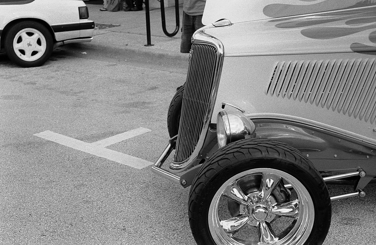

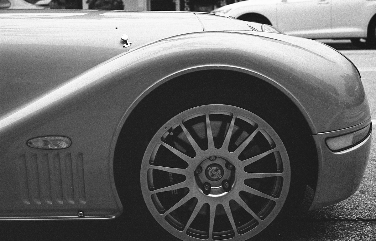

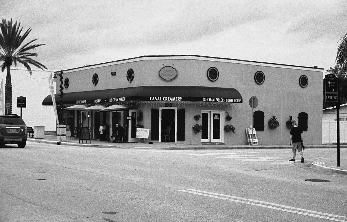

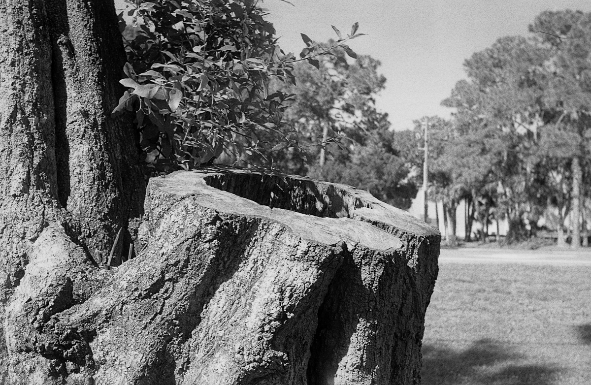

I developed some shots that were made 7 months ago using a Kodak Retina Ia w/ Xenar 50 3.5 lens (yellow filter and Tri-X). This is the first time I've used Fomadon R09. 1+25 dilution and 7 1/2 minutes at 68 degrees w/ gentle agitation for 30 seconds, one inversion every 30 seconds after that. I like it, but it sure is different than my usual D76. Here's the positives: The developer went in brown and came out purple! Neat. It's one shot, which is great for consistency. There's grain, but it's attractive in my eyes. In 120 it should be much finer. People complain about flat negs when using this w/ high speed film but I didn't have that problem.
Here's the one negative: It isn't a very sharp developer, at least w/ Tri-X. I've used this camera and film combination w/ D76 and Acufine in the past, and both gave sharper images. I'll try it again w/ my Leica lens and see if that improves things :]
Unless my memory is making this up, I seem to remember reading that the dilution isn't going to change the sharpness/grain, it will only affect the developing times. True?

Well, we'll see. I have another roll washing now that was developed 1+50, and if I can get out tomorrow and finish the roll in my newly refurbished Canon FTb, I'll develop it at 1+100. Sure would make for a long development time that way though.

Looks sharp to me, there's a difference between sharp and fine grained.
Rodinal is a sharp developer but will show more grain than other developers, especially with films that are already NOT fine grained like 400TX.
But those images look great to me.
Rodinal is one of the most versatile developers, it also means everything you do to it, will change it's affect on your film.
If you shake it a lot during agitation it will change from if you are delicate with your inversions, if you invert It very slowly and only do one inversion over the 10 seconds over inverting fast 3 times it will look different and the grain will change.
Dilutions will change it again, and each film favors a certain dilution, tmax may favor 1:25, and 400TX may favor 1:50 etc etc.
Temps will also change it again significantly.
Keep at it and find what you like best.

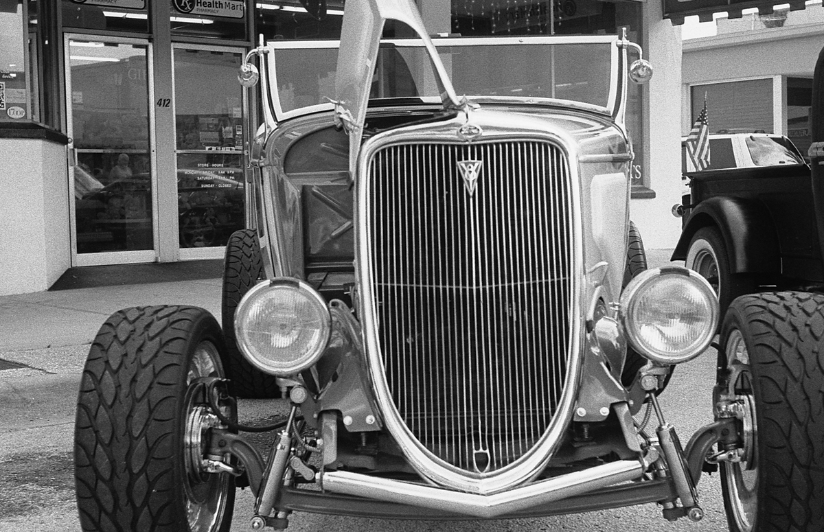

Thanks for the good vibes Stone, but they aren't up to the D76/Acufine development schemes of mine. That's some darned interesting stuff you posted though. Seems you can get what you like if you stick to it, but I'm too dumb and lazy for that. It's back to D76.
I did these just now at 1:50. Guess what....flat, grainy negs! So that's how you do it. At 1:25 they were pretty nice, though not as sharp (or however it's called) as I expected. At 1:50 things look pretty bad. The negs are thin and a little underdeveloped too w/ light edge markings. I developed these for 14 minutes at 68 degrees w/ the same agitation scheme as above, so from now on I'll stick to a 1:25 dilution w/ this developer. These are from a Nikkormat FT2 w/ AI 50 2.0 lens and red filter.
I'm going to buy another one of those Retinas w/ the bottom of the line Xenar 50 3.5 lenses. I prefer the way that old Xenar images to the more modern Nikkor lens, and the grain at 1:25 dilution is beautiful. The car is a Morgan by the way.

Well don't fully give up the Rodinal that open bottle will keep easily for 5 years or longer, it will turn brown, but that's normal and means nothing in terms of it's viability.
It's also good for unexpected things, like stand developing with something like C-41 film if you scan. Or some poorly developed B&W thing, semi-stand developing in Rodinal 1:100 for 1 hour (1 agitation every 20 minites). Will give you usable negs.
It's good for a lot of things. But yes it can be grainy, it's best used on 100ASA or less films that are already fine grained. I use it for both FP4+ and PanF+ and when shooting 4x5 I'm fine using it for HP5+ but my favorite is Acros100 in Rodinal 1:50.
