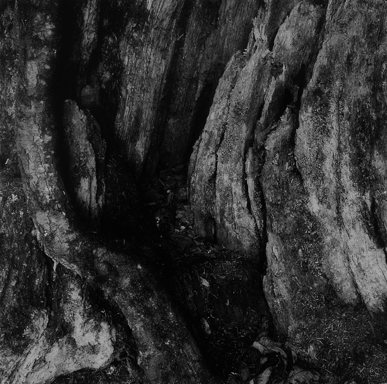

Here is an image with good contrast, but without many deep, dark shadows:
And here is an image with lots of deep, dark shadows, but relatively low contrast:
