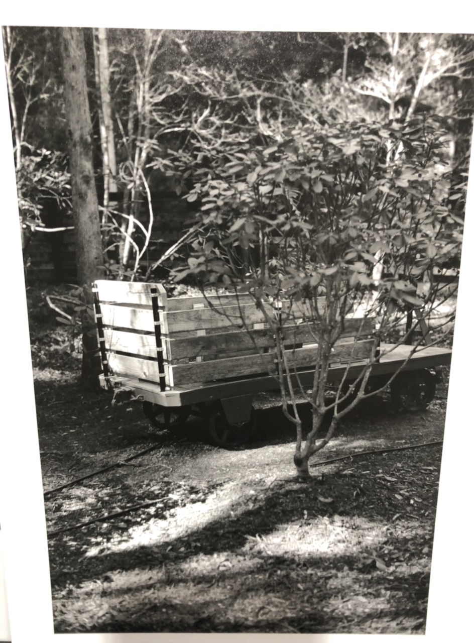

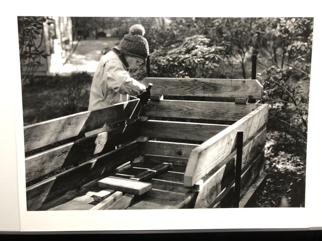

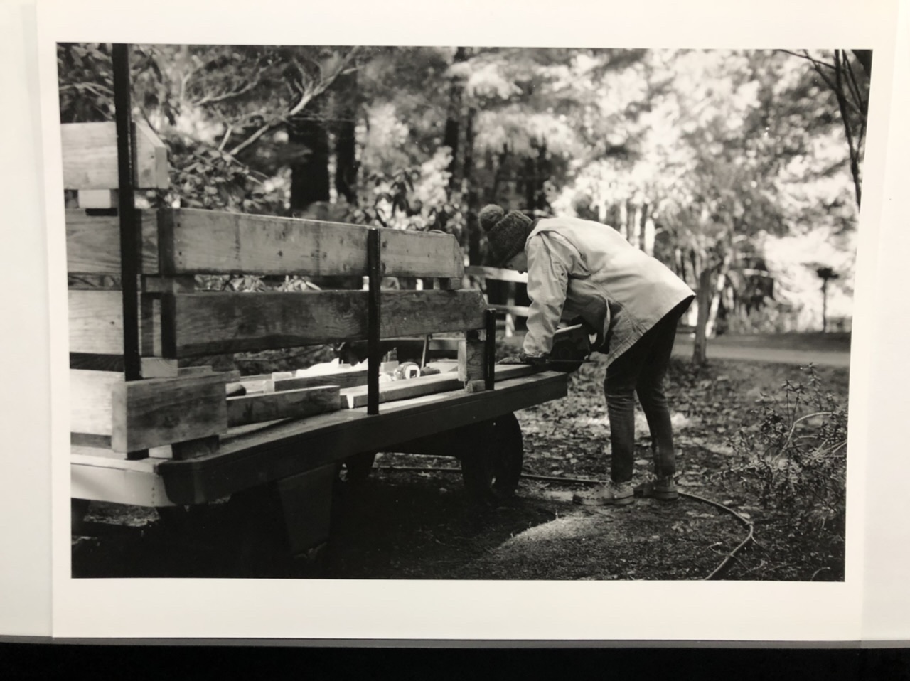

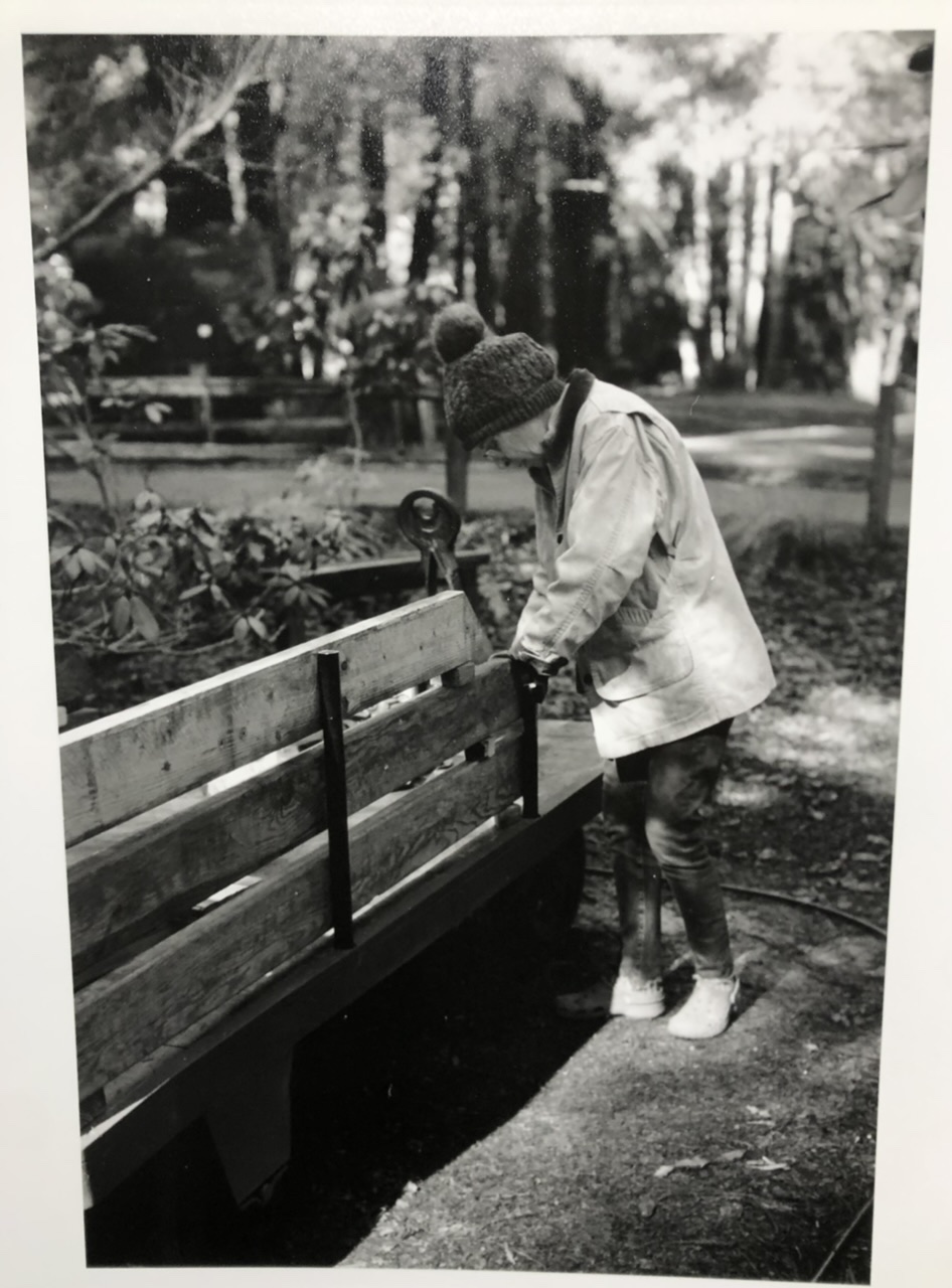

Yes I shot at box speed and underdeveloped by 30 seconds. So turns out it was underexposed and underdeveloped like you suspect.
I just loaded the same camera with more of the same and set the compensation for an extra 2/3 of a stop, and this time I’ll up the development another 30 seconds to match the minimum.
Here are a few prints shot with iphone. Not sure why I even bother posting these as iphone adds contrast which is blowing highlights. The only way I know to post a good print shot is to do it in the studio with strobes and polarized light. Wish i could come up with a quick and easy way that accurately represented the print. However not too bad considering my mistakes. I’ll post shots of the next rolls as soon as I can and I'll take the time to photograph them better.

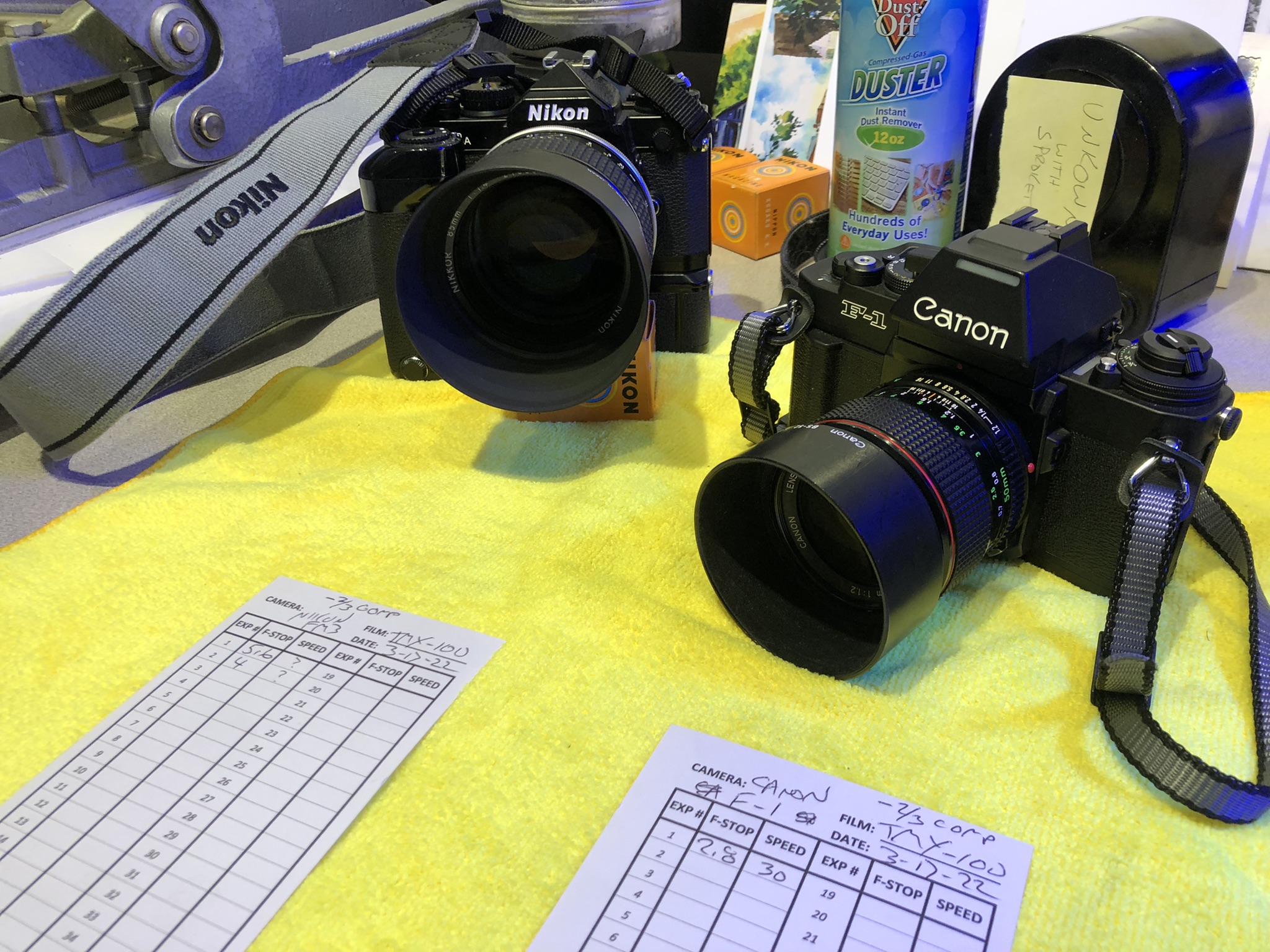

My two favorite 35mm film cameras that will be helping me dial in this film. They both have working have meters that have been tested using metered strobes and charts in my studio.
I just noticed I put -2/3 stop EC when actually it's +2/3.
