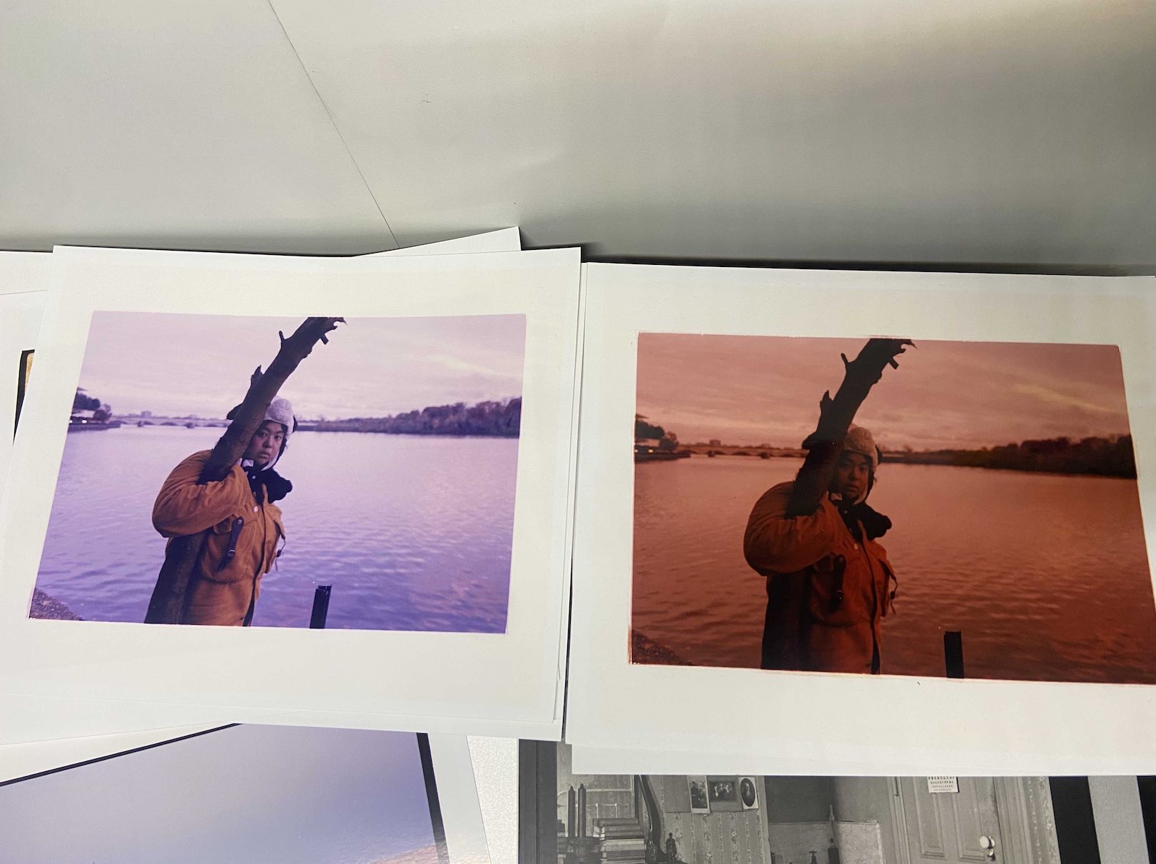

I was noticing recently that while using this enlarger, I tend to make most prints at what seems a larger than average number count, i.e. y80 m120 (as opposed to what others recommend to start - typically around y50 m50) and wanted to run a color balance test.
This was an image I was having trouble finding good color with.
The below print is at opposite ends cyan -> red - the left (cyan) exposure is at y170, m190.
the right (red) exposure is at y30, m50.
While this is a particularly "blue" photo (taken at dusk, on a lake) it seems like the extremely large # cyan color balance is far closer to correct than the red would be.
Is this normal & expected, for the color range to vary this high, to sometimes require this high of a color adjustment? Or might this be more unusual to be using this extreme of numbers? It makes it a bit difficult to pick a general starting point for all negatives.

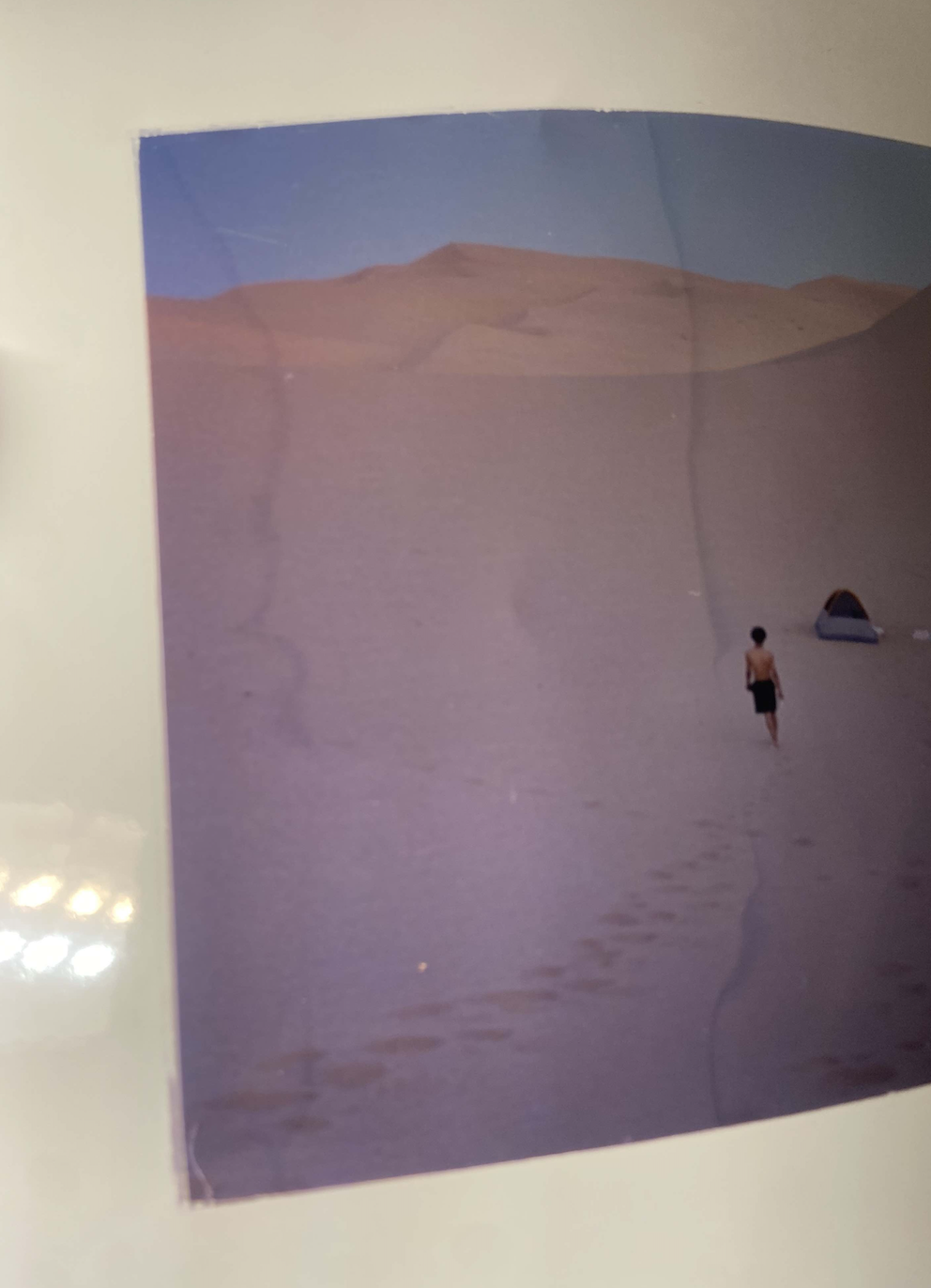

Additionally, one issue I run into is the occasional streak lines on the print. I assume that this is from an improperly clean/dryed drum, as I process in a jobo, though I've seen some conflicting info that this particular mark can also appear as a result of not using a stop bath, which I am not. Wondering if this looks familiar or if anyone can advise?

Once the colors get seriously out of whack, I find that filter values seemingly affect the end result a lot less. Which means that you can dial in pretty extreme settings and things don't change around much. Whereas if you're working close to the correct color balance, a small filter adjustment does appear to make a big difference. It's probably a subjective/psychological thing, but I certainly do experience it that way.
Neither of those prints look true to life, btw. The left one has a pretty significant magenta cast and maybe a little bit much blue as well. However, if you were to adjust for this, the filter settings would still be pretty far "out there".
I see what appears to be a yellow discoloration to the paper whites around the image. It looks like some kind of fogging going on; enhancing the contrast on part of your example photo I get this:
It almost looks like if you're masking the paper on the easel with 0.5" borders and then mask the negative itself in the enlarger/negative carrier. That doesn't work too well as the exposed 'white' paper margin gets fogged easily. Stray light emanating from the enlarger head will make matters worse. Coincidentally, stray light (and safelight) will also wreak havoc on your color balance. Maybe something to (re-)check?
Yes, that's where I'd start, too. It takes only a tiny bit of blix contamination to get really weird effects.
Are you reusing your developer after it comes out of the drum? If so, your wacky color balance may be explained by blix contamination.
If you're not using a stop bath, it's easy enough to test what happens/if things improve if you do use one. Acetic acid is fine. For one shot, something like 0.5% is fine.
Alternatively/additionally, try processing your prints in trays at room temperature during one session and see how that goes. It's one easy way to eliminate drum-related problems.
That's currently how I'm printing it, and I am experiencing yellow fogging around the non-masked edges, especially on longer exposure times.
I'm printing on 8x10 paper with an easel with 0.5" borders, but enlarged smaller than the easel crop, to allow the entire 4x6 negative to print. I also like to see the borders of the negative to show the full frame / no crop. Are there adjustable easels designed to move the "crop", where I would be able to mask off the edges? Or is there another method of doing this to prevent this yellow light spill-off?
Yes, there are. Most easels have two blades that can be adjusted, and very fancy easels even can have four movable blades. In fact, easels without movable blades are rare.
Alternatively you could cut a mask from cardboard etc., but I admit it's a kludge.
