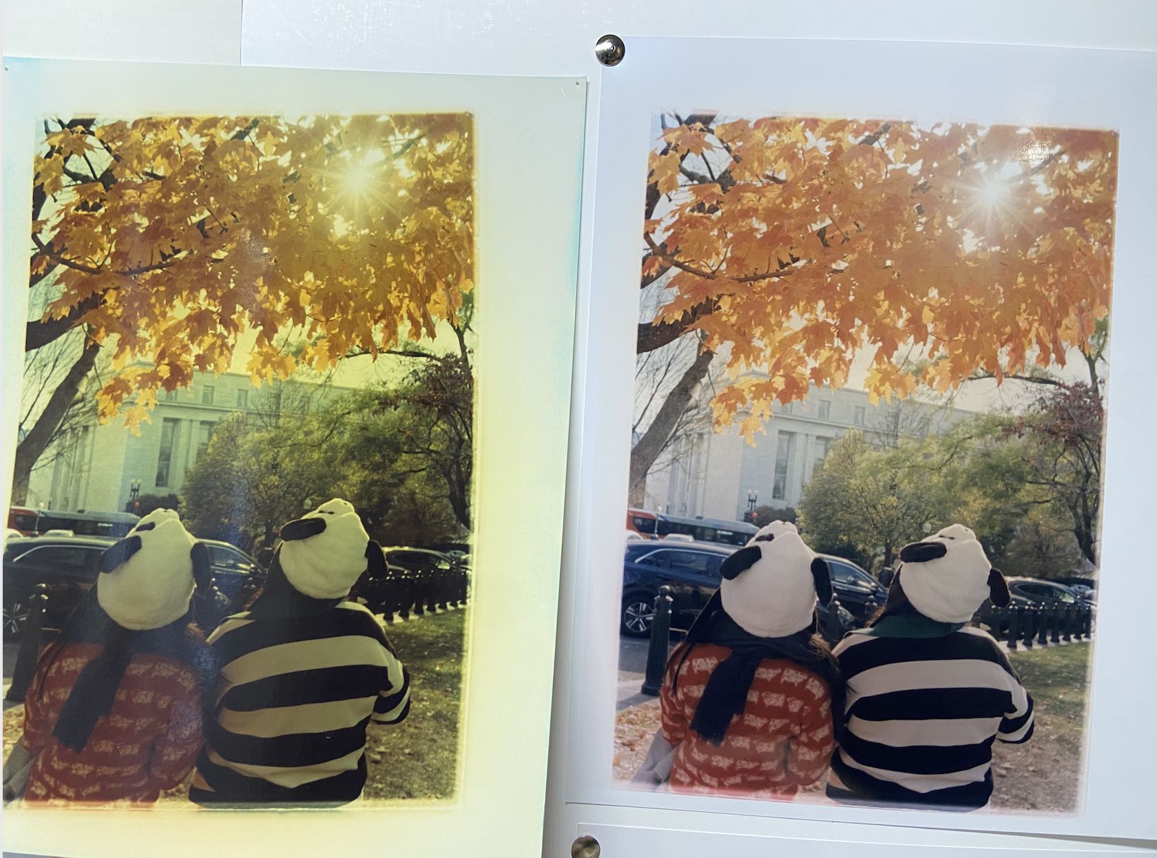

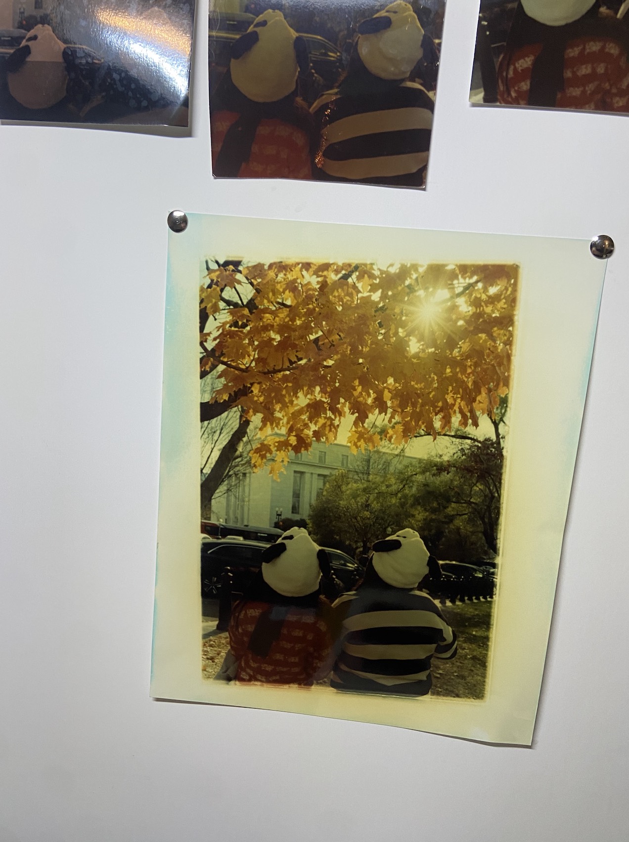

I've started making a few initial prints with the Arista kit.
Wondering as to why the white paper is coming out yellow on the edges that aren't part of the picture? (I think the whole picture is incorrectly toned with this sort of yellow).
Also there are blue smudges all over the edges of the paper. Are these light leaks of some sort?
I'm developing using 60mL of one-shot in a Jobo 2830.
(The recommended mL on this tank says 100 but since I'm just doing 8x10 I figured I may be ok to get away with 60 mL?)
I'm at 75 degrees and using the recommended arista times of:
30s Pre-Wash
3m 40s Developer
1m 30s Blix
2m Wash
First I would use 100mL or more. If you want to save chemistry save 50mL from the first 100mL run and use 50mL fresh and 50mL used for each consecutive print.
The blue could be as simple as not using enough water in presoak (the presoak water will be blue. I would not skimp on presoak water, give a couple 30-40 second presoaks.
Developer and Blix times are usually the same? Since you are using a drum I would try this at 95-100F
Brown could be light leak or reflection fogging the paper. I've seen slight tan from chemical fog from over active Developer (I forgot to add starter to Kodak Ektacolor dev), this can happen from high agitation like what's going on with your Jobo.
30s Pre-Wash
3m 40s Developer
1m 30s Blix
2m Wash
If you're using a drum you must use AT LEAST the amount stated on the drum, I often used 500ml.
The blue is usually due to blix contamination of the developer.
It will not be the blue (actually cyan) dye of the paper unless the paper has remained absolutely dry in those places, and that's definitely not the case here as the edges to the blue spots would be different. The cyan anti-halation dye will wash out very easily in any bath (water, dev, fix etc.) so in a drum processing situation, it's virtually impossible for any of this dye to come out on the paper at the end.
@ac123 if you're using drums, a concern is the lid of the drum that has the light trap in it. This can be difficult to clean between development sessions. A few remaining drops of blix can ruin the next developing round. This is one reason I personally don't like drums for RA4. Blix contamination of the developer results in a cyan cast and usually cyan streaky patterns. The defect shown on the long edges of your print almost certainly due to blix contamination.
Print drums work with far smaller volumes generally since you use them on a rotary base. 50-100ml is fairly typical for an 8x10 print drum. I do agree to er on the side of safety, but there's no utility in going overboard. In fact, the Jobo paper drums have a kind of buffer 'cup' inside the lid that holds the chemistry while the drum is still vertical. This ensures that the chemistry all enters the drum at more or less the same time as the drum is tilted on its side, which helps prevent uneven development. Filling a drum with such a cup with more chemistry than the cup will hold, does away with this advantage. I don't recommend it.
3m 40s Developer
That's very, very long. My RA4 developing time even at room temperature is 90 to 120 seconds. 120 seconds always does the job. A little overdevelopment doesn't hurt, but I don't know if overdeveloping by 100% is such a good idea.
Old Fuji paper fogs to yellow and then tan when it's (long) expired. The yellow sets in after a year or two but will be very, very faint. It then gets progressively worse.
However, in this case, I expect the yellow fog is actually due to lack of proper masking of the paper on an easel combined with stray light. Use a regular easel/frame with masking blades and the problem likely goes away. It will not fix the cyan borders, though.
Another possibility is a blue indicator LED on some piece of equipment.
Keep in mind that RA4 paper is extremely sensitive to blue light, less so to green light, and even less so to red light. So anything that emits blue light will be a massive problem, even if it's only a tiny bit of light.
So my suggestions are, in summary:
* Revise darkroom conditions and exclude any source of light. It should be absolutely pitch dark, and no light should be visible even after accommodating your eyes to the dark for 5-10 minutes.
* Obtain a proper printing easel and ensure the negative is properly masked in the negative holder. If using an enlarger for larger formats than 35mm, set it up for 35mm and not some larger format; this means adjusting any masking blades to cut out stray light etc. Ensure that the enlarger doesn't leak any light from the lamp house etc. Put tape or a dark cloth over any seams etc. that bleed light.
* Revise your use of processing drums and either (temporarily) switch to trays to get the basics down, or figure out how to use your drums in such a way that there's no blix being carried over from one run to the next. This is of course possible since many people use drums to good effect, but you may have to quite thoroughly rinse your drum between development runs. It takes time, but as you can see, it's necessary.
Thanks! That's initially what I thought too based on the information I've seen around but the instructions for the Arista kit chemicals say:

Regardless I went ahead and tried a print at 85 F with the suggested 1m 40s Developer / 1m Blix.
I added a rinse in between the developer / blix since some of the yellow maybe may could been caused by developer contaminating the blix.
I was thinking there was no way a blue light could be visible inside my darkroom, then while putting on my over ear headphones I noticed a small blue light on the bottom that flashes every 5 secs :smile: may also have been a cause.
Coming out much more color accurate now with one-shot 60mL
Though can't tell if the contrast is feeling low or if it's just the print "look" compared to how I'm used to seeing it scanned.
Wondering for this Jobo drum that has the light trap, am I required to shake the chemical around after pouring it in? Or is simply turning the drum horizontal enough to let all the liquid leak out of the trap? For these prints, I have been pouring the chemical in, then sloshing it back and forth a few times before placing it on the Jobo Agitator, which I have set to speed 2 (rotates left, then right, alternating back and forth).
Don't do any sloshing. The cup is designed to hold the solution until you turn the tank on it's side. The rinse between developer and blix isn't technically required but I actually use a stop bath between developer and blix. Very small amounts of blix can mess up the developer, not so much a little developer in the blix.
The second print looks much better. I suspect that your biggest issue was light fogging. Enjoy! 😃
I ALWAYS use a mild 1% acetic acid stop bath between DEV and BLIX, as well as an optional brief but ample water rinse after the stop bath itself. Why? Sometimes a bit of residual developer remains in the drum somewhere, like on the endwall, or somewhere in the lid. Laugh if you must, but it can be an actual problem when using drums; and my system has efficient 3-way motion, no just rotary.
The blue margins indicate insufficient chemistry volume; the yellow-brown effect, exhausted developer. I like to mix up only enough chemistry at a time sufficient for a single day's work session. But overall yellowing, including margins can also be due to outdated paper.
Then there's the possibility of light fogging too; never assume any noticeable light is safe, even luminous timer hands, unless you've specifically tested first. Darkrooms mean just that : dark. For example, many heavy-duty extension cords have an end socket which glows when the power it on; those have to be covered with black electrical tape.
