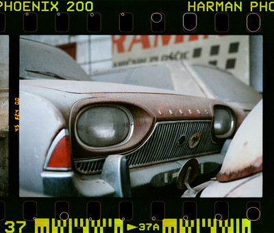

Thanks for posting that, what camera are you using?( the exposure info between frames is nice)

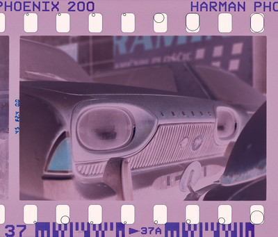

I wish the barcode on the bottom was: black/white/gray/yellow/red+blue
Like a color test strip repeating for the whole roll.
(all three scanned and processed exactly the same, individual frames could use additional small tweaks...)

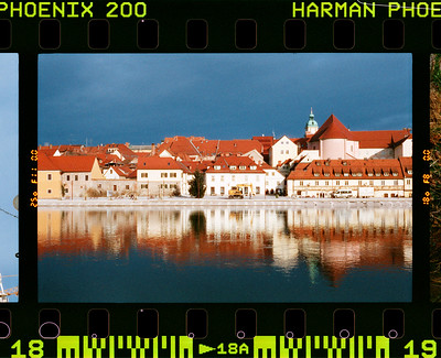

These are superb. Thanks @brbo. Stunning.
Harman should post them straight on the official Phoenix website to show off what the film can do in the right hands!

Definitely the best Phoenix images I've seen. Fantastic stuff.
Shows what Phoenix can do in good hands, under ideal circumstances. If Harman can improve it such that those kind of results are more consistently achieved, they'll be onto a surefire winner. I don't even mind the grain much.

I posted some examples earlier. The film is difficult to print and the outcome is very "Lomo". Scans that look perfectly natural come out very "creative" in print. Extreme contrast, lots of grain, funky colors. Everything you'd expect based on the curves and visual inspection of the negatives.
The prints are certainly.....interesting. I like some of them for sure. But could one produce prints that have similar colour rendition to the scans with sufficient tweaking?
I'm reading out there in Facebook land that some people have been unable to get any decent scans from Phoenix, which certainly would be the case if scenes were bright and contrasty to begin with.

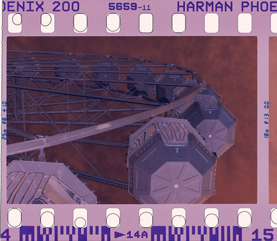

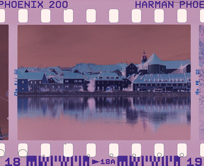

My negatives with lots of light blue sky look fine to my eye, but the lab scanner and my Epson say "nope". The lab scans can be more or less brought into some sort of sensible image. It has been suggested that I scan C,M and Y channels individually and combine in Photoshop....whether I shall have time for this is uncertain.
Realistically, no. It'll take a massive effort to produce something close and frankly it would make much more sense to shoot a normal color negative film instead if brutal results are desired. There's just no point in even trying, IMO. It's a bit like buying a hacksaw and figuring out of to neatly clip your nails with it. Surely, it could be done...
I didn't find this film difficult to scan, especially on the flatbed. In fact, I didn't even really notice just how 'our there' it was initially. I may do some more high contrast scenes one day, but I don't expect any difficulties. I scan as positive (color slide) and then do the inversion and curve adjustements manually.
