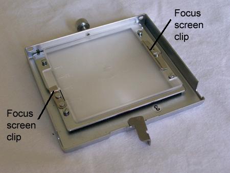

This rot happened to my C-33 but I didn't know the C-330's were susceptible to it.
Definitely. I own two C330 cameras and about three or four focusing screens and ALL of them had that issue. Sometimes the foam goes away so much that you think there isn't supposed to be any foam there.
This pic illustrates well:
attachment.php
There is a gap between the "platform" that supports the focus screen and the base of the focusing screen. This gap is where the foam should be, so the "platform" has a "springy" effect when pushed. No gap = rotten foam. No "springy effect" = rotten foam.
It's just four tiny screws, there are no washers to loose. Not so difficult.
attachment.php

I did have a look at my mamiya and there is indeed foam between the frame and the subframe hodlding the focusing screen in place. When the foam rottens nothing happens as the correct distance between the two frames is maintained by the four screws seen in the picture provided by flavio..
This is not correct.
The problem is not the distance between the two frames. That distance, per se, does not matter at all since it does not have any effect on focusing.
The problem is that the ground glass (aka "focus screen") needs to make perfect, flat, and consistent contact with the three focusing screen posts, which you can see in this pic ("locating lugs"):
attachment.php
Gravity alone isn't enough, it needs some pressure, and the foam provides it.
I'm not writing anything new, this problem is well known in the internet, for example in this thread in other forum, from which I took away the pictures. This thread contains step-by-step images and it's very good:
http://photo.net/medium-format-photography-forum/00N8kt?start=0
Again, you need thick, pliable foam. The springier and taller, the better.
If this service is not done to your Mamiya, it will not be able to fully realize the potential of the MAMIYA-SEKOR lenses, some of which (like the 180/4.5) are just superb, and a focal length Rolleiflex owners can't enjoy.
This has to be very precise. I went to the trouble to calculate how far mine was off. Not knowing about the Mamiya-recommended procedure, I put pieces of tape at carefully measured distances on a brick wall and shot at a 45 degrees, using all 4 lenses from 3 different distances (12 shots), focusing on the same point every time. With the 180mm lens at 15 feet, it was so far off that the actual in-focus area was outside the field of view and did not appear on the film. After doing the math, every photo agreed that the distance from the lens to the focus screen was 1mm less than the distance to the film plane.

It is correct, gravity alone is enough to keep the right distance between the two frames, foam in between is of course better. The three poles undernath are just stopping the inner (smaller) frame at the correct distance when in contact.
I seriously disagree. I had focus problems with the 180mm that were solved after replacing the foam. Check out the forum thread i cited above, i'm not alone in claiming the foam is necessary for corrext focus.
