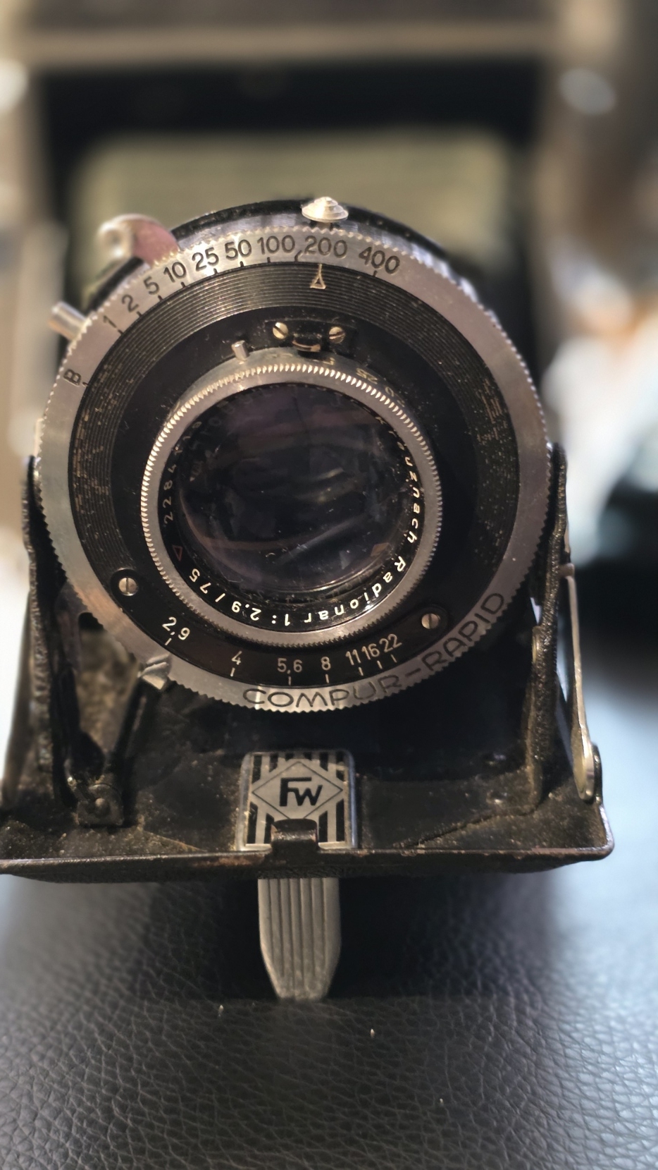

I am looking out for an MPP Microflex but as part of an auction lot just got a Franka Solida III which has an F/2.9 75mm lens (not the 80mm version).
Definitely going to run a film through it and see what I get.
blee1996
Jul 25, 2008
1,507
SF Bay Area, California
Frank Solida III is a solid camera. :smile: I guess you got the 75mm f2.9 Radionar lens. Wide open it is a bit dreamy, while stopped down to f/8 or f/11 is tacking sharp. Hopefully your uncoupled rangefinder still works well and matches the lens.
