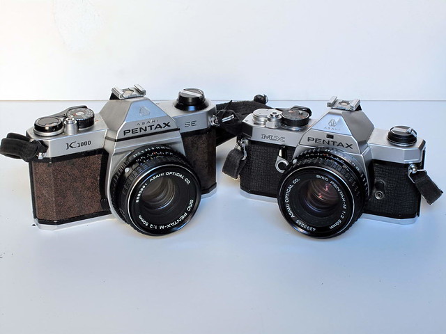

My first "old school" SLR purchase came via local CL in some plastic grocery bags for not much more than a couple of them fancy coffees. During the exchange, I didn't even bother checking them out as I was confident the hefty weight was well worth the price.
Bagful of Pentax 1 by Les DMess, on Flickr
It was only after I got home and a little dusting off that I checked out my haul and even then I didn't really know what I was getting until later.
Bagful of Pentax 2 by Les DMess, on Flickr
Bagful of Pentax 3 by Les DMess, on Flickr
I was pleasantly surprised by the viewfinder of the Pentax MX which I later found out is the biggest of all SLRs ever made. After extensive testing, that used super cheap Pentax M 50mm f4 macro will provide detail that even my 4000dpi Coolscan cannot resolve. In fact, all the primes I later acquired are exceptional in this regard except for a mirror lens.

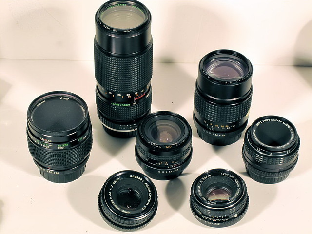

Maybe your fast lens can be adopted to one of these glorious bodies . . . šŸ˜‰
Fast glass by Les DMess, on Flickr
Anyway, your first purchase may not be your last . . .
