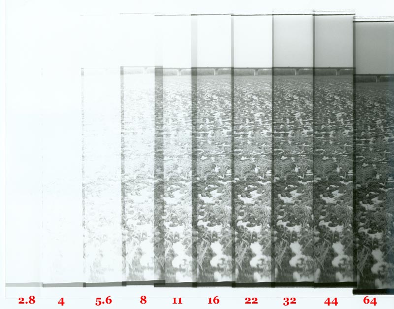

I use an easel I built with a 1" opening...behind which I move the paper, per a guide I have marked. I do a sequence of exposures as follows:
64
44
32
22
16
11
8
5.6
4
2.8
If I need a 1/4 stop that falls between these, I consult my chart. This test strip is for my base, grade 00 exposure, soft. When I've chosen the soft exposure, I replace the test strip easel with the regular easel and expose a sheet for the soft exposure and then switch to the #5 hard filter and give the full sheet a 4 second exposure, then using a card I expose sheet next for 1.6 seconds...move the card...expose for 2.4 seconds, etc...so the soft base plus hard test has a sequence of hard filter exposures of:

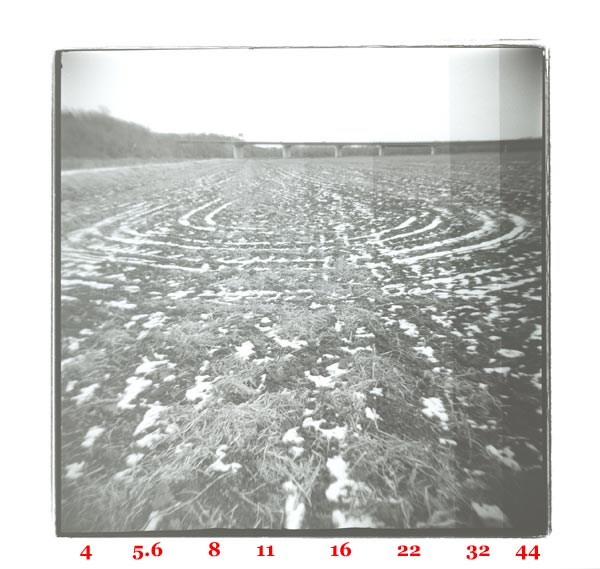

Here's a sequence...the initial 00, soft test strip, the hard test strip (5 on top of base 00 exposure) and the print. The scans aren't great but you can see what the process is about.
