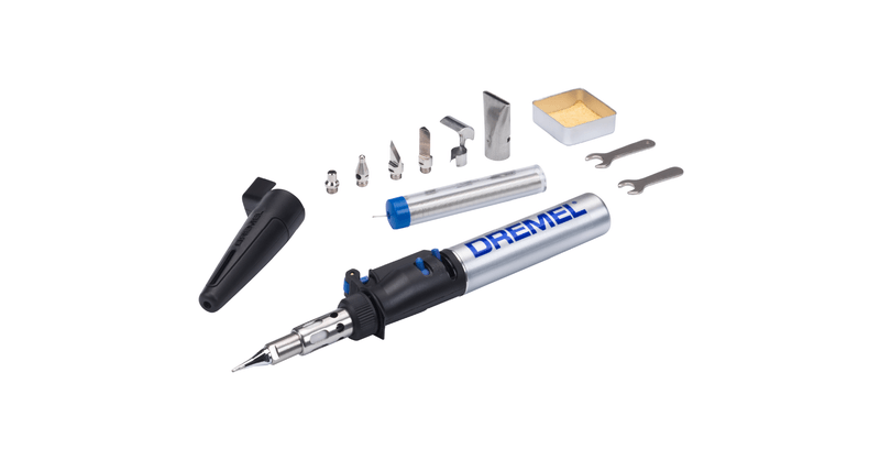

Of course, you can desolder SMD components with a butane torch, shown here with the Dremel Versatip with hot air attachment.
As with the desoldering station, you control the heat with a regulator; with the Versatip, you also control the distance from the component. It works perfectly.
You can measure the temperature of the component with a thermometer. Maintain a constant control position at a constant distance.

The Versatip—and other butan gas torches—comes with a set of attachments, making it extremely useful. For cutting and shaping plastic, drying, and even a soldering tip.
I've enjoyed working with the hot air attachment for years.
It's very versatile.

It clearly has a hot air attachment, you're being disingenuous and antagonistic. Butane powered hot air guns are a common tool in electronics work as they're small, portable, heat up quickly, and don't run flat in storage. I still use a Weller Pyropen attachment on occasion since, more than anything, it's alot quieter than my soldering station. Precise temperature control is only really needed for delicate ICs you might want to reuse. Going full blast on a known faulty component (or ones easy enough to replace) can minimize thermal damage to surrounding stuff.
Unconventional tools and idiosyncratic habits are pretty common in electronics - pretty common in any field where people do things more than theorize. I've seen and met alot of guys who sit surrounded by over £10,000 worth of test equipment but still prefer stripping wires ends with a pair of scissors and shrinking heat shrink tubing with a disposable lighter. The scissor thing works quite well actually, you pinch the wire against scissor blade with your thumb and pull it.
As for solvent safety, electric hot air guns easily get hot enough inside to ignite vapours. But I think if you're living in an environment with strong enough flammable vapours in the air to ignite like that then you'd probably have other problems. For flammable solvents i'd say decant them into smaller trays and containers, keep the working amounts minimal, and keep the main resevour far enough away that any potential flames can't jump over. Then watch out about storing too many used solvent soaked rags/ tissues/ swabs together or strewnn about cuz that can sometimes lead to funny stuff.
The Dremel Versatip or other similar butane torches are handy, versatile, and quickly ready-to-use heat sources.

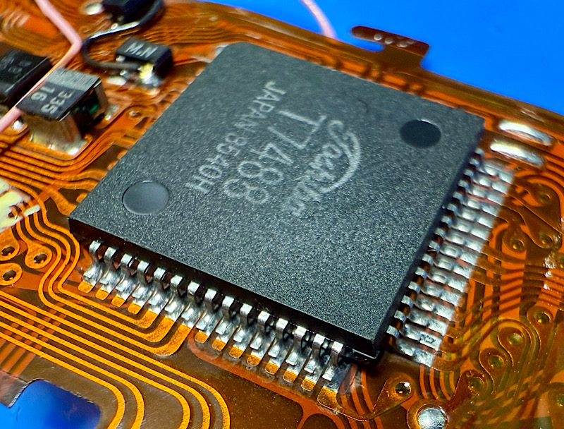

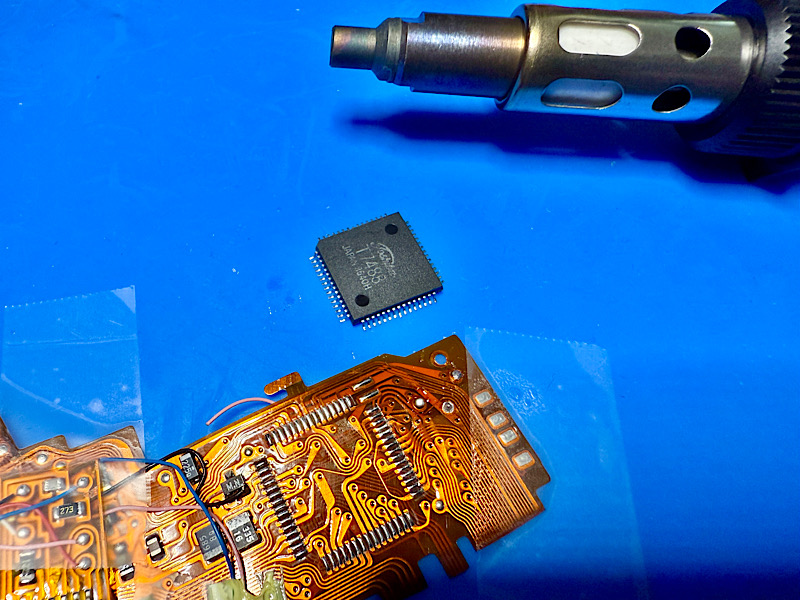

Desoldering/resoldering IC3 (main CPU) of a Canon T90 with the Dremel Versatip butane gas burner
To practice desoldering and soldering for future replacement, I handed over IC3 from the removed circuit board of a Canon T90 to my Dremel Versatip butane gas burner with hot air nozzle.
Desoldering
Resoldering
Both worked without problems.
Anyway I should have secured the IC (60 pins) better when soldering; the pins were slightly misaligned.
But the connections are good.
I measured the continuity of the connections on both sides where possible with a multimeter.
Everything was fine.
Whether the hot air temperature was acceptable to avoid damaging the IC can only be determined by testing it on a live camera. It should have been around 400 degrees Celsius (752 F), as I determined from previous measurements. That should be fine.
However, the nozzle on the Versatip was too wide for this purpose, and so the adjacent quartz crystal for the clock came off with it.
But for individual, freestanding SMD components, this is a good, quick, and inexpensive solution.
