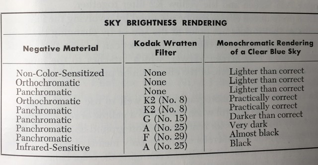

macfred that’s nice but doesn’t have the old terms K K2 etc... let me see if I have anything from Kodak or other

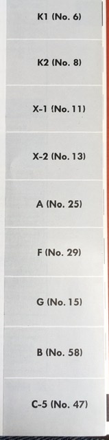

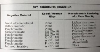

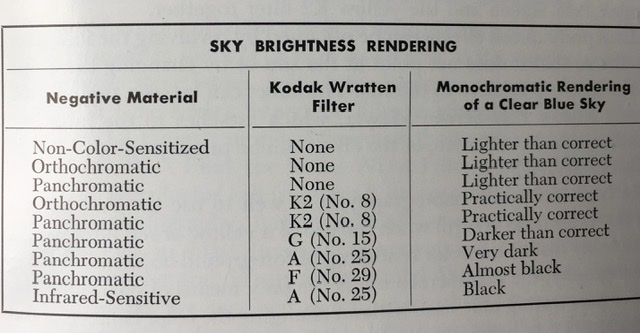

37A87ECA-0E7E-47E9-8858-C5D81BC6C73E.jpeg Here’s some practical info on a few of the filters

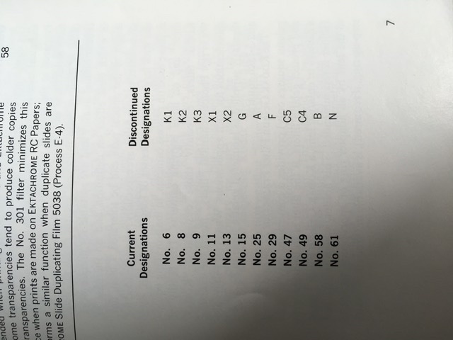

01E56240-CDDA-467B-A97D-0742C92C4072.jpeg Wikipedia has 11 mislabeled it is X1 in two of my Kodak sources including publication B-3 and they show X0 on Wikipedia. The Wikipedia article has a blank in number 13 which is X2... if nobody else fixes this I will sign in and make the corrections

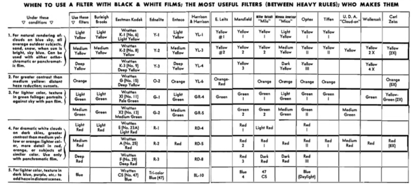

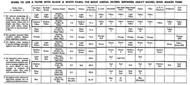

Just now I came across this interesting list of how different manufacturers named their black and white filters: http://www.dofmaster.com/bw_filters.html Depending on the company, it seems that the equivalent of a Wratten X1 may be called any of the following: Green, Light Green, G, G-1, Green 1, GR-4... Ay yi yi...
View attachment 246030 Wikipedia has 11 mislabeled it is X1 in two of my Kodak sources including publication B-3 and they show X0 on Wikipedia. The Wikipedia article has a blank in number 13 which is X2... if nobody else fixes this I will sign in and make the corrections
That's a helpful list of discontinued designations. What book is that page from?
For anyone who might have this same question in the future, I thought I would share this (IMHO) extremely helpful listing of older manufacturers' filter designations. I'm not sure where it's taken from as I found it posted without attribution.
For the record, depending on the manufacturer, G-1 = 11 = Green = Green 1 = Pale Green = Light Green = Yellow-Green. And just to stand out from the crowd, the folks at Harrison & Harrison called it a GR-4. No wonder I've been so confused!
