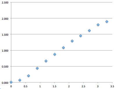

I'm surprised it worked so well myself. I also can't believe the meter on my FA handles 1/3 stops so repeatably. I just cranked the ISO knob and left it set on P with matrix metering for the whole test.
The photoresistor is linear over the range of the stops on my enlarger lens. As the light gets dimmer the slope of the curve changes, but is still linear locally. I think the higher densities are reading a little denser than they should.
I think I can work my way up to those densities by using intermediate standards to re-zero on.
Next step is to shoot a roll with a full range of densities from 0 to X and see how they contact print on my paper.
Not bad for seventy cents.
J.

I'm putting the negative in the enlarger set up to make an 8x10 enlargement from 35mm, so the area measured is quite small.
I looked at my data again, and I should be getting linear measurements from an absolute density of 0 (no neg, f/2.8) up to 1.50 (no neg, f/16). My zone VIII negative measures between 1.33 and 1.54 (including FB+fog) depending on the test, so the numbers may be real even though they look odd. There may be some other artifact that changes the curve for higher densities in my setup (Callier effect?).
I need to graph the full range of densities to see what that looks like.
This is a great project for right now since it's tough to get out and shoot this week.
-J.

You are getting good densities... My lower-right dot at 0.60 x-axis should be at 0.20 x-axis... It's a good curve.

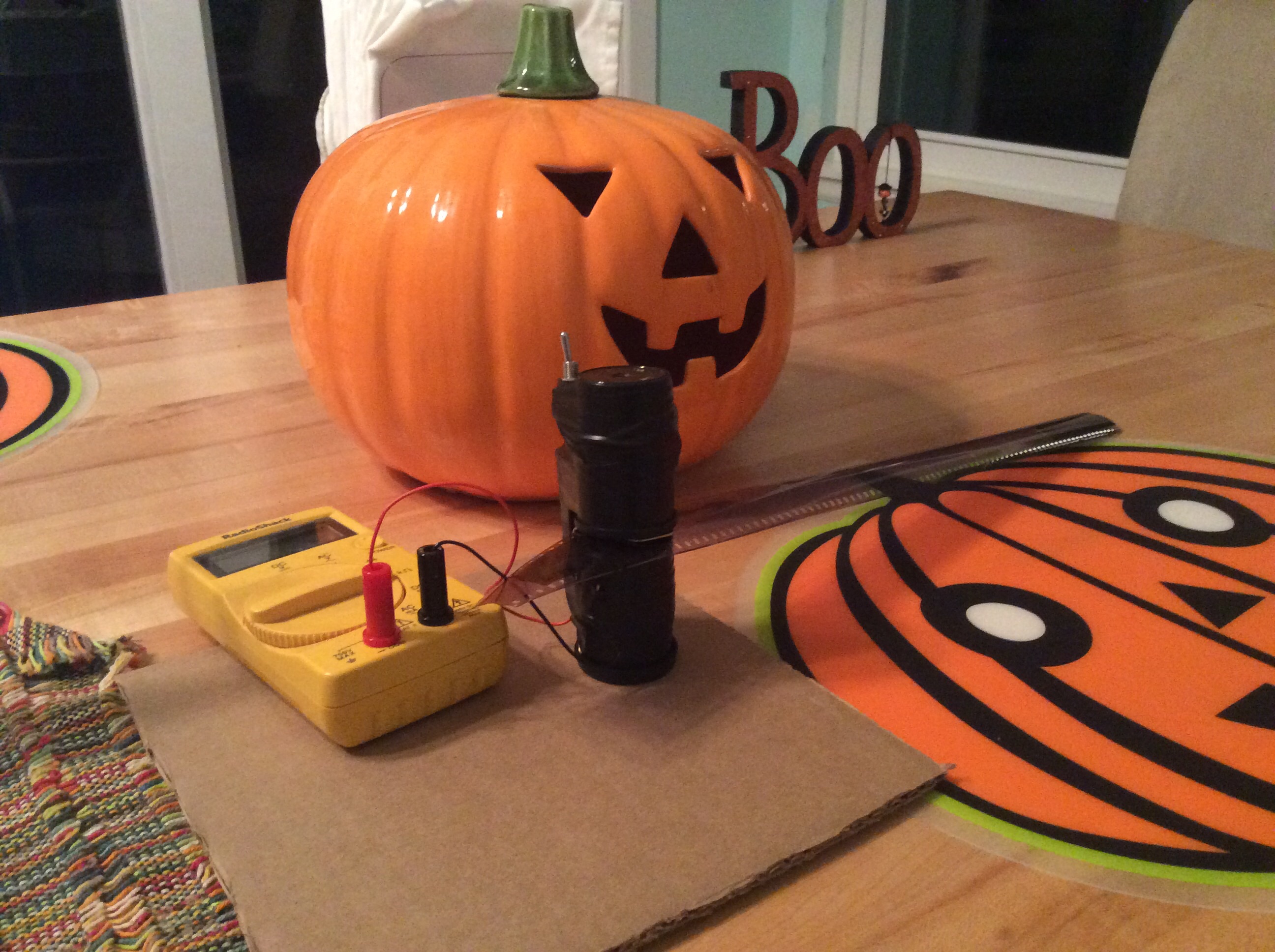

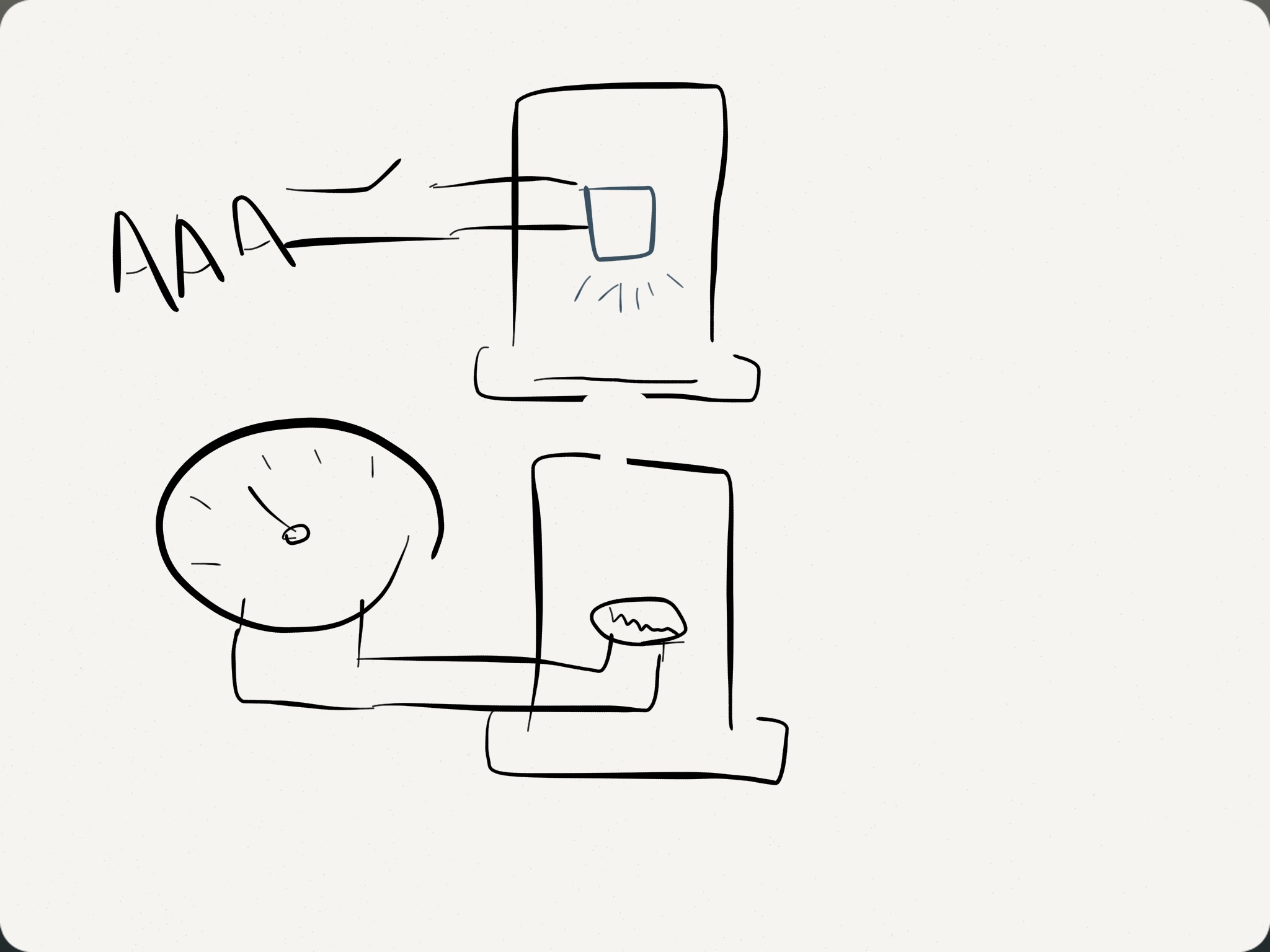

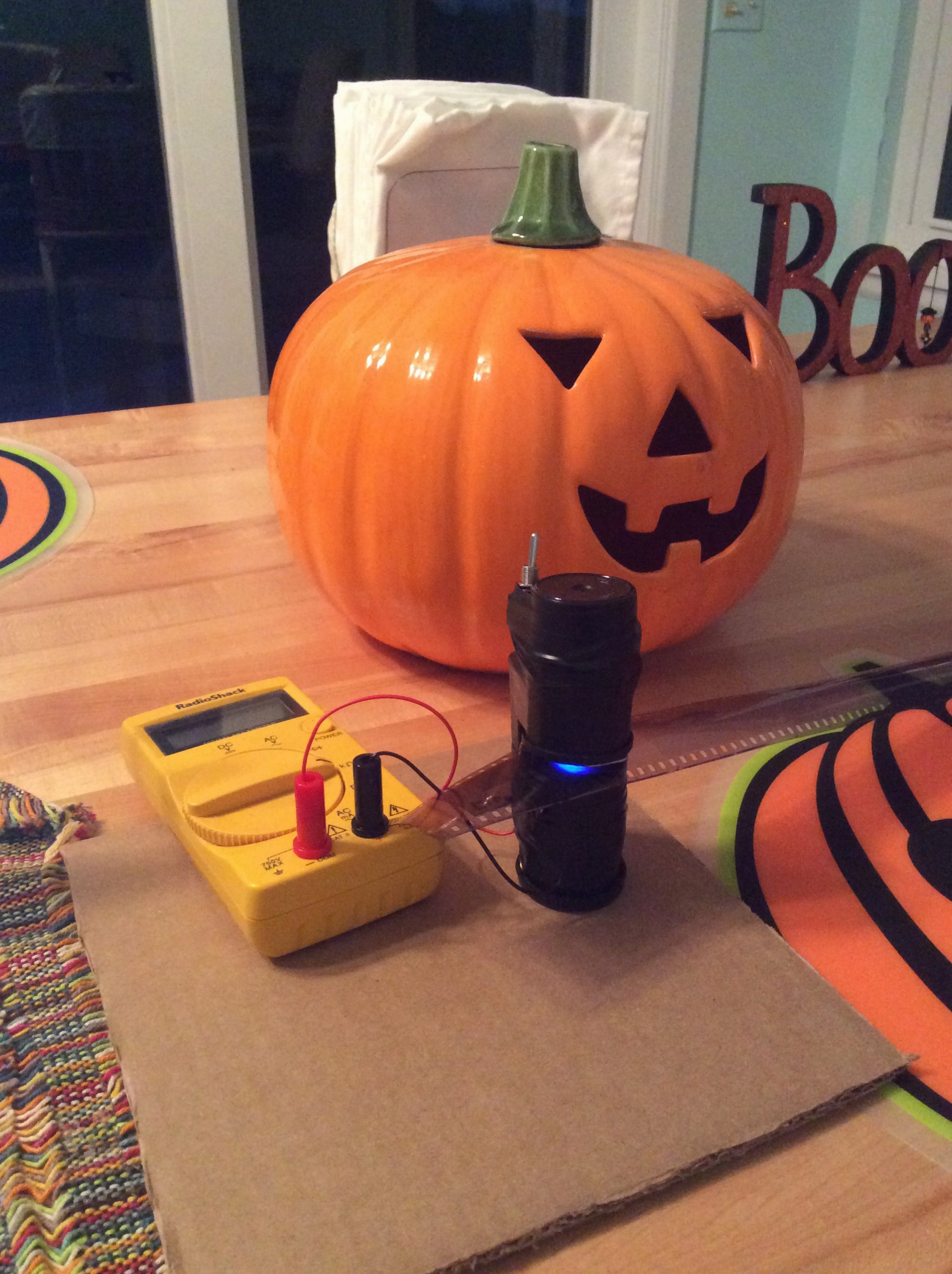

I built another one. This one cost more ($10) and took longer to make (30 min).
The top is a blue led in a film can with a hole and parchment paper diffuser on the bottom. The bottom has a hole and a photoresistor at the bottom. Led runs off two AAA batteries.
The battery holder acts as a spacer between the two. With the power off, the potoresistor sees no light (open circuit).
I need to add a little clip to hold the film flat and still. When it pushes on the top unit the numbers change.
I gotta calibrate it.
J.

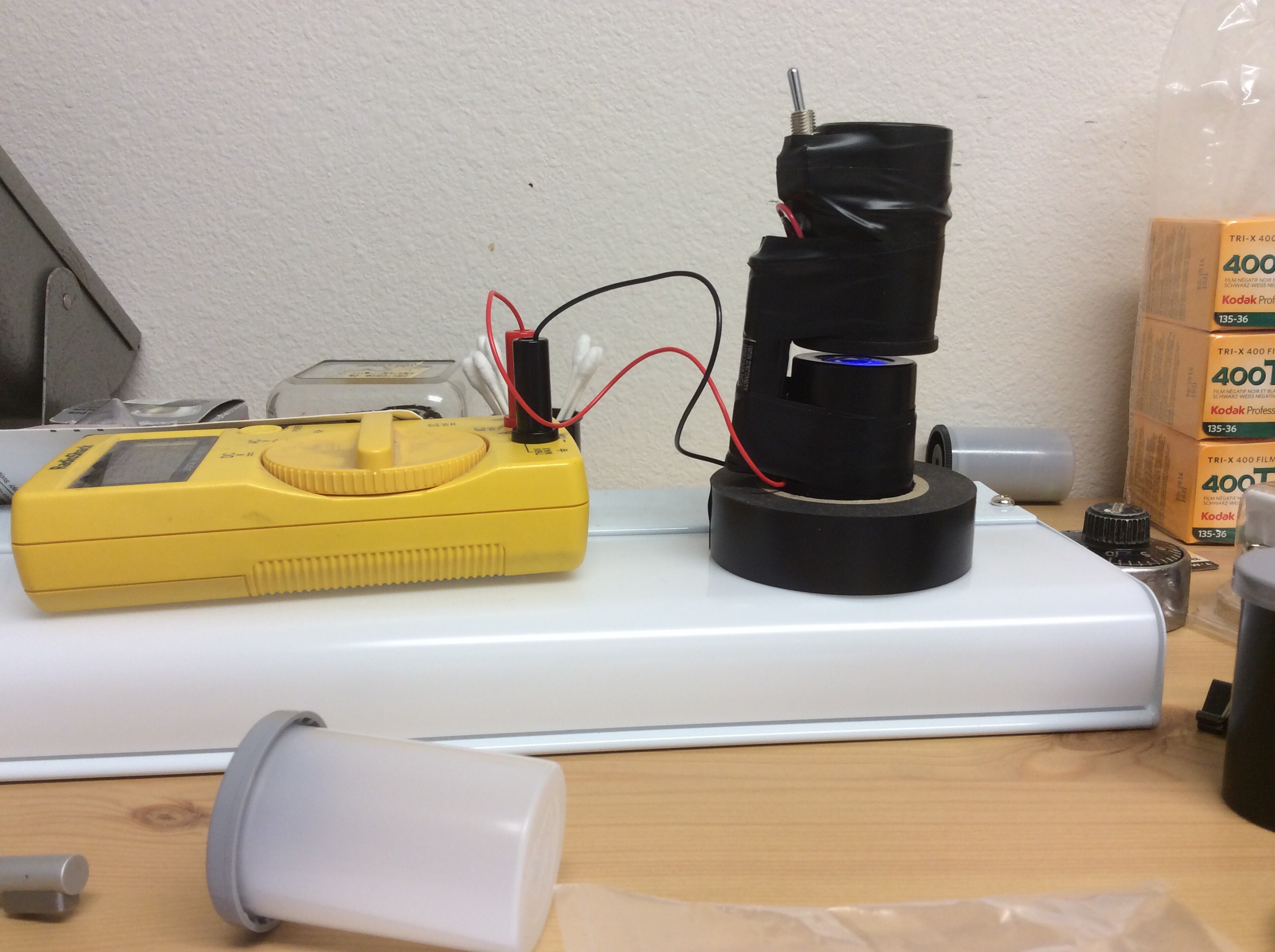

JRoosa
Jul 31, 2014
112
Colorado, US
This photo gives you a better idea of the setup.
J.

I almost started a fire.
I forgot leds have no resistance. I hooked it right up to two aaa batteries in series. The internal resistance keeps the current to 15mA.
I almost used a lithium battery that would have not have liked being short circuited.
I need to rewire it with a resistor.
Be careful!
J.
albada
Apr 10, 2008
2,177
Escondido, C
The LED will dim as the batteries run down. You need constant voltage, so I suggest powering the LED with a power-supply. A charger for an old broken cell-phone or any other gadget should work.

JRoosa
Jul 31, 2014
112
Colorado, US
Sounds like that might be part of version 3. When the batteries die, I need to cut it apart anyway.
