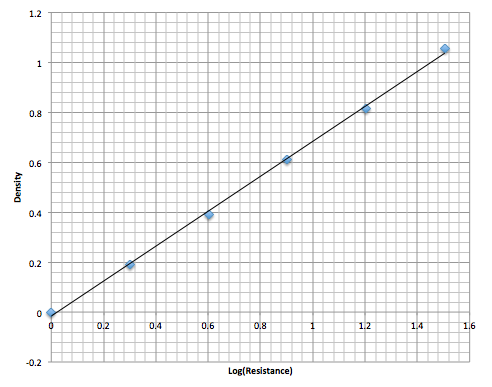

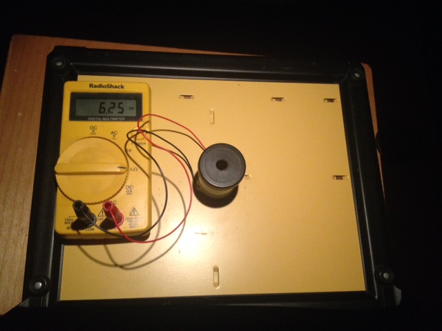

Basically I set up the resistor in the bottom of a 35mm film can, drilled a hole in the top to keep stray light out, and I set it on my enlarger base looking up at the lens.
I have a linear function when I go down through the F stops. Basically I take the log of the resistance off the meter and graph it against the density. Density is the log of the opacity, and opacity is (f/2.8=1, f/4=2, F/5.6=4 etc.). I zero the log of the resistance to what I get with f/2.8.
Here's the graph thanks to Xcell. I need to figure out how it calculates the trend line and then I can convert Log(resistance) to density when I put in my negative. I can't believe it's working.
The main source of error would be if my enlarger lens isn't truly dropping the light by 1/2 for each stop, but this might be more than close enough for what I need. I would buy a calibrated step wedge, but since I'm $4.70 in and it's up and running, I might just send you some negatives at some point to verify my numbers.
-J.

Found it, you just click "display equation on chart." Dang, I love computers sometimes.
y = 0.6997x - 0.0158
-J.

Well now that's cool. Nice job!

Nice project, thanks for sharing. The multimeter is a great idea. The logic all looks good and I'll bet your error on the low end is very small and the error on the high end is less than 1/3 stop. If you zero your film base to the same ohm reading you have a repeatable system. This thread should probably be a 'sticky'
Reminds me of a darkroom exposure meter I made from RadioShack parts back in 1974 using a CDS cell and 9v battery. I calibrated the meter needle scale the same, way you did; using f-stops on the enlarger lens. However, without the digital multimeter it was a much cruder device than what you have described.
The box below the meter is a 555-based timer from a Popular Electronics article.
