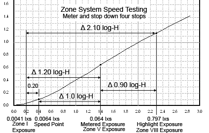

Stephen, when you write that Zone System speed point falls 2/3 stops below the ISO speedpoint, do you mean it is below 0.1 fb+f?
No, it's about the misinterpretation of the ratio between the speed point and the metered exposure point caused by combining a flare interpretation with effectively a no flare testing situation. While the shadow exposure for an average scene does fall around 4 stops down from the metered exposure point (4 1/3 to be exact), the speed point doesn't. If you stop down four stops below the metered exposure point, the exposure will fall 2/3 of a stop below 0.10. In order to bring it up to 0.10, the exposure needs to be increased by 2/3 of a stop which accounts for the lower EIs encountered in Zone System testing. I did a thread on the ratio sometime ago.

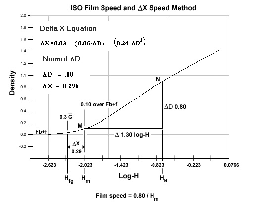

An interesting point about the speed point is that it's not necessarily where you want a specific exposure to fall - the shadows for B&W negative material and the metered exposure point for color reversal film for example. The purpose is to have a point that has meaningful information about the material. One of the functions of in the determination of the speed point is that it defines the limits of the material being tested. When the B&W ISO parameters are met, the minimum useful exposure that will produce a high quality print falls approximately one stop to the left of the speed point density of 0.10. If the processing is different, greater or less, then the relationship of the minimum useful exposure point and the 0.10 density point changes. In contrast conditions outside the ISO parameters, a different method should be applied such as the Delta-X Criterion.
Film speed is then determined using the speed point, but as I said, exposure doesn't necessarily fall at that point. The ISO film speed is just a different approach to determining the fractional gradient speed point. It is basically the Delta-X Criterion. As we know, the fractional gradient speed point falls around a stop lower than the 0.10 density point, yet when this was the standard, film speeds were one stop slower than film speeds produced using the current standard. This sounds contradictory to our understanding on how speed works. Shouldn't film speeds increase the further left the speed point falls? One of the points missed in almost all general purpose photography books is that the speed point is only part of the determination of film speed. There is also the speed constant.
Film speed is part of the exposure equation used in exposure meters. This is why the ratio between the speed point and metered exposure point is so important. For black and white the speed the constant is 0.80 and for color reversal it's 10. This means that there is 1/3 stop difference between the color reversal speed point and the metered exposure point for a given film speed. With black and white film it's a 3 1/3 stop difference. The speed constant for color reversal films used to be 8. Without changing the speed point, the change in the speed constant caused a 1/3 stop increase in the film speed. Changing the constant instead of the speed point preserves all the important information about the material that the speed point is associate with.
This can be done with the black and white speed constant too. WBM uses a density of 0.17 as the speed point. With normal development, this produces approximately a 2/3 of a stop decrease in film speed compared to the 0.10 speed point, depending on the shape of the film curve. There's nothing wrong with wanting a little extra exposure as a safety factor or perhaps to achieve better results with your personal metering techniques. The problem with the 0.17 speed point is that it isn't in good agreement with the limits of the material. If you want the extra film speed, it's better to simply use the 0.10 with a speed constant of 0.50 instead of 0.80, or for those using relative film speed, adjust the EI by 1/2, 2/3, or whatever amount works best for you.

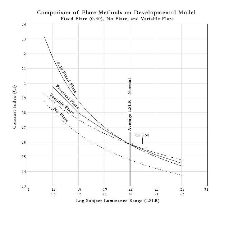

The equation to determine the CI for any luminance range is:
CI = NDR / (log subject luminance range - flare)
The luminance range of a scene is reduced at the film plane by flare. The range you are developing for is the one that actually strikes the film. With a one stop flare factor, a scene will a 7 stop luminance range effectively becomes a 6 stop range at the film plane. If you develop for a 7 stop range, you would be under developing. One of the ways the various methods that don't factor in flare use to still produce good CI values or accurate processing is to use higher negative density range values. The average log exposure range (which equates to the aim negative density range) for a grade two paper printed with a diffusion enlarger is 1.05. WBM uses a 1.20 and the Zone System uses a 1.25 range. This effectively compensates for the lack of a flare adjustment to the luminance range. And while this approach will produce a good negative, it doesn't correctly reflect the process.
One consideration to maintain when factoring in flare into the equation is that the degree of flare isn't a constant. Flare varies with different luminance ranges. It's virtually impossible to determine the exact flare value for any given scene but flare tends to change by 1/3 stop per stop change in the luminance range. If the value of flare is kept constant, the CI values for shorter luminances will be too high producing contrasty negative and with longer luminance ranges, a fixed flare value will produce CI values that are too low. The developmental model that best reflects the shooting conditions would use a variable flare model.
Another factor that needs to be considered is that there isn't a perfect relationship between the negative density range and the paper LER. Loyd Jones found that “for the soft papers, the density scales of the negative (NDR) should in most cases exceed the sensitometric exposure scale of the paper (LER), whereas, for the hard papers, the density scales of the negatives should in most cases be less than the sensitometric exposure scale of the paper (LER).” In other words, it’s not only acceptable, but preferable to have a slightly contrastier negative for contrasty scenes and a slightly flatter negative for flatter scenes.
This is why my developmental model averages the fixed flare method and the variable flare method. In the following graph, all the models are based on a 1.05 NDR. An increase in the aim NDR with the no flare curve will shift it upward to be even with the others. The similar shape of the no flare and practical flare model curves is why the WBM with its higher NDR and no flare approach and my practical flare model agree so closely.
In practice with the use of variable contrast papers, personal taste, the uncertainty of the flare, etc, how critical are these distinctions? In most situations, not very. There's always been a large range of acceptability in photography. Afterall, it's an art form that uses science. I just think it's important to understand how it really works.

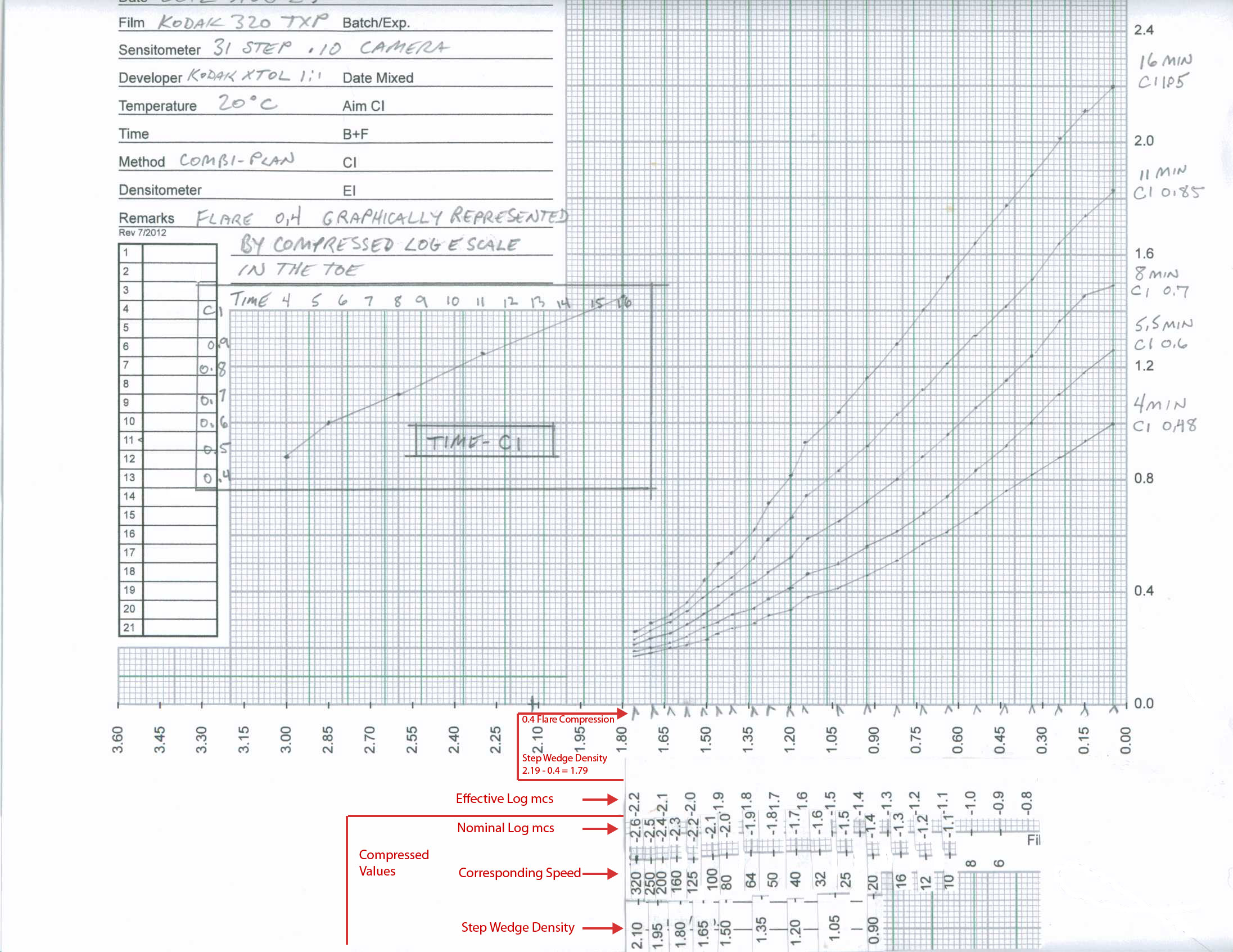

I am working on a revised graph of your data with a compressed LogE scale in the toe to counteract the effect of flare.
I think it's the necessary approach to graph a test that was shot with flare.
One interesting thing my new graph will do. I will end it abruptly at the speed point for 320. That's because effectively flare guaranteed there isn't any step wedge sample that received "less" light than that.

Rafal,
Here is my impression of what your film curves would look like if they did not include flare.
I compressed the Log E scale in the toe by taking what I thought was a reasonable speed point.
Using that as if it was equal to EI 320 which is by definition -2.6 Log mcs.
Add 0.4 Log E flare to that = -2.2 Log mcs.
The difference (arithmetic) is 0.0038 mcs.
I then built a compressed scale by adding 0.0038 mcs to each 0.1 log increment going from the speed point to the right until it stopped being significant.
Some example values:
-2.6 Log mcs + 0.0038 mcs => -2.2 Log mcs
-2.5 Log mcs + 0.0038 mcs => -2.15 Log mcs
-2.0 Log mcs + 0.0038 mcs => -1.86 Log mcs
-1.5 Log mcs + 0.0038 mcs => -1.45 Log mcs
-1.0 Log mcs + 0.0038 mcs => -0.98 Log mcs
By -1.0 Log mcs the difference caused by flare is 0.02 Log mcs which is insignificant to me.

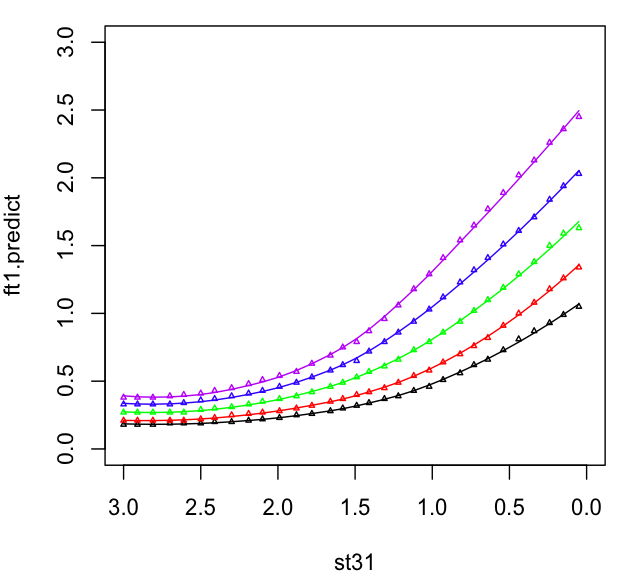

For what it's worth, as I am re-reading BTZS, I have just decided to plot my own curves (using R) from the flawed test data, which I enclosed in the first post on this thread. Thanks to your comments, especially Stephen's patient demystifying of the concepts, I feel more able to do it without having to ask Bill for his services. This is the resulting set of curves, I have smoothed them using LOESS before plotting, and I am glad to say this looks almost identical to Bill's hand-made plot:
Reading page 91 of BTZS, "Troubleshooting the Film Test" section, Figure 7-6d, shows a similar situation, where the curves' toes stack up on top of each other this way. Mr Davis helpfully comments: "You'll get curves like this if you test films in the camera (by photographing the step tablet on a light box, for example). These curves are not usable.". I suppose I know from you, gentlemen, that the key reason for the curve stacking is the flare. I wish I read BTZS before the test, but at least I have learned something useful my usual way: try and err.
I am looking forward to retesting, most likely using the flash exposure technique. I hope I get a repeatable exposures, but just in case, I will shoot 25, or so sheets, so I can average the readings from each of the five development batches. I need to do that, as I usually develop 5 at a time in my HP CombiPlan. I wonder, however, if I should agitate a little less than usual, perhaps down to 3–4 inversions only every 30s.
