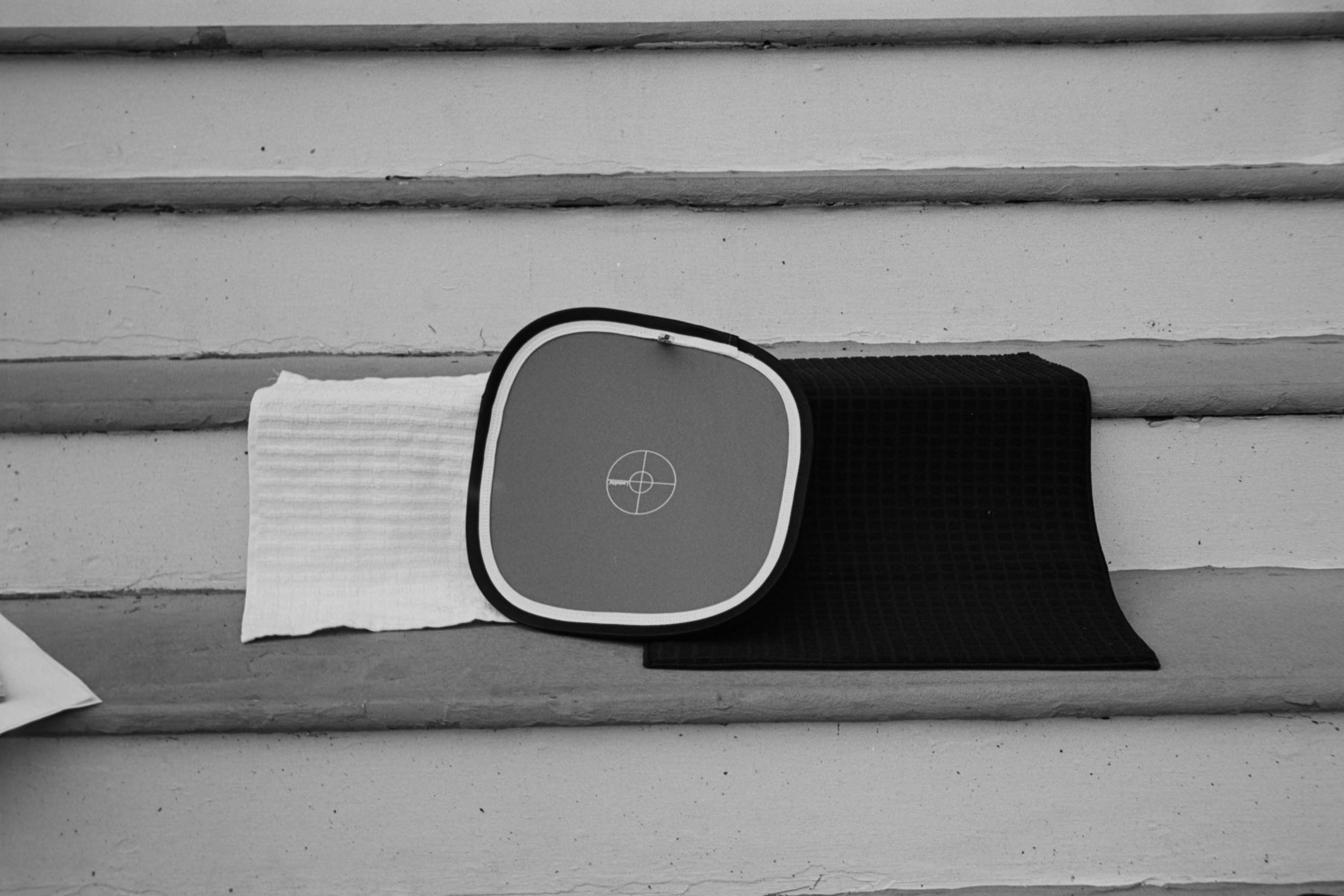

So here's what I did and have done, and a review of my work. The shots were imported into LR using the Negative Lab Pro app and NOT adjusted by me. Yes, there's probably something that gets adjusted outside my ability to neutralize it, but FWIW, all the settings I'm aware of were neutral / default in both LR and Negative Lab Pro. I used Negative Lab Pro but am aware some use Colorperfect and that this can also manage the job.
This was the test image on the front steps of our home last weekend before posting here. Didn't spend a whole lot of time getting finicky about it.... ergo the step alignment could have been more precise. Not really the point. Point was to set the frame of reference off the gray card, and take a series of shots as laid out in a number of books. I don't have a step wedge, nor do I have a denistometer. One day? Yes, I'll spend the $40 for the step wedge. Took the reference shot at gray card values to establish the aperture and shutter speed, then 1 with the lens cap on. Then a series with -3 stops, -1 stop, NEUTRAL, +1 stop and + 3 stops. I was surprised how much detail there was in all of them. Film is FP4+ and this shot at neutral metered with a Sekonic Spot meter on the target. Initial had some trouble with clouds moving around, but dealt with it. Look closely and you'll see texture in both the white and black. Scanning initially with Aperture Priority didn't give much information as the shutter speed adjusted and all shots looked great. Reset the camera to Manual and the differences began to show. Developed in Caffenol-CMrs at 18C ....cause that's what my basement does, so it was not quick. FIxed in Photographer's Formulary TF-5 which I've liked for a long time. I was suprised by how well the shots came out at ISO 125, but I think ISO 80 had somewhat better tone. Felt more controlled. Yes, this is subjective as an eyeball test. ISO 64 and 50 were fine, but I think 80 was as good if not better and since I like a yellow filter I'm not sure I want to sacrifice a whole lot more speed.
