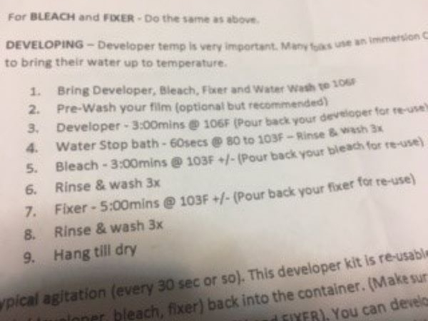

First, the FPP Fixer a.k.a. Fedele Fix package itself says about two minutes at 65-75 deg. F. The FPP kit instructions indicate 5 minutes at 103 +/- F. Which is correct? I used the latter for a couple of test rolls.
Second, I have attached the package instructions, but the main confusing FPP step is, after the developer "Water stop bath - 60 secs @ 80-103F - Rinse and Wash 3x"
I interpreted this as shown below in my overall procedure:
  • DEVELOPER 3 minutes at 106 deg F. Four inversions every 30 seconds
  • ILFOSTOP (fresh) 60 seconds at 80-103 deg F. Four inversions every 30 seconds
  • Rinse 1: 60 seconds at 80-103 deg F. Four inversions every 30 seconds
  • Rinse 2: 60 seconds at 80-103 deg F. Four inversions every 30 seconds
  • Rinse 3: 60 seconds at 80-103 deg F. Four inversions every 30 seconds
  • BLEACH 3 minutes at 103 +/- deg F. Four inversions every 30 seconds
  • FIXER 5 minutes at 103 +/- deg F. Four inversions every 30 seconds
  • Ilford wetting agent. 30 seconds
  • Hang and dry.
I did not pre-wash.
I am new to C41 so I don’t really have notes to compare and my test was on film I have not used before. The results seemed normal. The drying took much longer than I am used to with black and white (Ilford DDX and Rodinal 1+24).
Am I reading the instructions correctly? Do I need my rinse steps 3-5 if I have used the Ilfostop? Should I use less inversions based on the 30 second agitate intervals.
Either will probably work. Rapid access bleaches are quite fast. Since fixing goes to completion, time isn't very critical (neither is temperature) provided it's long enough.
Assuming a decently buffered, mildly acidic bleach, the stop bath in C41 isn't very critical, nor is a wash after a stop bath. It mostly serves to extend the usable lifetime of the bleach, which tends to be the most expensive component. To be honest I often don't rinse after stop, and when I do, it's only once and for 30 seconds or so.
All the thorough washing in that process description won't hurt anything, but it's a lot of work and most if it isn't really necessary.
Since fixer is generally fairly cheap, I use it one shot and evidently don't wash before it because why bother if it's discarded after a single use anyway. I do mix the rapid access C41 fix at e.g. 1+10 instead of the indicated dilution (I think 1+4 for my particular product) because when used one shot, it can be diluted further than if it's re-used and replenished.
No, C41 is essentially intended to be a continuous inversion process. Agitate as much as possible, I'd say.
Of course, your chemistry clearly departs from C41 standards given its off-standard processing time and temperature for the developer. That doesn't have to be a bad thing at all, btw, although it generally makes me a little weary of a chemistry manufacturer apparently doesn't get the job done at 100F for 3:15. Both Kodak and Fuji, and I think Champion too, have developers that work at these standard parameters. Why the need to deviate from them? It suggests tinkering on the part of the chemistry manufacturer - hopefully they tinkered to a good result. Fingers crossed.
Your images look mostly OK; the landscape is slightly dodgy as contrast seems rather high, but this might very well be the result of the scanner software doing an automatic adjustment. Mind you, this might also hide any processing errors, so scans like these don't tell the full story. On the other hand, if this is your usual output procedure, then basically who cares what happens in the process as long as you like what comes out, right? If you really want to figure out how you're doing, shoot a color checker one in a while and either scan using a calibrated scanning procedure or optically print onto RA4 to spot any problems. Not sure if that's the way you'd like to head into though. Boring testing can take the fun out of it, too.

I would interpret the first rinse as 60 seconds long with 3 changes of water. (ie every 20 seconds.) although 3 changes of water should not hurt. Ilfostop is for B&W so I would be hesitant to add that anywhere.
+1. Did the kit say use a stop? I think plain water rinse is the stop, just as it for say (pyro chemicals) and a chemical stop, even if simple acetic acid, might not be called for.
