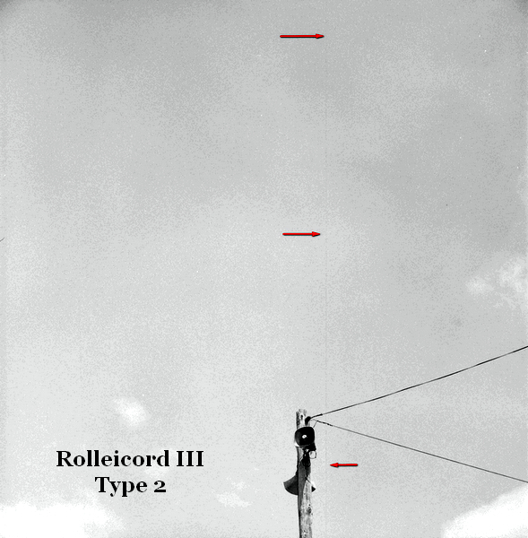

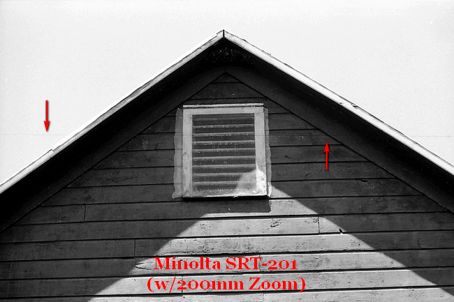

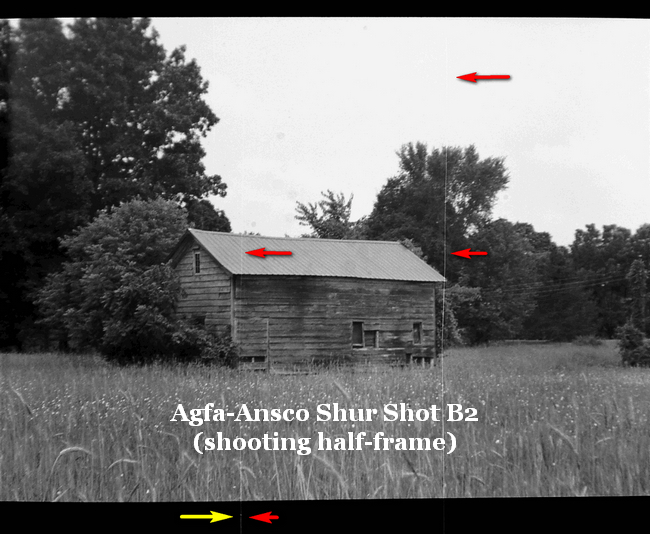

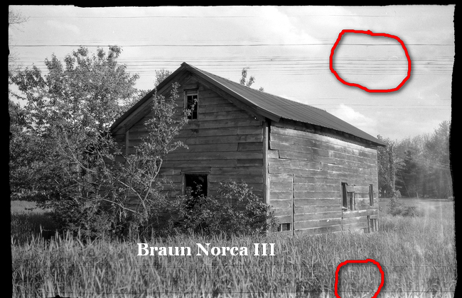

Roller marks? Cinch marks? Funky film? Light leak? Other? If anyone can identify the culprit with any of these lines,
it would save this relative newbie serious time so I can actually get to fixing the problem.
The Cameras
Photo 1 Braun Norca iii
Photo 2 Rolleicord iii (Type 2)
Photo 3 Minolta SRT-201 (with standard lens)
Photo 3a Minolta SRT-201 (same camera with 200mm zoom lens)
Photo 4 Agfa-Ansco Shur Shot B2 Box Camera (shot half-frame)
All cameras bought from flea markets except the Minolta SRT-201 which I purchased new in 1983(ish).
Development
* All film 3-years old or less.
* Paterson tank, Ilfosol 3, water stop bath, Ilford Rapid Fixer, 10 minute final wash and Ilfotol wetting agent.
* All negatives scanned directly to computer (Epson V600).

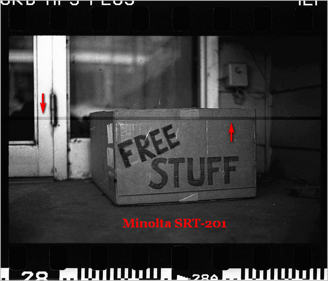

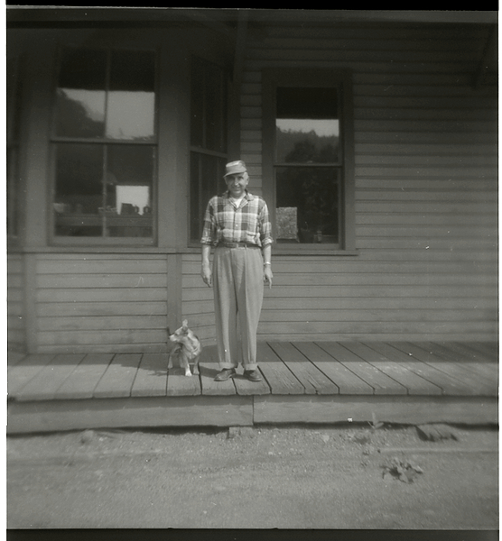

All lines shown in the accompanying photos appear in all of the negatives on the roll.
One exception is the Minolta SRT-201 photo "Free Stuff". Only half the negs on that roll had this line and no other
negatives from the Minolta has these lines.
Please contact for any further info.
Thanks kindly in advance!

With the exception of the first one they all kinda look like lines from a dirty or defective scanner.
Can you see the lines directly on the negatives or only on the scans?
Dr Croubie
Mar 21, 2013
1,986
rAdelaide
Easiest way to tell if it's your scanner: Scan it once, and see where the line appears. Move the negative, even better rotate it by a few degrees, scan again. Has the line moved in relation to the details in the photo? If yes, blame scanner, if no, blame {film manufaturer, cassette, camera, developing tank, squeegee, neg sleeves, etc}
BobClack
BobClack
Nov 16, 2013
82
Upstate, New
LG/Dr C.,
Nailed it!
It's the scanner. On the "Free Stuff" neg, there's no line on the actual neg. On a different photo (not previously posted) the line disappeared upon re-scanning in a different position.
Thanks folks for the huge time saver!
Bob

Do you squeegee your film?
Ghostman, Squeegee yes. I considered that with the first photo (Braun Norca III) and it's many wavy lines. With all other lines being a perfect 180°, I'm guessing that I'm probably not that accurate with my squeegee flaws :confused:. Will shoot a 2nd test roll with this camera and post result.
Thanks for the shout!
Bob
Ghostman
Dec 5, 2011
504
Switzerland
If you're using a squeegee, don't. Throw it away. I dip my fingers into the wetting agent solution and when I take the film out I gently run it between two fingers. Squeegees are terrible, you're asking for trouble using one.
BobClack
BobClack
Nov 16, 2013
82
Upstate, New
Gman, Lesson learned. Advice taken.
In searching around the forums, I'm seeing a rather large consensus on squeegee dumping. I was worried about finger oils on the negs but the idea of wetting them first in Ilfotol rinse now looks like the far safer alternative than risking a single grain of dirt in the squeegee.
Much thanks!
MattKing
Apr 24, 2005
55,260
Delta, BC Canada
I wouldn't even suggest squeegeeing with your filters.
Just make sure that your wetting agent solution flows easily.
I do run my fingers down the edge of the negatives (to break the tension), and do finger squeegee the "leader" portions at either end, but otherwise I only want air touching my negatives.
I also mix my wetting agent (Kodak Photoflo) using a small bit of alcohol to aid evaporation, and make sure that the concentration is rather low in my otherwise soft and clean tap water - most likely closer to 1:300 rather than Kodak's recommended 1:200.
BobClack
BobClack
Nov 16, 2013
82
Upstate, New
Matt,
Thank you for the response. I started bw developing about 6-months ago and am still finding my way. Yes, I have seen in the reading that some people just "let it be" with film drying with perfect results. Will give the "let it be" approach using Ilfotol a whirl.
Back with results in a few days. Thanks once again!
