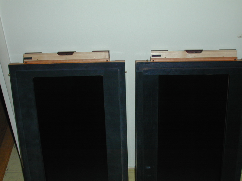

CP, It appears you want me to post twice to our exchange in the other forum. I'll be happy to. First off in post #27 on the other forum you ask. "Is it true you have two film backs for the camera you mention and that Alan DID custom fit the holders to the back you sent him?" Now your claiming that I only sent him a holder. I assure you Brubaker had a holder and one of the backs and I will post pics here also of both of the backs loaded with the holders. The holders fit neither back. So yes he was suppose to fit it to the back I sent him like you asked in post # 27 at the other forum. Yes and it is true Alan took a return on some custom made trays because they leaked like a sieve and they didn't fit my sink after me giving him exact measurements of length, width and depth. Instead of a refund I had him send me an 8x20 holder and sent him the extra money to make up the difference in price. This holder didn't fit so this is when I ordered the 4 custom fit holders and just told him to keep the money toward the price of the custom holders. In one of our previous phone conversations Alan said send the filmholders back and he would make it right. He also said he would address the filmgate slop. He then calls back because I had sent him a pic of how the holder was fitting into the back and asked me to send both backs. So I proceeded to remove the ground glass from both backs for shipping. I then took some exact measurements and called him to tell him the discrepancies in his holders to the measurements of my backs. This is where he changed his mind again about fixing the filmgate slop. He had no intention of fixing the holders. He wanted both of my backs so he could mill my backs to fit his holders because he could see in order to mill the top rib handle he would have to mill through the rib plate mounting screws. He also made no mention to me that this was his intentions until I confronted him with it. I paid for holders to fit my back...not for my back to be milled to fit his holders. This is what is meant by custom fit holders. Plus four sheets of film into the filmgate allowing enough slop that the film is on the verge of falling out of the film rail is unacceptable by me. In comparing these to some of his older 12x20 and 7x17 holders the older holders have a tighter filmgate by twice as much. Here is a pic of both the vertical and horizontal backs. Just so no one thinks I'm showing the other back that wasn't sent to AWB. You can tell the vertical back from the horizontal by the location of the mounting pins. Roberthttp://www.apug.org/forums/attachment.php?attachmentid=9519&stc=1&d=1200194603
