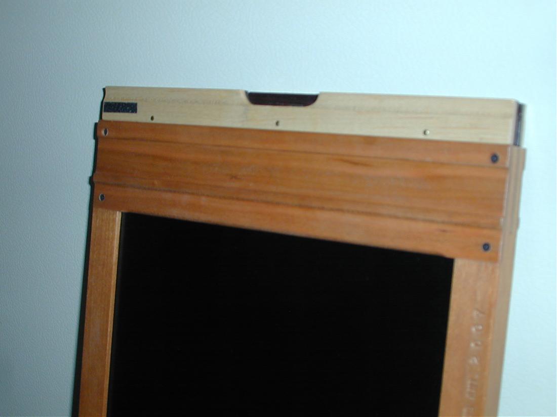

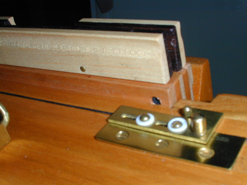

Brubaker top rib
Here is a picture of the AWB Brubaker holder. These holders have 2 ribs, an inner rib inside the back like most holders plus a top rib that is suppose to snap over the camera back. The next pic is the holder loaded into the camera. Notice if he mills enough away to clear the camera back he will be milling into the screw hole that attaches the rib plate. Obviously this fix wouldn't work. His next move would be to widen the groove in my back an extra 3/16 " then that would require me to have to pull the film holder up that far off the bottom of the back to get it to engage. This is why I paid for custom built holders so I could avoid these kind of fixes. Not to mention the other problems.(there was a url link here which no longer exists)

By the top rib not seating over the camera back this is holding the inner rib away somewhat from the groove inside the back, naturally causing light leaks. Robert
