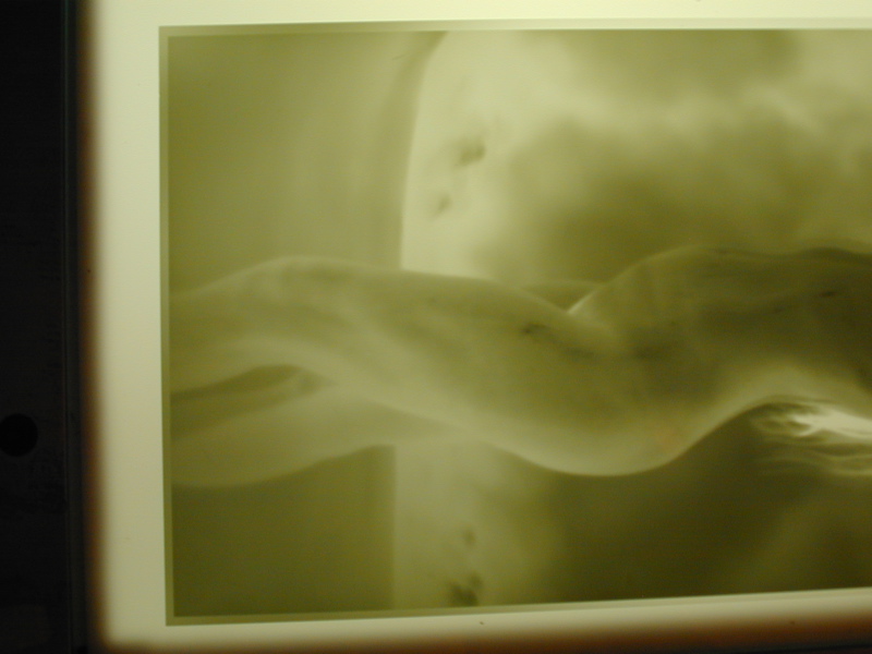

I bought some new 8x20 filmholders a few months back. I just got around to shooting the first sheets with the new holders about a 2 months ago and just last week got caught up on developing the film. These shots were done in the vertical position ( I have a vertical back for my 8x20). I then noticed that the film seemed to be getting exposure across the entire sheet of film in the area at the top of the vertical nearest the dark slide handle. I then started looking at the gap between the film rail and the septum. It looked to be quite large. So I took two sheets of film and they slide in with no problem. I then took three sheets of film and they too slide in with no problem at all. This seems to be causing film sag or at least poor film flatness. Someone please tell me that being able to slide three sheets of film into one side of a filmholder is not normal. I won't mention the filmholder manufacturer because we are bickering about having the holders replaced. Robert

Let my also add that I did the use other holders (different manufacturer) during the same shoot and developed them the same way and this problem of exposure across the entire sheet was not present. I do have an old 2MP digital camera that I could take a photo of the end of the film that I'm talking about so you can get an idea of what I mean if that would be of any help. I won't guarantee how well the d---tal shot will come out though. I have a lot of money invested in these holders. Thanks, Robert

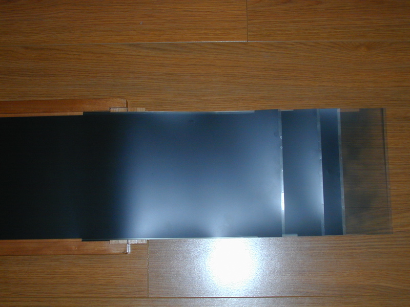

Steve, Thanks for your input. But my problem is with the construction of these brand new holders and the fact that the distance between the septum and the film rails is well over .021. That allows for three sheets of film to be loaded into one side of the holder with ease. These holders were built to my camera as I sent my camera back to the manufacturer to fit the holders to the back. The fit of the rib lock is not the problem. When loading a sheet of 8x20 in the vertical position the film sags at the bottom to where it is touching the film rail so this is pushing the top of the film back against the septum. Due to the slop in the film slot this is allowing light to enter around the film rail.Thanks, Robert

I'll try posting a pic with this old d---tal camera off the light table. At first I thought it was fog across the entire area but the image area is not fogged. This seems to tell me that although the image is very faint at the top of this pic where the background sweeps up ( I'm not sure you will be able to see this from the photo) that although the image is not being registered since it is behind the rails the gap from the slop in the film rails and septum is allowing light to reach the edges of the film that is being pushed back against the septum (at the top) since the bottom of the film is sagging forward against the film rails. Keep in mind this is an 8x20 negative shot in the vertical position. I will post a pic taken with a 2MP camera. Robert

8x20 neg

When the film holders get bigger, the dark slides get thicker, hence the area at the top in which light can enter the back is bigger. You might check the springs on your camera back to make sure they pinch the top of the holder (compressing the opening) when the dark slide is pulled. You might just need to apply more tension to the camera back.
If that doesn't work, use a couple of work arounds: 1. In bright sun light, leave the end of the dark slide in the top of the holder (put a mark on the outside of the slide where it is out far enough not to cover the film, but still fills the opening), 2. cover the top of the holder with the dark cloth and bunch it up against the darkslide, such that when the slideis pulled, the dark cloth covers the opening, reverse the process for inserting the slide.

Robert, it looks to me as though your light traps need to be replaced. I do not think the slop in the film gate is causing your fog. I also do not think that the slop should be there. Personally when I make holders, they do not allow loading of two sheets of TriX at the same time.

Allen addresses the possible light leak problem, and I think all ULF users have had to work around the weaksprings/weaklighttrap/mismatchedholder/nonstandardriblock problems. Your problem seems to be manufacturing error. I have no less than 10 different brands of film holders for 5 formats, and none would show such obvious generosity with film thickness. This almost could qualify as a plate holder. You bought a "film holder" and it doesn't hold your film, and it exceeds standard dimensions. I would demand satisfaction.

I may have to eat my words on the film being fogged across the entire sheet. After putting it on the densitometer it is obvious that there is fog across the sheet. I guess my old eyes aren't as trustworthy as they use to be. I went out and shot more film. I did notice the rib lock wasn't seating tight in the camera back and sure enough it was holding the holder away from the back just a hair. The fix is just milling a little more off the rib. But I would still like a tighter fitting film rail. But I don't think that is what is causing this problem so I guess I will live with that. Thanks guys for the input. Robert

If the manufacturer doesn't make right on this I will soon be posting pictures of the workmanship, showing how easily I can slide three sheets of film into one side of a holder and how the rib lock is so far off after having sent my camera back to them to build the holders to fit. I may even post a video on You Tube showing the slop in the septum to film rail as I load three sheets of film. These are some of the most expensive film holders on the market and I expect better service than this. Robert
I see this allot in one make of cameras. If I get that make of camera in for service I always check the rid lock slot, 70% of the time I need to make adjustments. Take the ground glass frame off and check the joints I have also found glue mounds that held the holder away from the back and caused leaks.

Just so everyone knows what I'm dealing with here. Here is a pic of 4 sheets of film that will slide in but they are tight. Here you can see what I mean by three sheets sliding in easily. Now with this much slop in the film gate when shooting a narrow format like this (8x20) in the vertical position you can see the film sag at the bottom out against the film rails at the top the film leans back against the septum. So it is not like I have to force three sheets into the holder. Three sheets goes in with plenty of room for clearance. Roberthttp://www.apug.org/forums/attachment.php?attachmentid=9503&stc=1&d=1199985230

I guess a lot of the manufacturers read this forum. Since I started this thread the manufacturer has just contacted me requesting I send the holders back along with my camera back so the new holders can be fitted again. Thanks everyone for all of the input. I will keep everyone posted on the outcome. Robert.....P.S. I guess a little ranting and raving on my part paid off. But it should never have to come to that.
