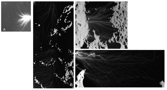

"static electricity' could fog the film so you might want to try to eliminate it. The most common time I see the little sparks is when removing the tape from 120 film. So, I usually cut it instead.
Check your negatives closely, anything like these visible? They may be very faint
Off topic, I know, but anyone have any suggestions for deliberately introducing this effect?

A Kirlian apparatus.
(A plain high-voltage apparatus, but be careful, we want you to stay here at Apug...)
Otherwise you might try to pull the film fast through a slit in dry weather, or ripping off adhesive tape along the film length.
Some modern films have special means to counter build up of static charge.

Some posters seem to confuse the triboluminescence that happens when pulling tape off the film with the possible chemiluminescence described here. Two observers have mentioned that it happens with pyro developers, so it would be interesting to know if you are using a pyro developer. You also did not mention what kind of stop bath you use. I've found that with developing times greater than 5 minutes, using a couple of fresh water rinses works as well as a stop bath. This might cure the problem. A different stop bath also might (might) work. The real question is whether it makes any difference. You could process a blank sheet using water rinses and another using your flashy stop bath and see if you see any difference in density between the two.
