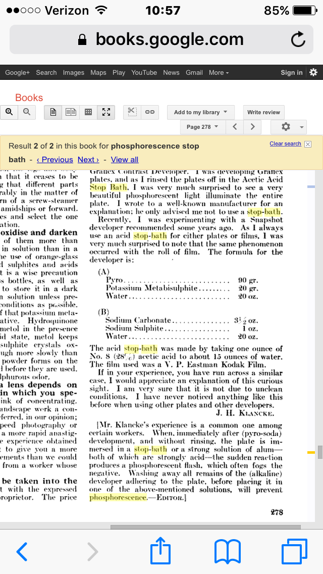

  13. OP
    Ian Leake
    Ian Leake Subscriber
    Ads Enabled
    Messages:
    1,495
    Joined:
    Mar 25, 2005
    Location:
    Switzerland
    Shooter:
    8x10 Format
    OK, I'm really impressed! This is must have been what was happening. The negatives stopped in acetic acid had a slightly higher FB+F than the ones stopped in water. Clearly a water stop bath is necessary. Thanks for clearing this up :smile:

  15. Jarin Blaschke
    Jarin Blaschke Member
    Ads Enabled
    Messages:
    287
    Joined:
    May 30, 2013
    Location:
    Los Angeles
    Shooter:
    Good lord, I couldnt imagine yet another reason that Pyro could be such a pain in the a—. Damn you, Pyro and your bewitching tonality!
    Water stop: uneven development, mottling.
    Acid stop: fog, bloody highlights.
    Argh!

  17. NedL

    Shooter:
    Hmm, I wonder if this is the reason I've seen recommendations to use stop bath mixed to half strength when working with some pyro-based developers. If the stop was used one-shot it could probably be mixed even weaker.
    Having said that, I've never seen any evidence of fogging while using Pyrocat-HD with a half-strength acetic acid stop, with either roll film or sheets. I'll look out for this phosphorescence next time I run a few sheets of 4x5, for which I always use trays.
