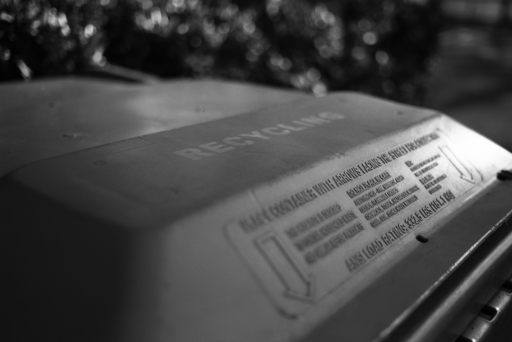

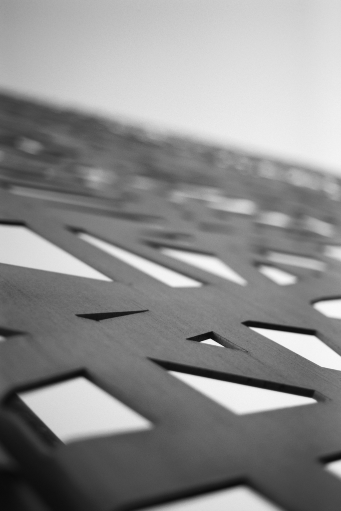

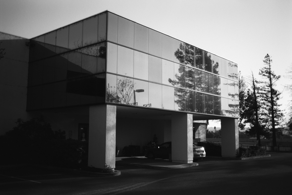

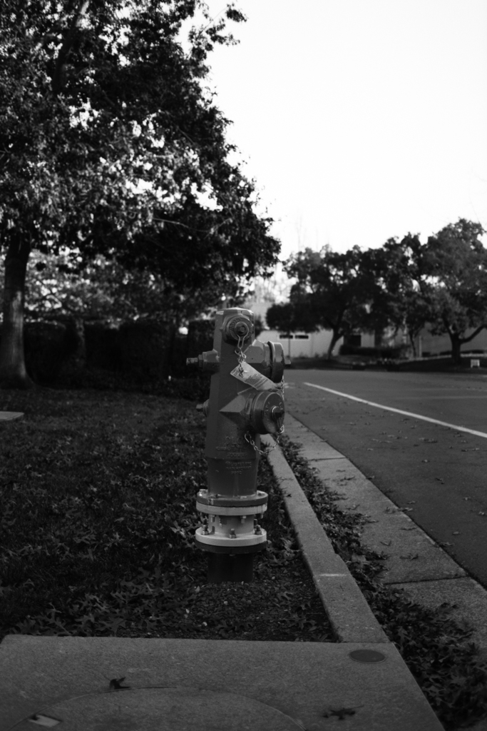

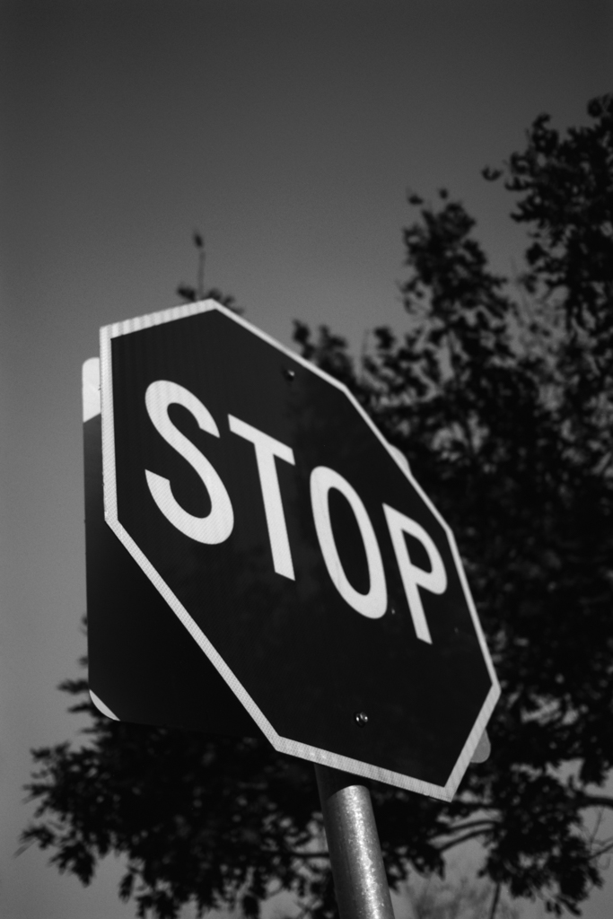

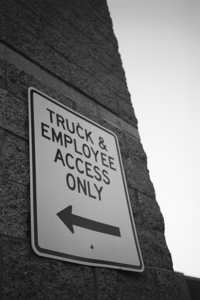

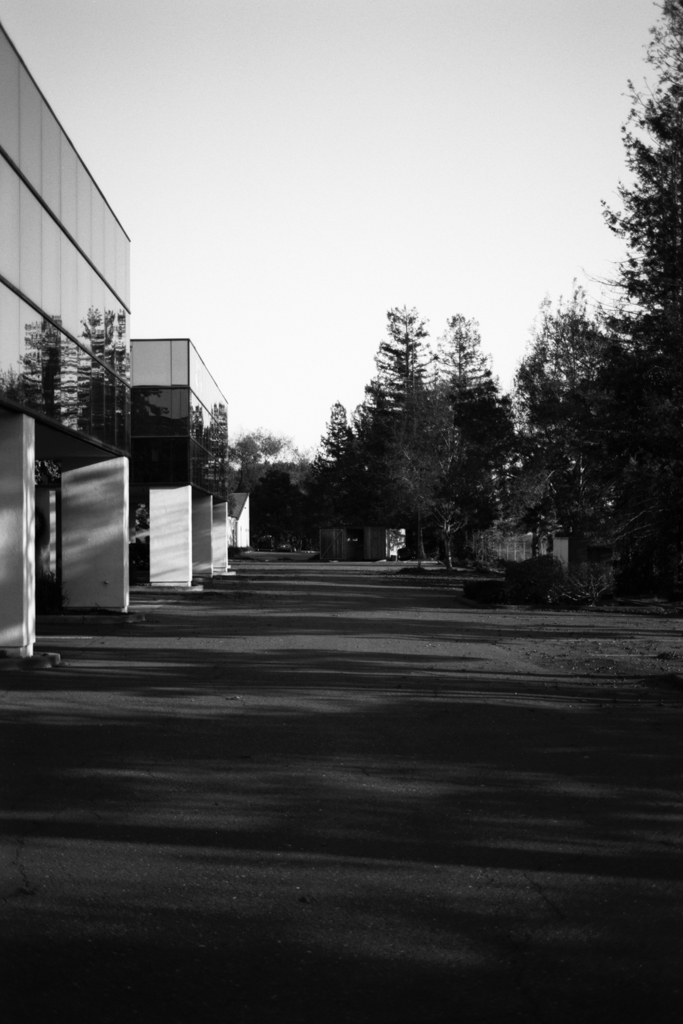

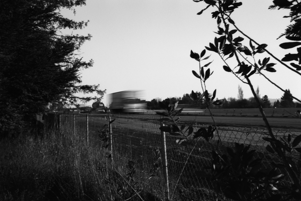

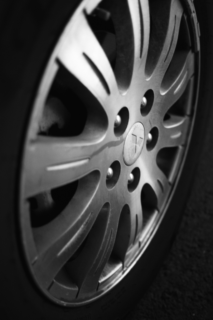

OK... Here are some sample photos... I shot these with a Canon A2E with Canon's 40mm STM Pancake prime. I put it it in AV mode and just walked around and took some pictures with the ISO in the camera set to 12. I think I should have done EI 10, as the shadows are pretty lacking in detail. My aperture varied between 2.8 and 5.6.
First off, here's a studio shot of an X-Rite Colorchecker Passport Photo. The Color response of P30 is... interesting. It does not appear to be particularly sensitive to reds and very sensitive to cyans, blues, and purples. I lit the shot with a 5500K strobe, incident metered for EI 12.
In terms of grain, this is relatively fined grained, though this is very much not my favorite emulsion.
The curves look very similar to Tri-X, with that long toe, and slight bend in the higher densities. I'm tempted to do side by side comparisons...
