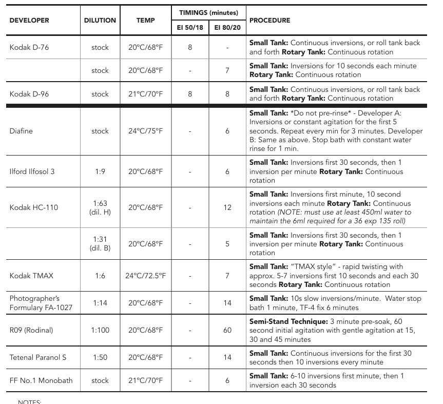

interesting the OLD guide had several developers listed. this is a screen shot fro
m the V3 Guide.

interesting the OLD guide had several developers listed. this is a screen shot froView attachment 380499m the V3 Guide.
The times for D76 don't make any sense to me. It needs 8 mins for a lower speed and yet only requires 7 mins for 80 with all others things being equal for rotary but reverting to the Ilford inversíon cycle which you'd expect to take even longer
