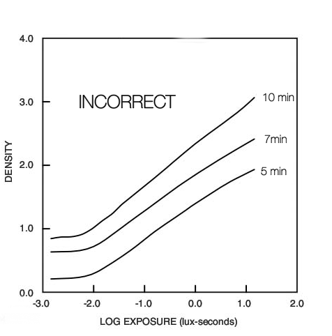

...do the lower zones (initially) develop at the same time as the higher zones. .......
If the high and low zones developed at the same rate the film curve family would look like this.
I suspect everyone knows what a correct film curve family looks like. But, just in case...
screen-shot-2018-04-01-at-10-30-41-am-png.197978
Notice that the inflection point of each film remains constant. This is the true speed and cannot be exceeded. The only thing you can do is change contrast.
PE
