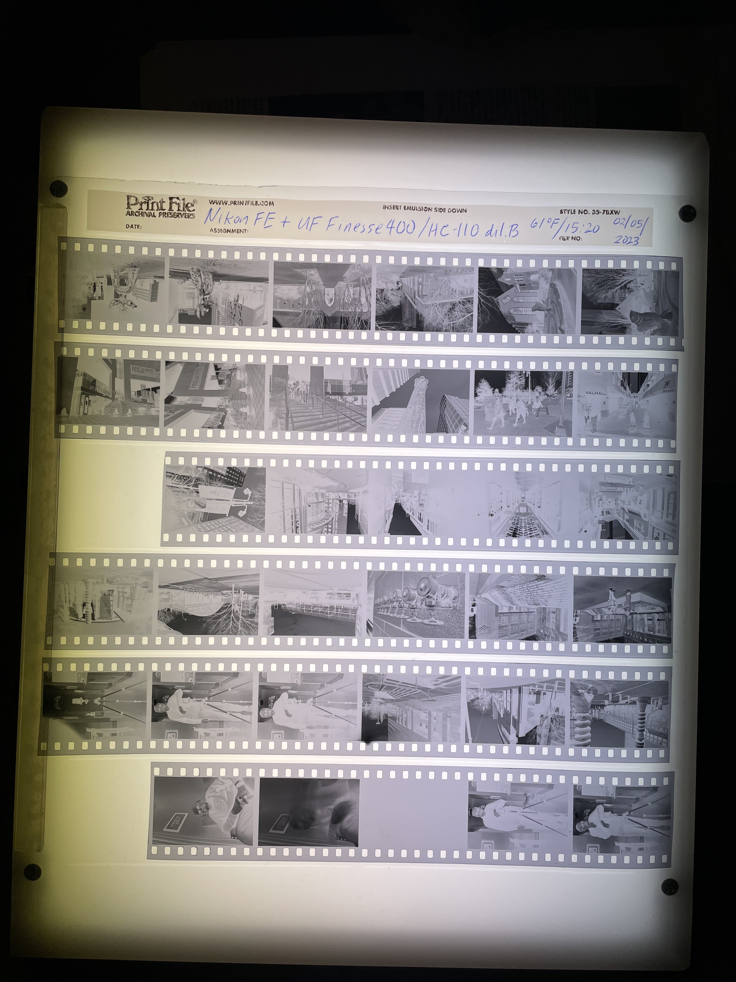

Thank you for your interest in helping me further. Here are the answers to your questions:
How much time did you develop? 15:20 min.
What stop bath did you use? water
Did you accidentally mix too strong. I don’t think so. I believe I put 10 ml of concentrate + 290 ml of water.
Did you mix at 1:7 from concentrate (supposed to be stock) vs 1:31 from concentrate. I only use concentrate, no stock solution.
When did you start/stop the clock? after I filled the tank
Did you pre-rinse? no
How dark are the negatives anyway can you snap a photo of them with your phone to show them? see attached picture

Those negs look quite thin, but why are there no edge numbers?

I developed that roll for 15:20min. The normal development time at 68ºF is 7 minutes.
I don’t know who is the manufacturer for these Ultrafine Finesse films
It's fomapan 400.
Your negatives look underexposed to me. I see areas of decent density where the film received sufficient exposure, suggesting development was in the ballpark alright. Just not enough light :smile:
This film tends to not quite reach its box speed - by a long shot in fact. Try rating it at 200, and carefully meter important shadows. It also pays to make yourself very familiar with how the light meter on your camera works and what its strengths and weaknesses are. Center weighted meters like on your FE are easily thrown off by bright highlights, fooling the camera into thinking the scene is lighter than it really is.

Looking at the contrast of the outdoor scenes where the sky is dense and the people walking are very thin, I think you have both underexposed and overdeveloped.

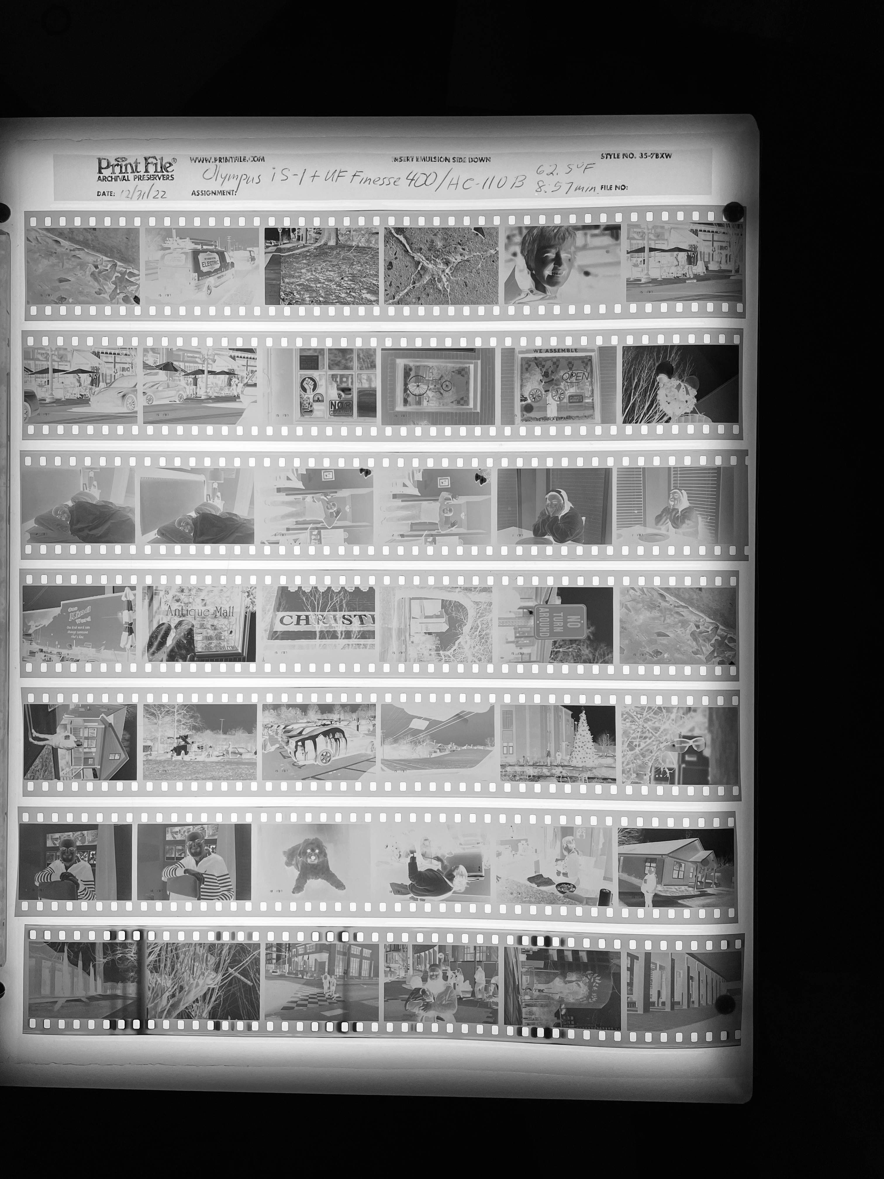

I don’t think this film is really ISO 160 as you indicated. The attached picture shows a roll of Finesse 400 shot at ISO 400 using an Olympus Point & Shot IS-1. The roll was developed with HC-110 dil. B at 62.5ºF for 9 minutes. Some of the pictures were shot with the camera flash in the P mode. No compensation was used in any of them. These negatives were much better than the ones I got with my Nikon FE.
A roll of film exposed quite randomly generally doesn't allow for drawing conclusions about the performance of a film/developer combination. Most of the images on this roll, furthermore, appear to be fairly weak in terms of shadow detail, to put it mildly :wink:
It's kind of boring/tedious, but the kind of testing @ic-racer alludes at is a more thorough way to arrive at more reliable conclusions about effective film speed.
In any case, underexposure certainly is part of the problem you reported here. Several factors can influence this and the film performing not quite as you might expect is just one of them. Let me put it differently: if you shoot another roll of this film while exposing it as if it's a 200 film, and you still run into exposure problems, that's a pretty firm clue that you have some other causes playing a role as well. I think you'll find this to be the case, if I'm honest.
