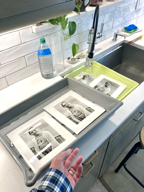

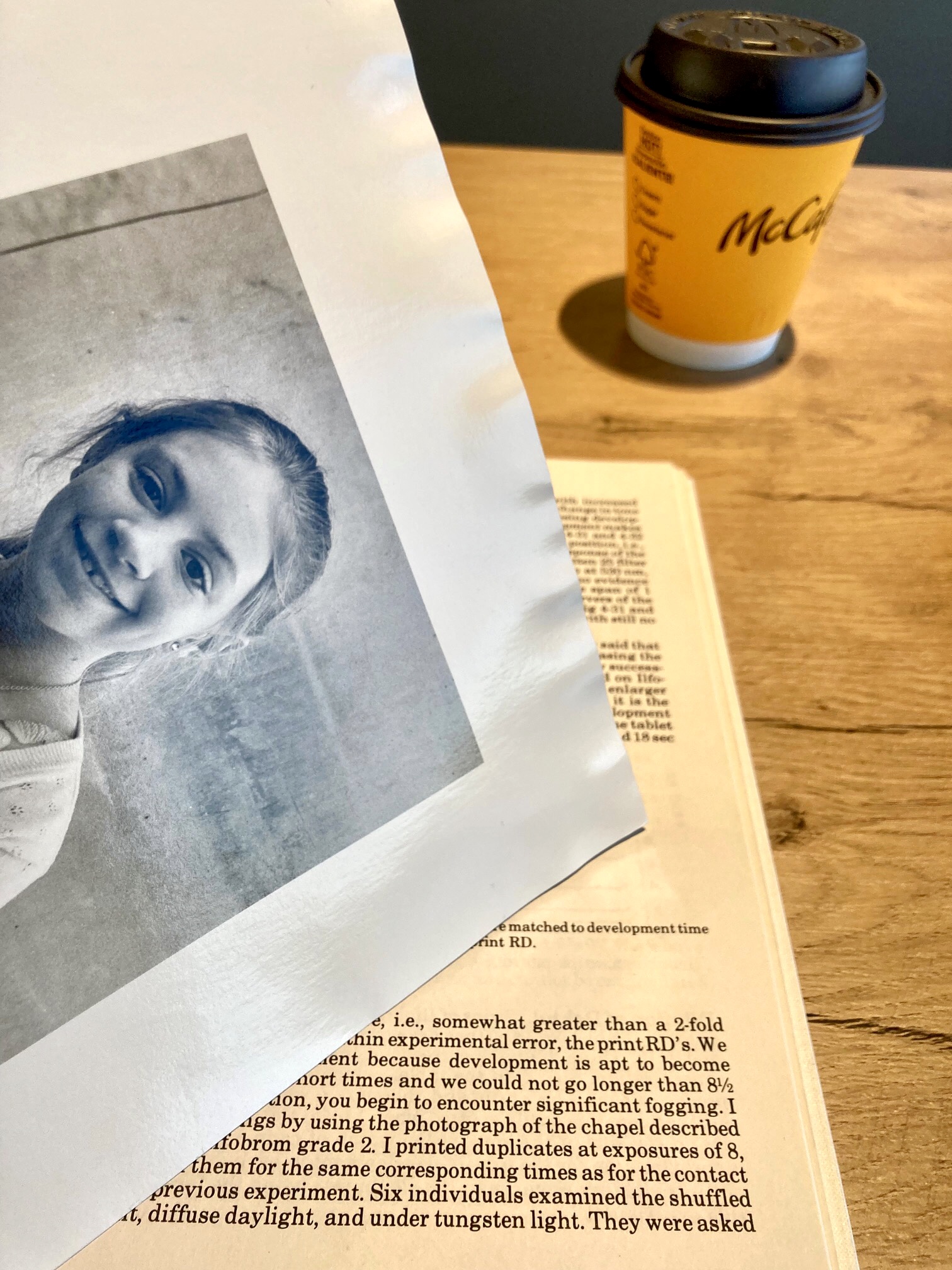

In recent years I am experiencing print frilling using Ilford FB paper. My fix is TF-4 and more recently TF-5. I wash prints with a tray fill and dump method. Heico is my wash aid. My wash wet time is 30-40 min with 5 or 6 dump and fills. I typically am careful to fill the tray with the same tempered 20-22c water. Prints are air dried (20-21c) overnight using green photo plotters. The drying print is left on a counter top face up with a damp blotter under it. The frilled example is affected on one side. I used 2 dry blotters plotting up moisture on each 8x10 print.
In a previous session using the same paper I did not have this problem. I believe our water quality has calcium. However, in past years I have not had these issues so water quality is not suspect. Perhaps it has to do with uneven drying.
Does anyone have any ideas of the cause and a fix?

Frilling is different from the waveiness of a typical dried fiber print. Even with the heavier older papers I mentioned there was some natural curl. Ilford’s Multigrade always being the worse offender. Those heavier papers would lie flat after being placed in books.
Frilling is different as you can see by the supplied photo. In this case it was on one edge. Note…I only see this on 8x10s…not on Ilford’s pre cut 5x7s.
All I can do is experiment in making sure the print is not stressed during the wash cycle, getting the print drier, perhaps drying face down, and last it may be worth while to look at my fix. TF-4/5 are alkaline. Not been a problem in the past but Ilford changed their paper technology. Alkaline fix swells gelatin allowing much faster fix times and perhaps Ilford’s more neutral balanced fix produces less gelatin stress. The only other factor is Heico wash aid.
