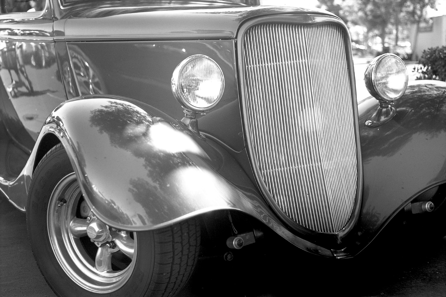

I used quite a bit of the Alpha P30, and it I like this film. When you get it right it has a great tonality with high contrast and fantastic midtones. I found the Alpha version to be a bit finky in the sense that I never got repeatable results from different batches. It is very high contrast and the highlights tend to explode. I tried it a iso 80 using some of the datasheet recommended developers and I found that the times gave extremely hard negatives, very underexposed and very overdeveloped. My best results were at e.i. 16 or 25, in rodinal, pulling a lot the development, but I could never reproduce reliably my results. Again this was the Alpha.
It has a super fine grain (I could not see it on the enlarger for a 24x30 print!) and when you get the right contrast it is a joy to print in the darkroom. IMHO it makes for a great porttrait film or for when you have very controlled lighting conditions, I wish Ferrania would make it as super8, it would be terrifinc in the format!
I have yet to try the non-alpha version. The image attached was shot at midday in a sunny day, at ei16 and developed in rodinal for 5 minutes.

The above pictures that are of the cars, looks a lot like the results I got from Double X film in Xtol, slightly over developed.
