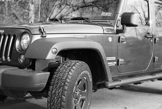

I shot and developed my first roll of the new production, and so far it looks pretty good. I haven't printed or scanned but the roll drying in my bathroom looks a little bit lighter that the roll of Acros I developed just before it with Xtol. Shot at 80 and developed in D76 for 7 minutes.
I'll probably Pyrocat-HD mine, and shoot around EI 40-64.

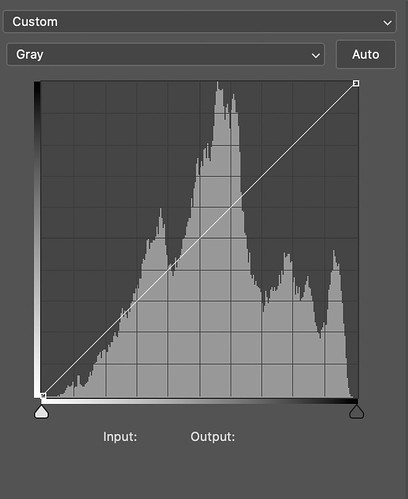

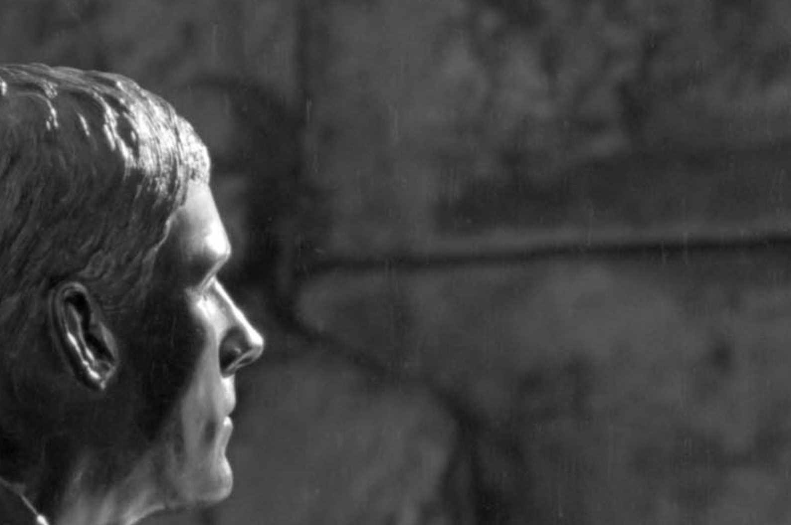

Here's one from the non-alpha P30 that I made this week, just taking random test images on an overcast day. The histograms show the raw scan and the adjustment I made to increase contrast.
T Max developer 1:6 @ 24C for 5 minutes. (That equates to Ferrania's best practices minus 30% time in the developer.) The negative was exposed at iso 50.
The time should be 7 minutes at 80ASA, but these still look great. I never tested shooting at EI 50 and TMAX Dev. I guess I should.

Yes I should have mentioned that detail. I exposed one roll bracketing iso 80 and iso 50. Then I cut the roll in half and developed one half at 7 minutes (Ferrania's recommendation for iso 80) and the other half at 5 minutes (my guess for iso 50). I figured that the iso 50 images might benefit from shorter developing in the hi-lights.
At any rate each half of the roll had images with good distribution of tones, and each half of the roll also had problem images (lack of shadow or blown hi-lights). I used my in-camera meter, and my normal fairly sloppy metering technique so I think that's my issue. P30 is a good film but it requires careful exposure, and that's on me. :smile:

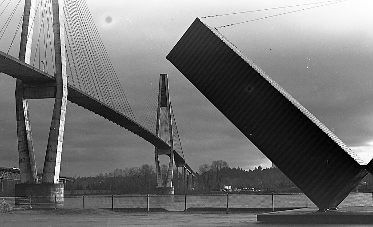

Can I ask you if you had some issues with strange spots or streaks from 3 of us who used it against the alpha. They appear like this photo:
These are not from Photo Flo, or squeegee/wiping (I never do this) and not water spots, they are in the emulsion.

I just checked and my negatives do not show that problem anywhere.
Thank you! I had a feeling it would be addressed for the release rolls.
