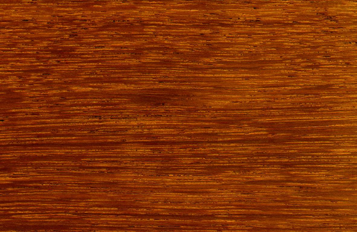

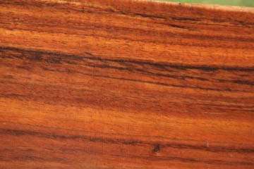

I've made a large format pinhole camera from Afzelia, an African wood.
attachment.php
attachment.php
attachment.php
It becomes more redish when finished.
