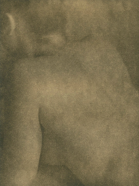

Thomas, the print has arrived safely thanks. I did post a note in the FAN Group. Sorry you missed it. The print is fantastic and the wife loves it also. Can you fill me in on some technique details. The print is very subtle and low key. Is it Lith? The mottled grainy effect would suggest so but I've never seen this effect with my Lith printing. The colour is very strong and suits the low key print very well. A very impressive print and composition. Thank you.
I'm glad it made it there OK! And I'm even more pleased that you like it.
It is indeed a lith print. It's an enlarged 5x7 negative, cropped since my enlarger only takes 4x5 negs max. It's printed on Fomabrom Variant 112 in a very strong lith bath (Arista Powder Lith, from Freestyle), and then toned to completion in selenium 1+10 at 80*F (25*C roughly). The toning only took about four minutes if I remember correctly. Final print size should be 9x12 inch. I left the border intentionally since I don't know how you mount prints (if you desire to do so), and it leaves you with the option of trimming it off it that's necessary too.
I just hinge the print to the backer board and over mat. Many people today dry mount, which looks very nice. But the conservator at the Minneapolis Institute of Arts told me once that I should never do so, because if something happened to the backer board, you have to scrap the print. Or, if you believe in preventative maintenance, perhaps some day you wish to put it on a fresh buffered backer board.
Once again, I am extremely pleased that you liked the print.
There's a very poor scan of the print attached. I don't think I can ever learn how to scan lith prints and do them justice.
- Thomas
