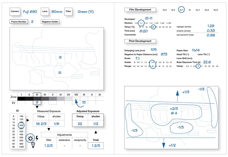

Attached is an example of exposure and print records. The print data on the right is recorded in terms of f/stop timing. This is transferable to any print size, and if the filtration is calibrated, it can also be transferred to another paper or enlarger without any modification of the relative f/stop timing.
