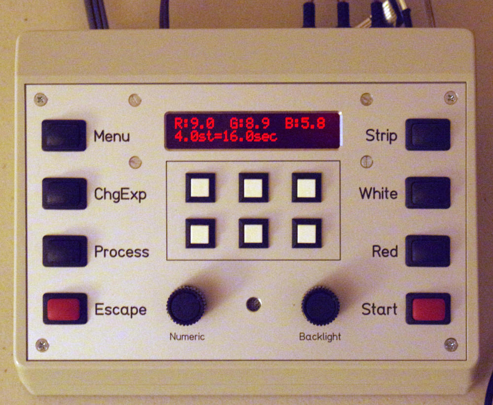

I used "stops" for time in my timer/controller for LEDs, abbreviated as "st" as the time "4.0st" illustrates below:

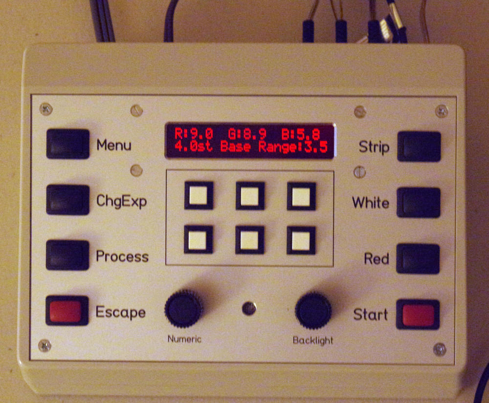

But when one selects and changes time, the controller also displays seconds:
For me, this is clear. It cannot be confused with f/stops (aperture) on the lens.
The LED-brightnesses on the top row of the display for red/green/blue are also in stops (10=max, 9=half bright, 8=quarter, ...). The steps in test strips (via the Strip button) progress in stops, not seconds. With everything in stops, it's easy to interchange settings, such as dimming the LEDs and exposing longer to compensate. Yesterday, Ralph Lambrecht posted a chapter from his book, Way Beyond Monochrome, detailing additional advantages of stop-based timing.
