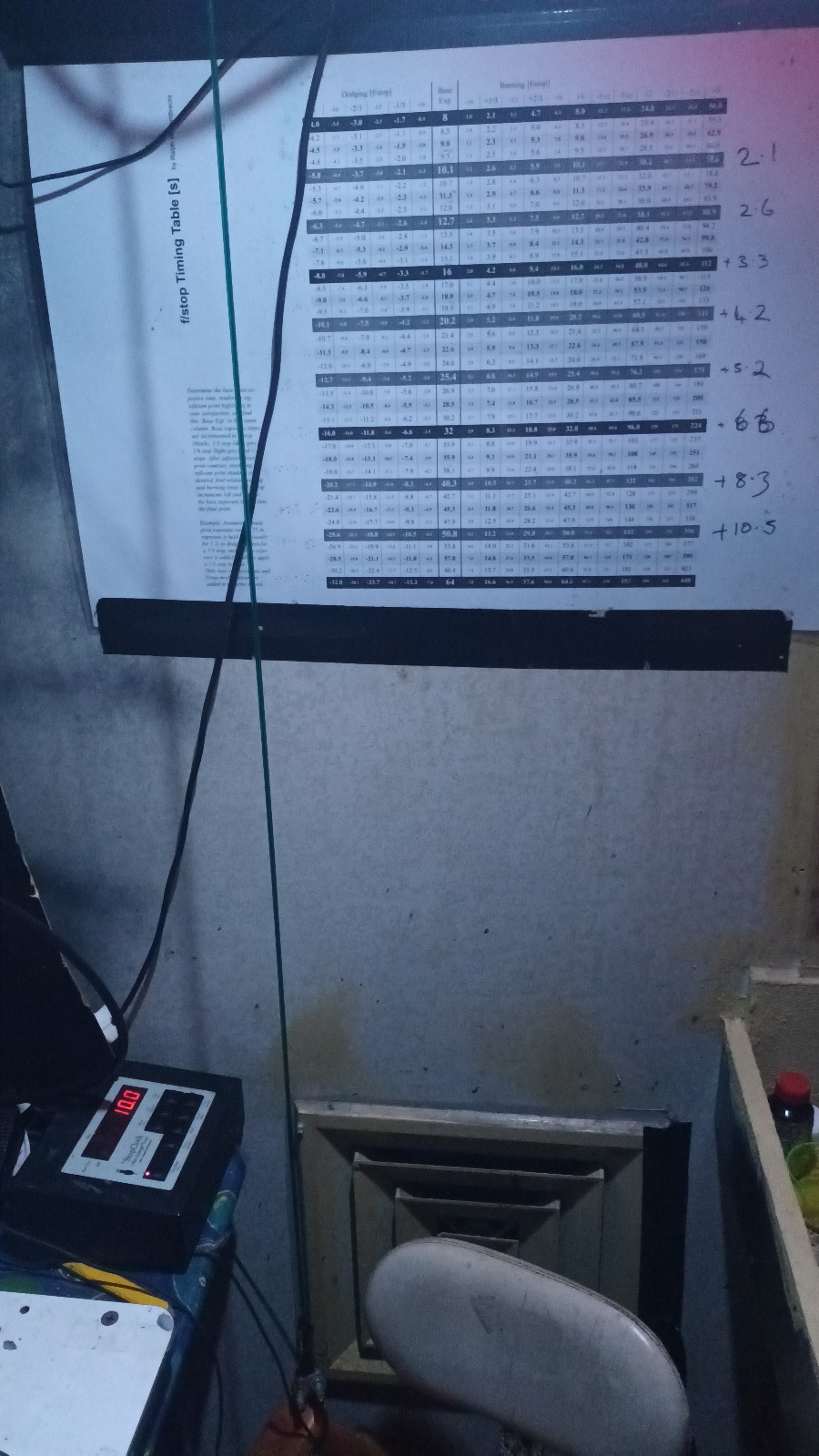

Well I stop down about 2 or 3 F stops to maximise the enlarger lens performance and then experiment with exposure time.
All you need, easy peasy.

And if you ask nicely, Ralph will share the pdf of that table (and a bunch of other useful things) from his book Way Beyond Monochrome.
Shhhh you just can steal it when he's not looking.
There's quite a few variations on the net you can download, print out in a3 and laminate.
