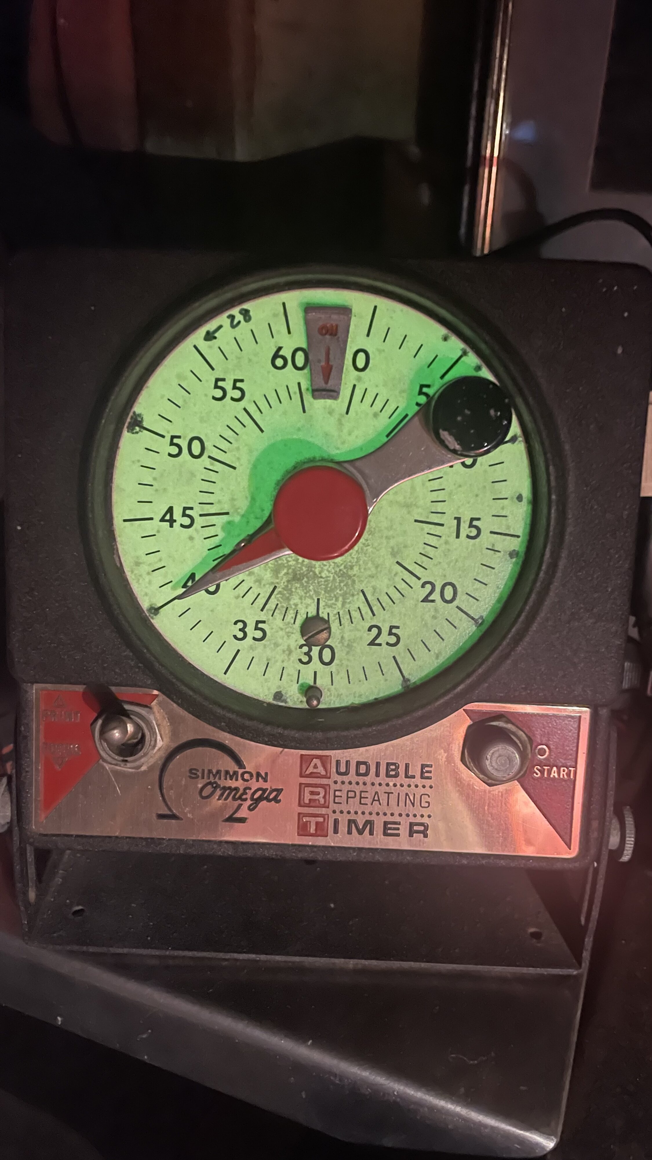

The absolute best f/stop timer is the audible repeating timer from Omega. Looks like any old Time-O-Lite but clicks on seconds.
Write dots at third-stop intervals starting at 50. Then memorize the sequence.
Intervals in this strip starting at 40 would be 8, 7, 5, 4, 3
Place test strip start time then cover up most and count those clicks and move. Doesn’t matter if a few clicks go by, you’re counting 8, 7, 5, 4, 3 and moving the card to expose more of the strip each time.
You’ll end up making a test strip that is 40, 32, 25, 20, 16, 13
Then the fun is when you print and want to dodge 1/3 stop, you can move the dodger anywhere and hold it for 8 clicks, move somewhere else for 8 clicks. Or if you want to dodge 2/3 stop move the dodger and count 15 clicks. You’ve got time to do all that.
If you want to burn something 1/3 stop, move the arm to 50 and burn 10 clicks (and do all that dodging too).
Clicks and knowing how many clicks are 1/3 stop make easy work of burning and dodging.
