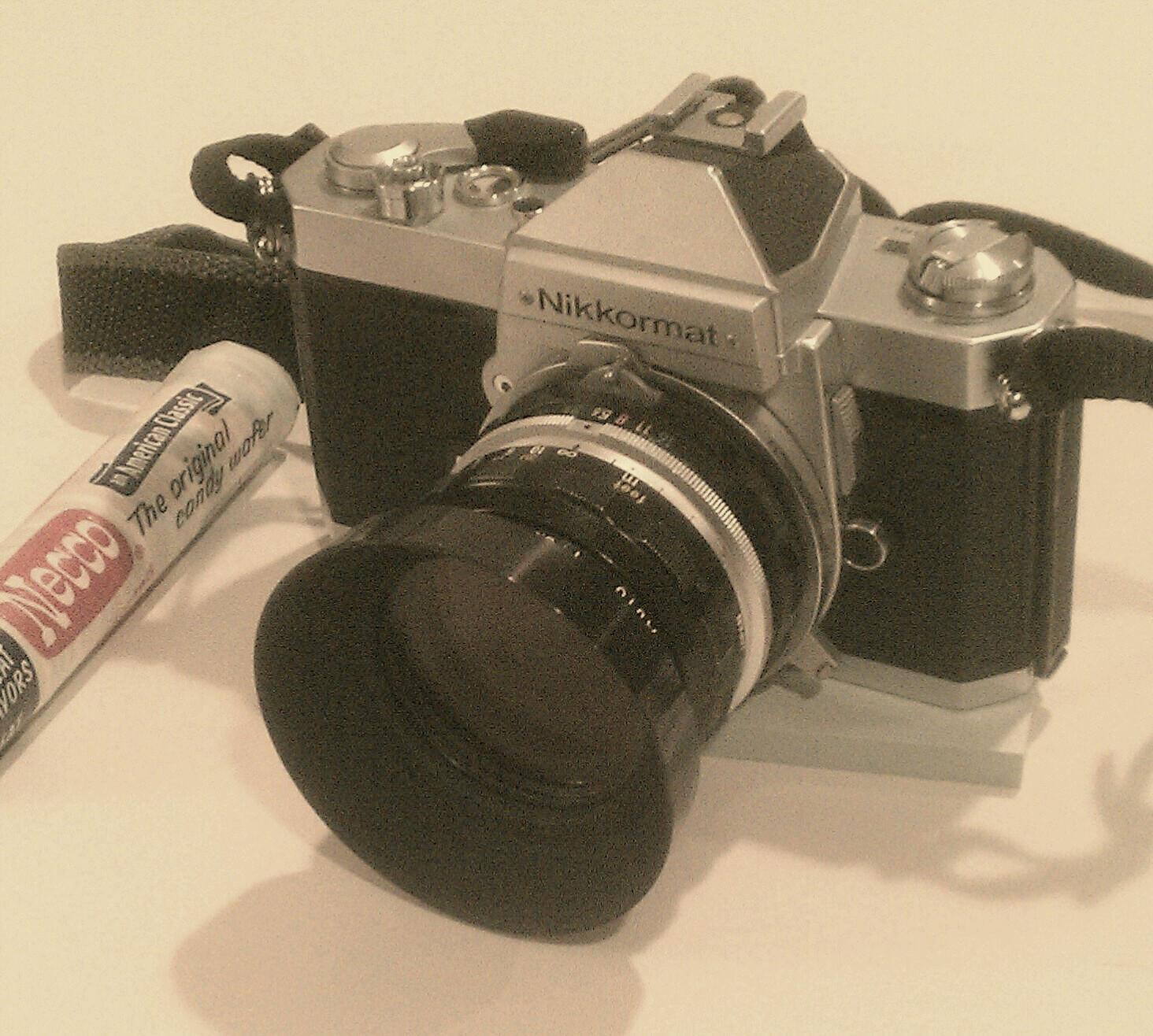

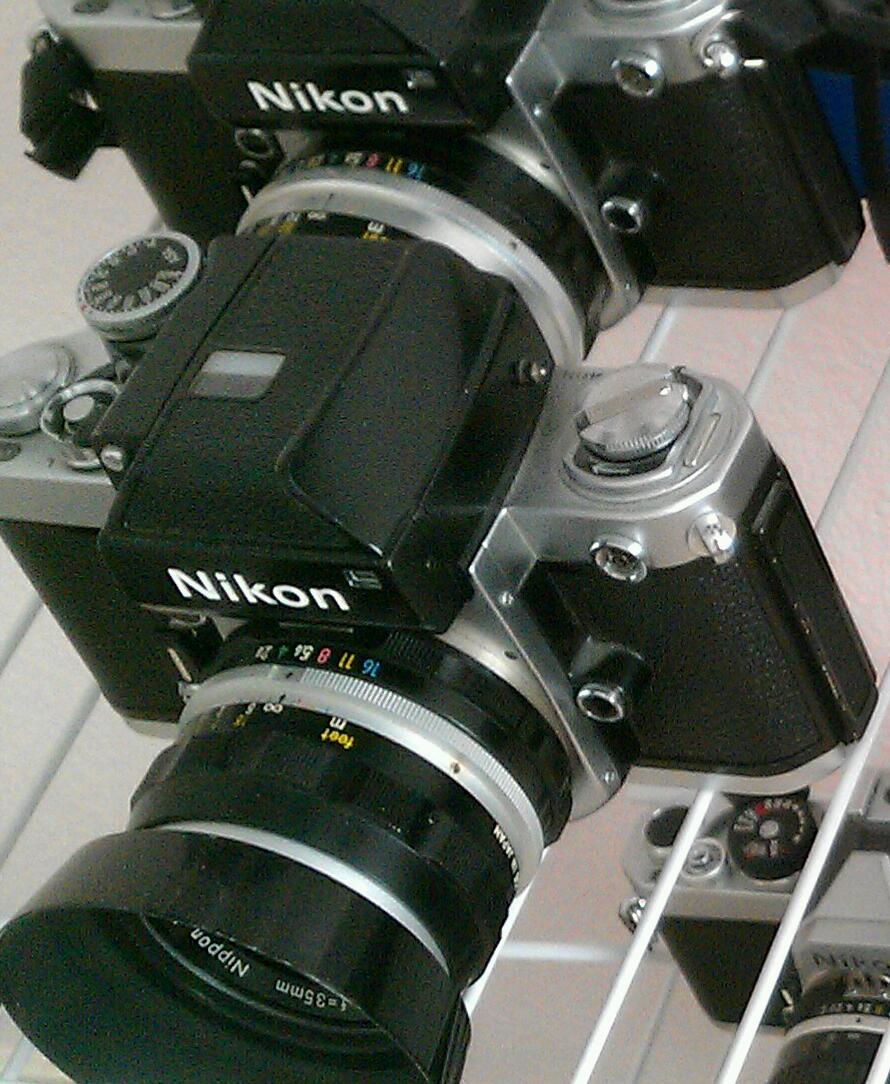

On this 28/3.5 and 35/2.8 they work really well - no vignetting and they do block stray light from the side.
On this 28-85 AIS, this hood (which is the recommended hood) vignettes badly at 28mm.
