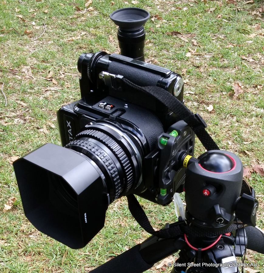

The Pentax 67 system has these sturdy clip-on and bayonet-mount or twist-lock hoods. For some, it requires a decent knock to dislodge the often quite large hoods (the SMC Pentax 67 90mm f2.8 has a conspicuously large and deep hood which won't budge easily). The wide and shallow hood for the SMC Pentax 67 45mm is curiously very easily dislodged by a stray hand moving around the front of the camera.

• "You call that a hood?? THIS is a hood!"
90mm f2.8 with clip-on square hood
