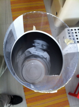

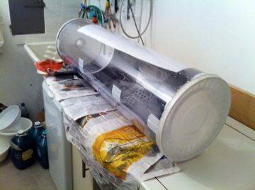

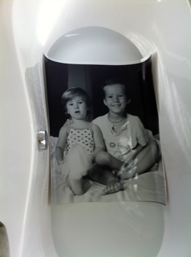

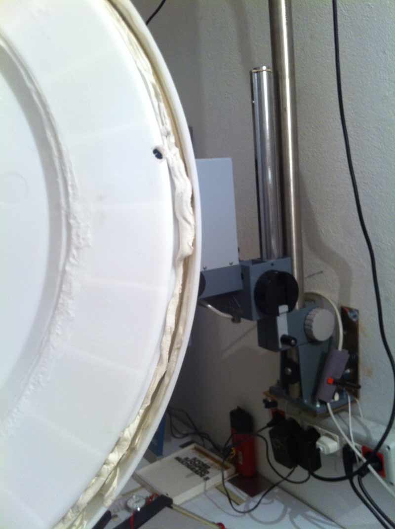

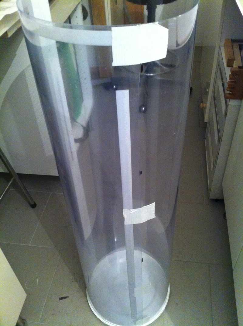

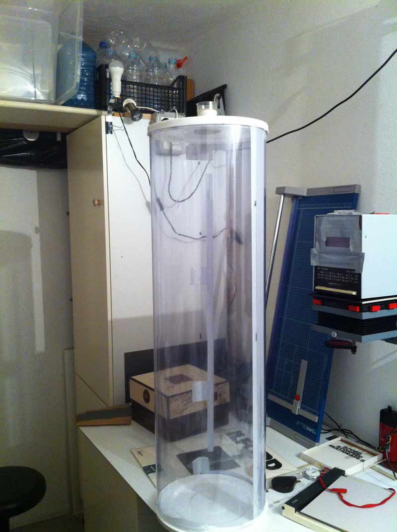

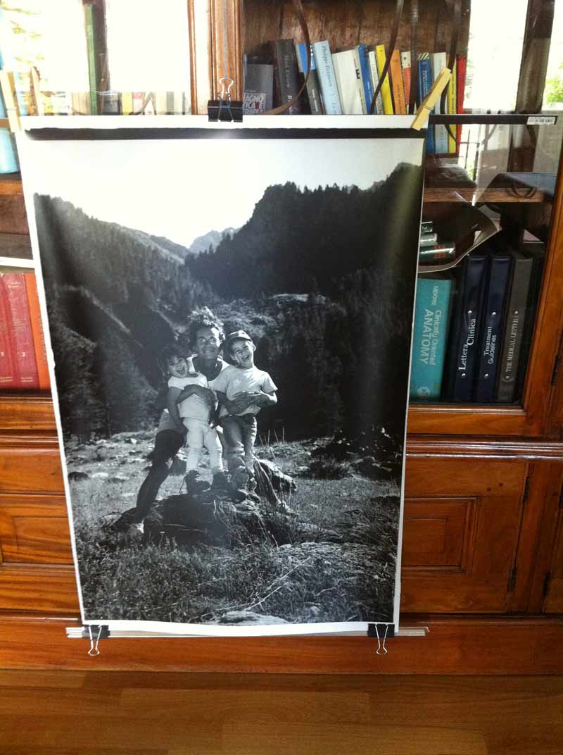

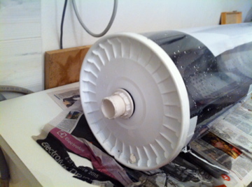

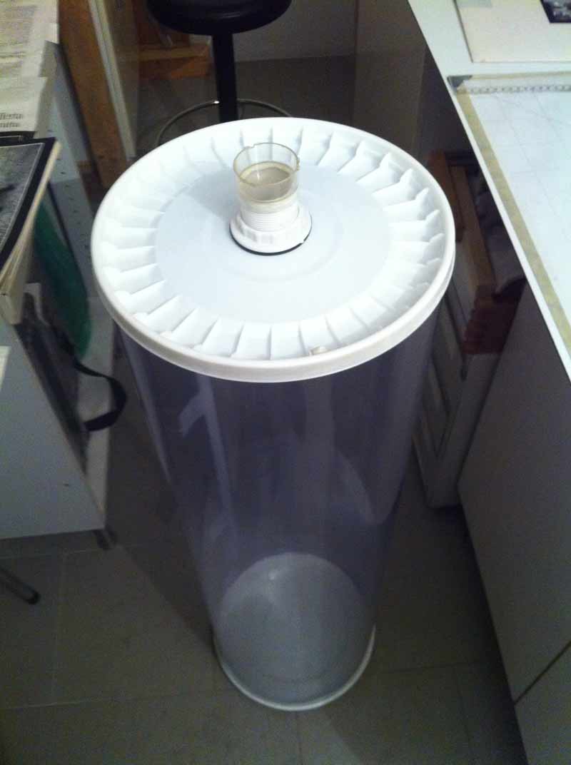

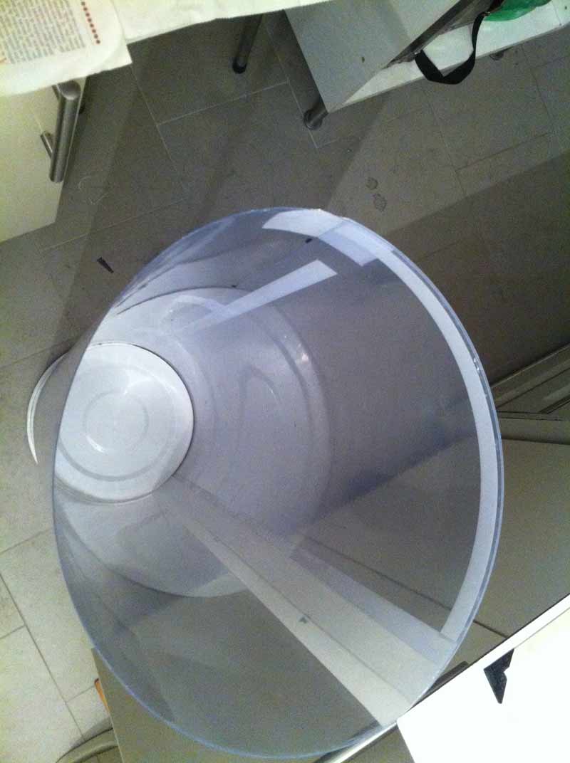

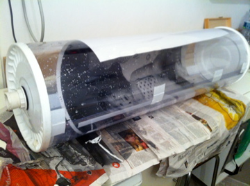

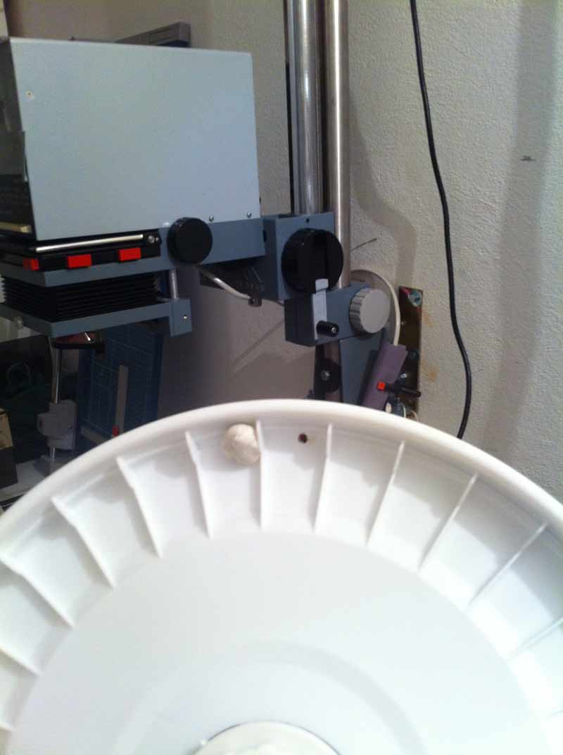

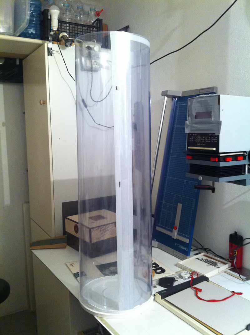

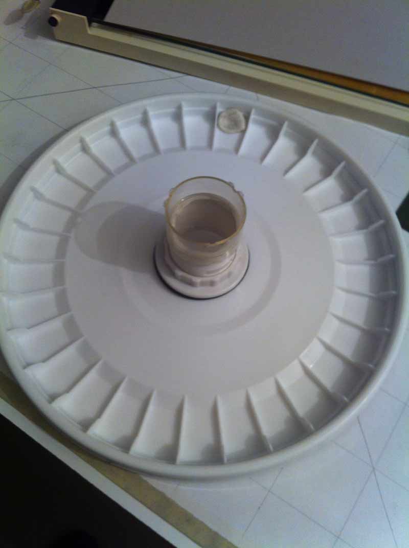

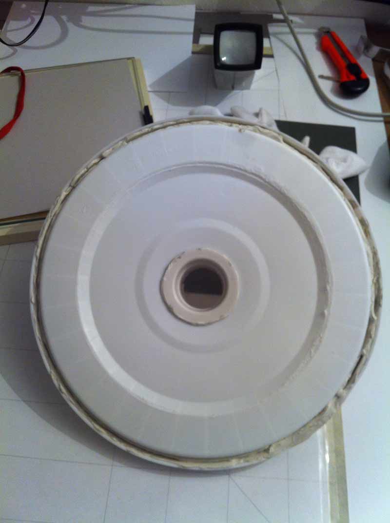

Here following is how I print BIG:
bought a PVC transparent foil 0,75mm thick, 100cm high 110 cm long. Here in Italy you can buy it by meter at 10 euros/m. Bought two big paint container's lids for 2 euro (30 cm diameter allow almost 90 cm x 90cm print). Make a hole in one lid's center and fit a plastic sink drainage with some sink plaste to stop fluid leaks. You have to roll your PVC foil the right dimension of your lid, use sone biadhesive tape to stop fluid leaks along the overlaying edges, than some tape outside. Put one (no hole) lid to one end and seal with silicon. the other lid will be sealed with sink plaste after inserting the exposed paper. To this purpose it's better to heat the plaste to allow tight sealing (hair dryer in my case). if you put inside the paper after wetting the drum youll have a perfect adhesion to tube walls. You can presoak with water, then dump off from the drain, insert the developer (2000cc is more than inhalf for my 70x100cm print) and on to the wash. My washing is with a plastic water pipe inserted in the drain with a strong water pressure washing the paper in an upside down position in a way that can allow prompt water discard through the drain. The small little hole you see in the lid border is to completely empty the fluid with some ease.
I tryed this configuration several times and as far as you seale well the lid you'll have a very fast and light System.
My total bill was less than 30 euro; if you need bigger than 100X90 you can buy a longer roll. the limit is how big you can find a lid and how wide you can find the PVC roll.
some advanatges are: very light, cheap, you develop by inspection, when not in use can be dissassembled, you can have many dimensions and work with a small amount of solutions, can be rolled on a table as a common drum; if needed you can make a rolling base easy because it's very light.
disadvantages: fluid leaks if you do not seal well the removable lid (occurs with low temperatures as the plaste get harder with cold); do not know if it works with FB paper due to different consistence and threatment's times (I use RC paper in rolls 110 cm high).
I'm sorry for pictures quality; prints you see in pictures are 70x70cm and 95x65cm.
