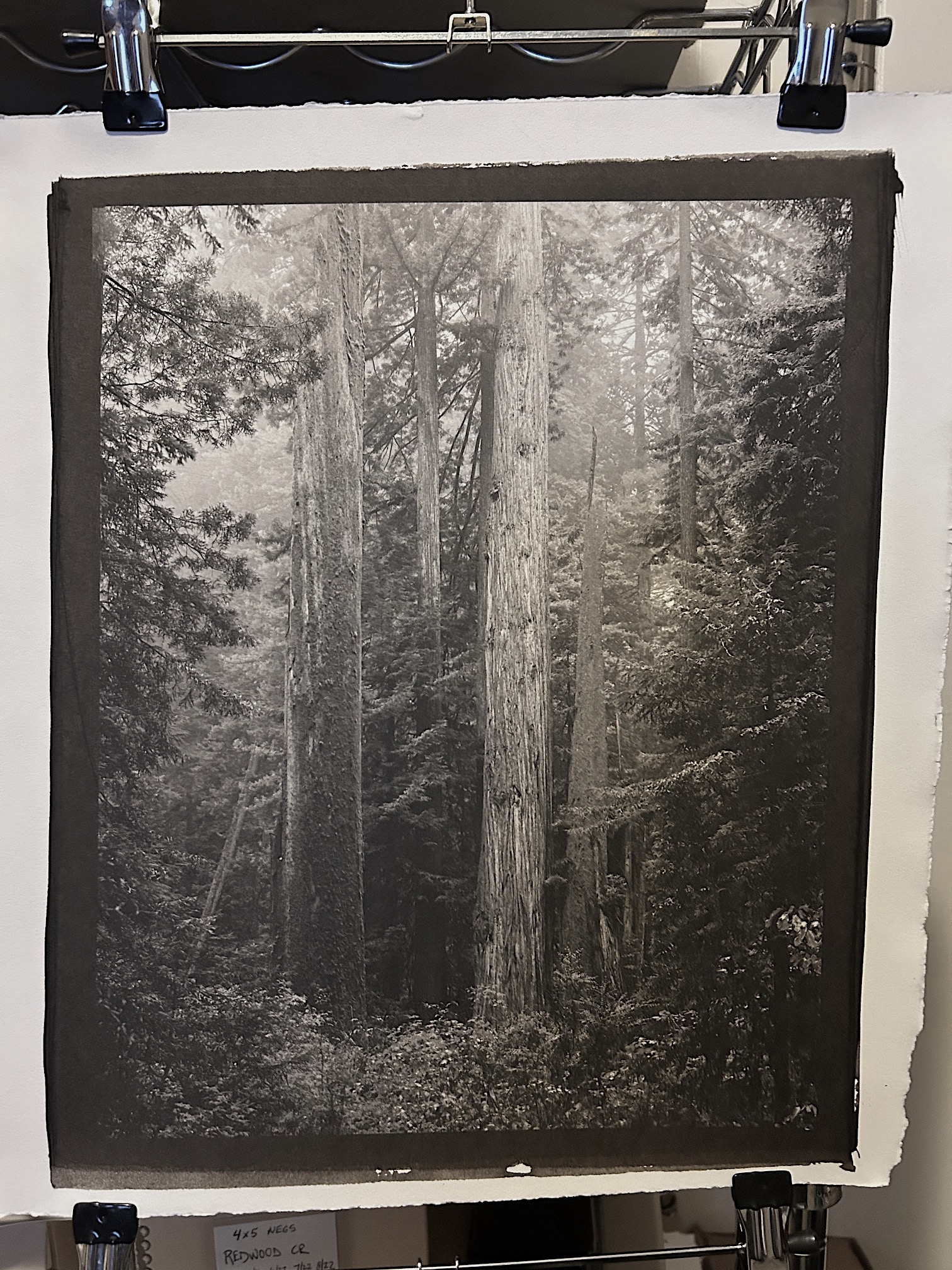

Did you mean to insert an image?
No -- it was a written example. But here is a iPhone image of the print. The actual print is darker with less contrast. It is an interesting situation -- the fog moved in swiftly during the 30 second exposure and giving the image two areas of different contrast.
I just need to work with the negative and process a little more. I'm a little rusty with printing pt/pd 11x14. I have a roll of HPR and it even took me awhile to remember which side to coat. I need to increase the amount of solution and fine-tune the Tween.

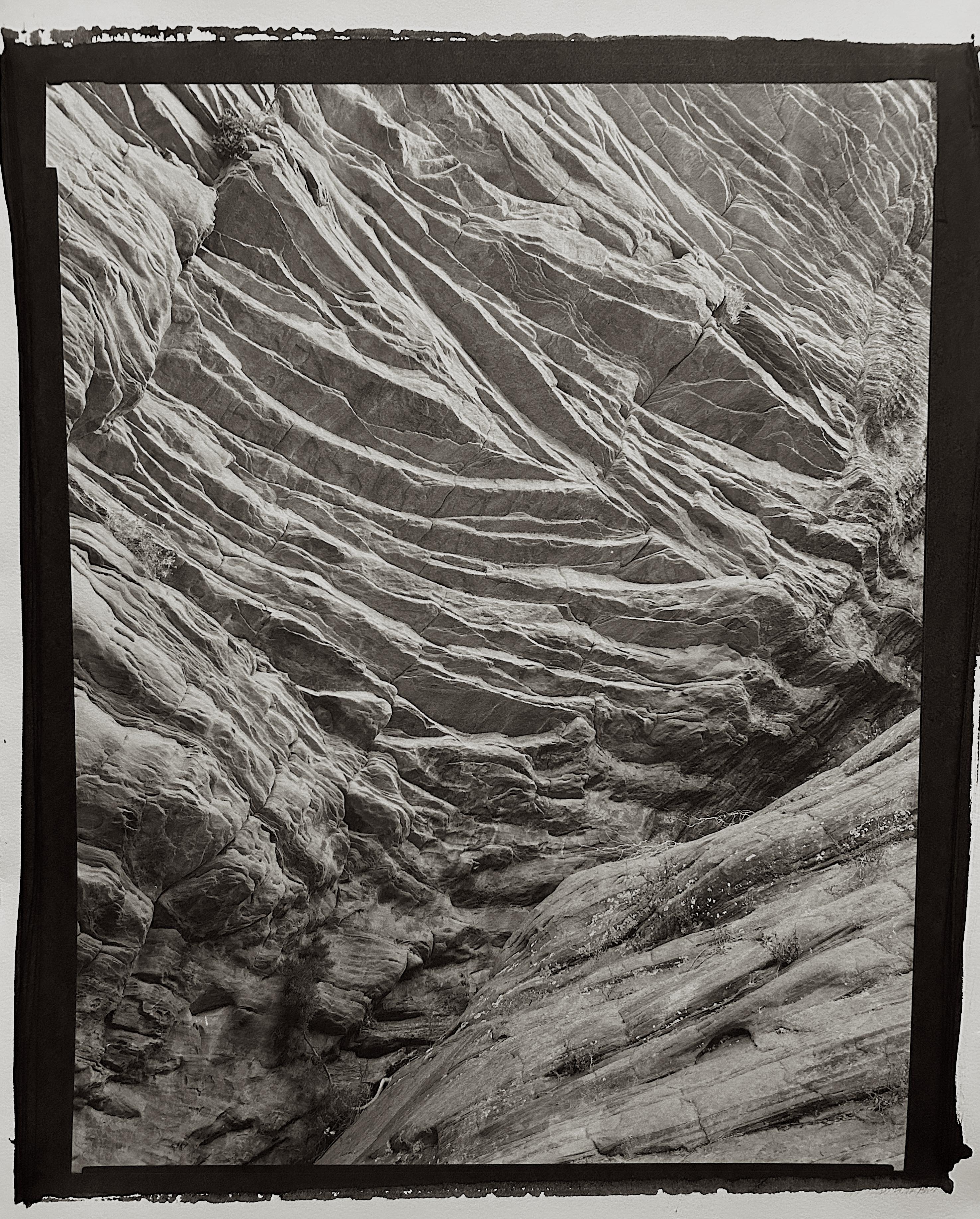

I also attached the other print I made -- film developed with PyroCat HS (Zion NP)
