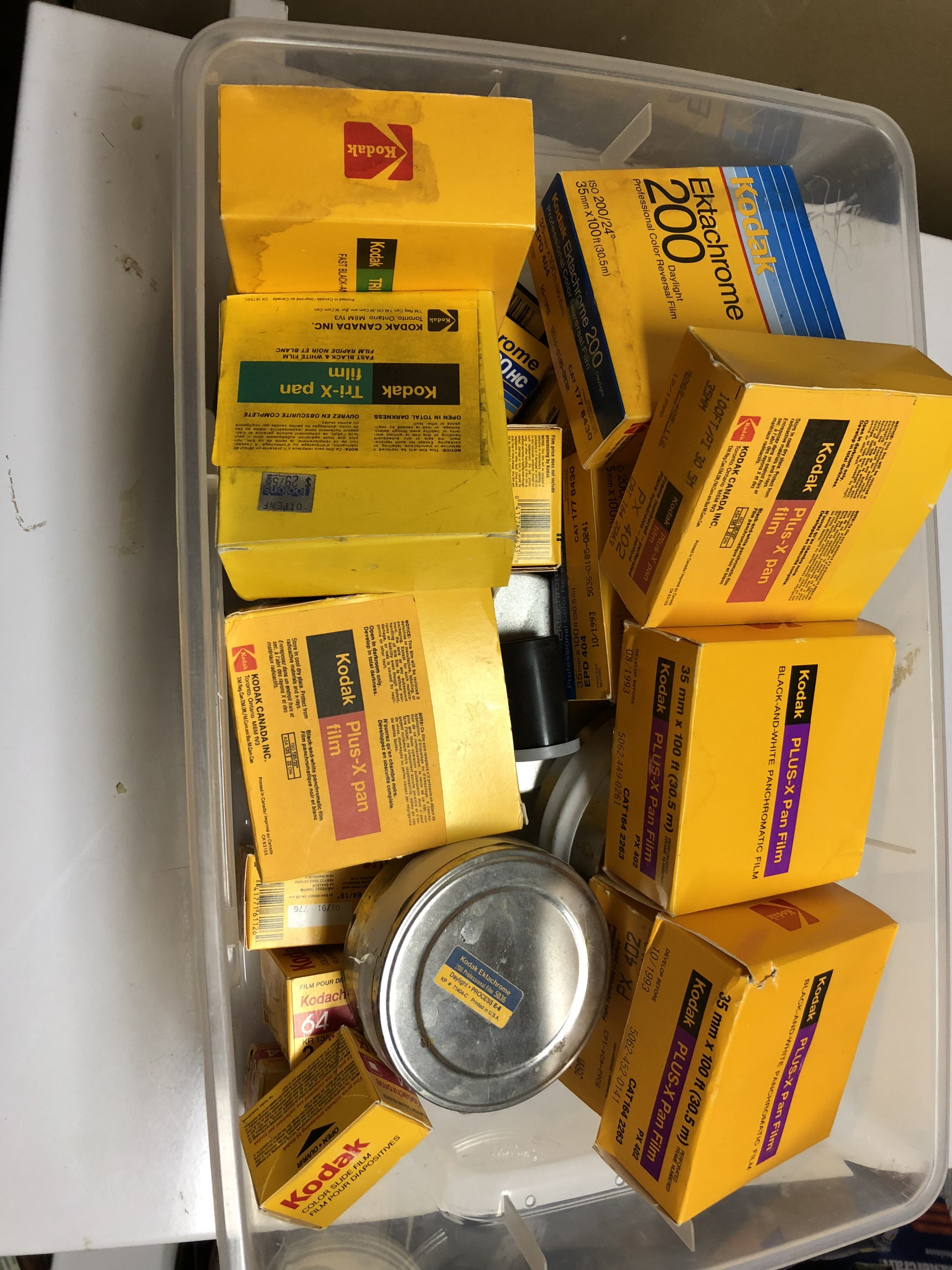

plus-x pan-x and ektachrome 200 all expired in 1993 is it worth buying.
Do you think chemicals are ok?I would pick the Pan-X, Tri-X & all these cassettes.
i think it was stored in a basement for 25 years.Any idea how it was stored? I'll buy all the Ektachrome off you. I'm located in Nova Scotia so shipping shouldn't be too bad.
Thanks DavidChemicals OK if package not damaged. Plus-X OK but will evidence some fog. Read my post about age-fog from a few weeks ago. Ektachrome NOT OK, but can be processed as B&W with Dektol followed by Farmer's Reducer.
The B&W powdered chems will outlast you. Keep in secure, closed containers. Slight browning of developer powder is of no concern. Kodak's cans were excellent, much better than their disgusting foil packs. - David Lyga

I read "5302" as February 1953 on the box.
