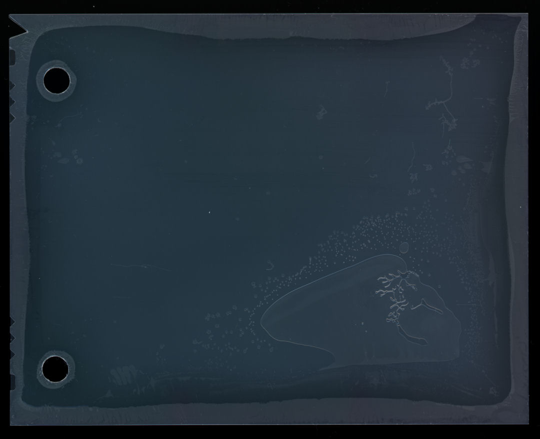

Example of Laminating with CMC Gum
This is a transmitted-scan of two fixed out sheets of b&w film, laminated together with 4% CMC gum.
The bubbles are what I'm trying to eliminate, and the main area of distress in the gum layer is due to some separation at that point.
The upper left half is what I'm striving for.
After scanning, I pulled the sheets apart without water and without much difficulty. It had been about 6 days since they'd been laminated and the inside was still slightly moist. I have no idea how long it might take until the CMC gum dries out, or what affect that would have upon the ability to easily separate them. Time will tell, but at the moment I'm having trouble getting all the gum to come off the sheets in a water wash... and I want to avoid as much abuse as possible to the undeveloped film, sooo damnitalltohell at the moment...
