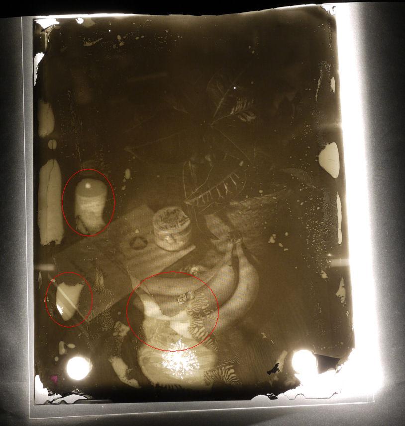

However, I get the impression that the density is not just underexposure, it seems like there's too much detail to have been underexposed.
Here, look at the circles I've drawn on the picture. At these points, the density is decreased for whatever reason and the positive image kind of shines through, suggesting that the whole thing is "veiled" in some way.
Now I'm really wondering about the 5% chance that this sheet got compromised in the processing stage.

How about something in the "glue" affecting the process?
Paint some glue on a sheet and expose. Then process as you did before and see if there is any substantial change.

Maybe something in the "goop" you used inhibited the first development step.
IDK.
PE
That would fit my outcome I guess.
If so.. let's reason it out... the first dev was insufficient, i.e. weak negative image, this was bleached away, leaving an excessive amount of silver for the positive image.
That also might explain the points of more normal density. They seem to correlate with areas that "historically" weren't getting the best "gluing action", that is, right around the registration pins.
Some of the strange patterns in the image are definitely from the actual exposure, me thinks. Meaning, the patterns were recorded on the film during exposure because the gelatin wasn't optically cementing the two sheets together at those points. In turn, it would make sense that those areas received a higher degree of development, having access to the solution.
