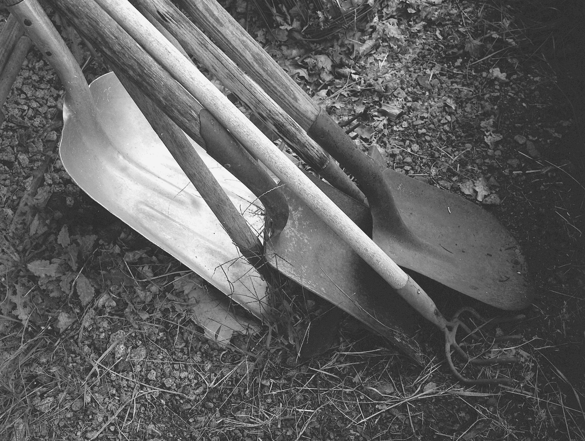

Here. Three identical shots. -2 stops, box speed, and +2 stops. Deliberately high contrast scene, I exposed for the projected negative on the paper.
Minus 2 stops
Box speed
MattKing
Apr 24, 2005
55,141
Delta, BC Canada
But it will be the same response curve for every scan, which means that different scans can be compared to each other.
Not really, or at least it isn't quite that simple.
The complicating factor being that the density differences and contrast differences between the negatives will place the images on different parts of the curve.
Which means the scans will require different amounts of adjustment to achieve relatively similar end results.
The flexibility is great - you can achieve acceptable to great results from a large variety of negatives. But that flexibility makes it difficult to objectively evaluate the negatives themselves!

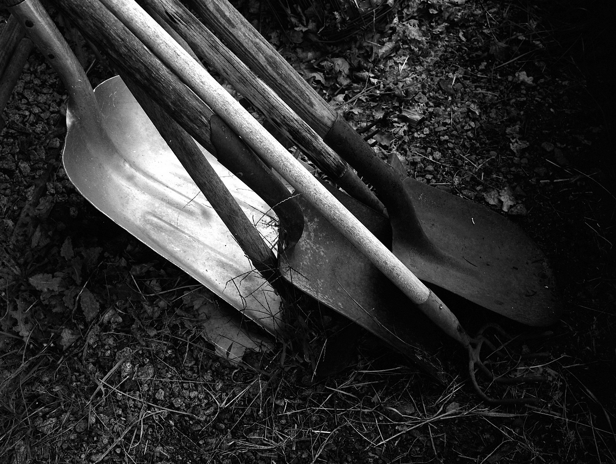

Plus 2 stops. If these were anything but test shots, I would not have exposed for the white paper.

The plus 2 stops looks pretty good to me. As a complete ignoramus when it comes to scanning and its software can anyone say why this reversed negative cannot be made into a reasonable print?

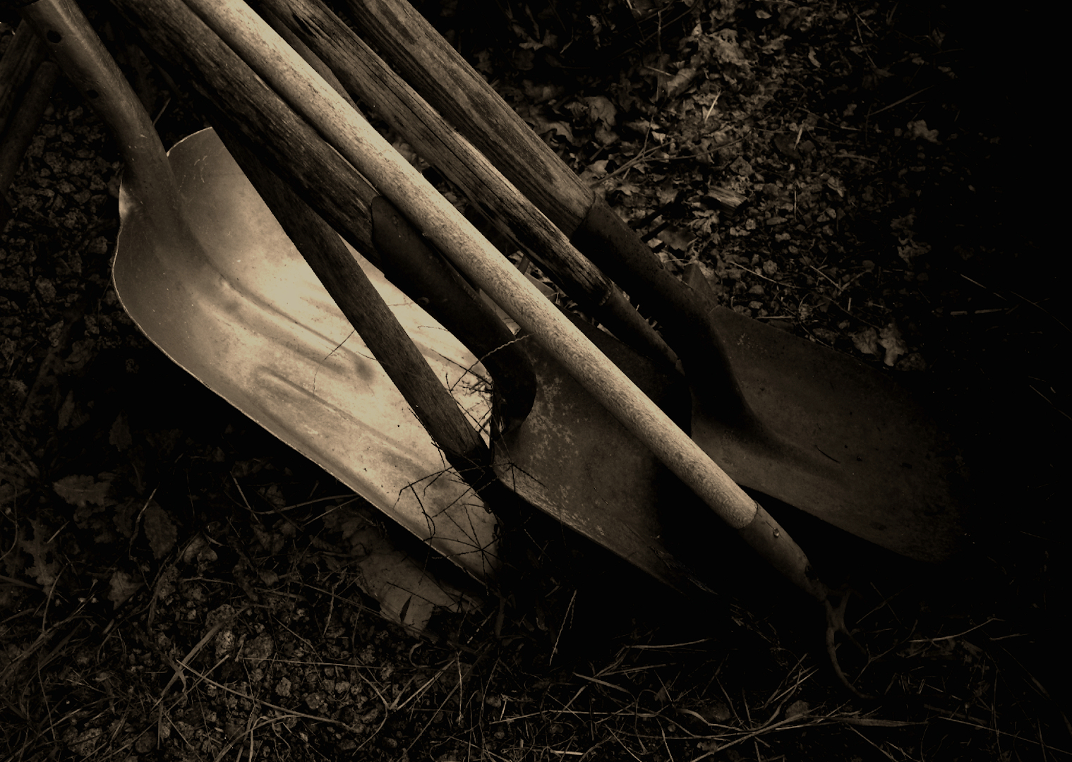

Three versions of the same image here. All are from the same original scan of a film negative. The negative is metered normally - most likely using incident metering rated at box speed. It was also developed normally for that box speed, except I gave it a one stop "expansion" development, because the light was quite diffused that day. The negative has a full range of densities and looks "good" to the eye.
The first is similar to how a straight darkroom print appears - adjusted for normal contrast, and exposure referenced mainly to the mid-tones and (specular) highlights:
The second is adjusted digitally to increase contrast and deepen shadows - similar to the results obtained in the darkroom with a higher filter number. In the equivalent darkroom print I also did some judicious burning and dodging. I believe this is similar in at least some ways to the effects you appear to like from under-exposure and "push" development:
The final version looks most similar to my exhibition darkroom print. In order to take into account the intended toning, the exposure was adjusted slightly. I've also experimented with some localized bleaching with this one, although I'm not sure this scan reflects the results of that:
I show you this to help illustrate the fact that one can achieve a lot of the results you like at the end stage - either while darkroom printing, or digitally post-processing. IMHO it is better andf easier to do that with negatives that are better exposed and more conventionally processed.
By the way, these scans came from 6x4.5 T-Max negatives, and my Canon flatbed scanner was bought used for very little money. When I started using it, the results were really mediocre. But I got better at it.

Thank you, those look great! You’re right, I do prefer the higher contrast one :smile:

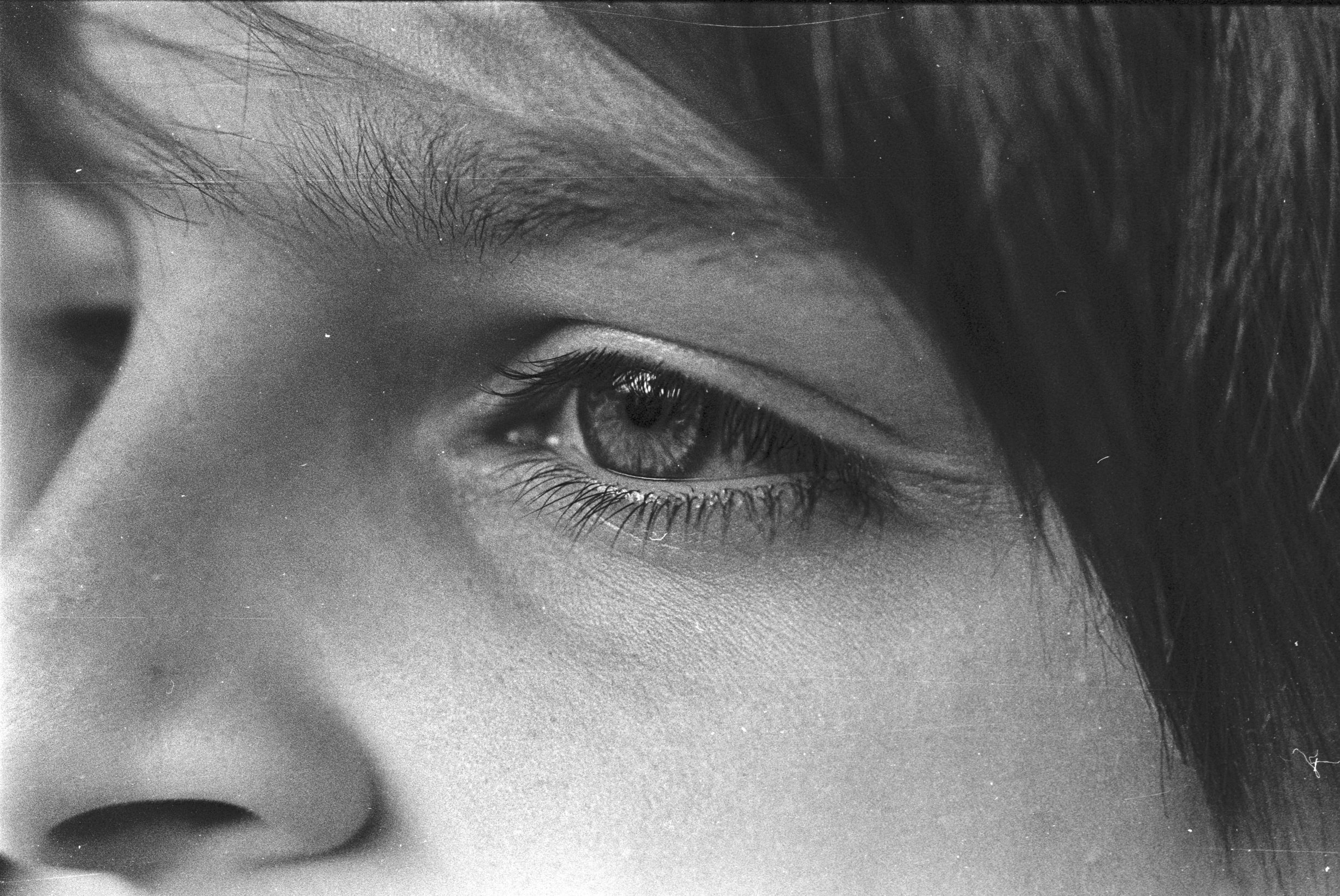

Just to show you that I'm not completely crazy just yet, here's a darkroom print from today. I used what I think Foma intended to be grade 3 filter.
I tried putting it on the flatbed scanner, but it's old and crappy and the scan was a poor resemblance of the real thing I include the negative scan (with no adjustments applied) for comparison.
Edit: This was at box speed, ISO 400.
