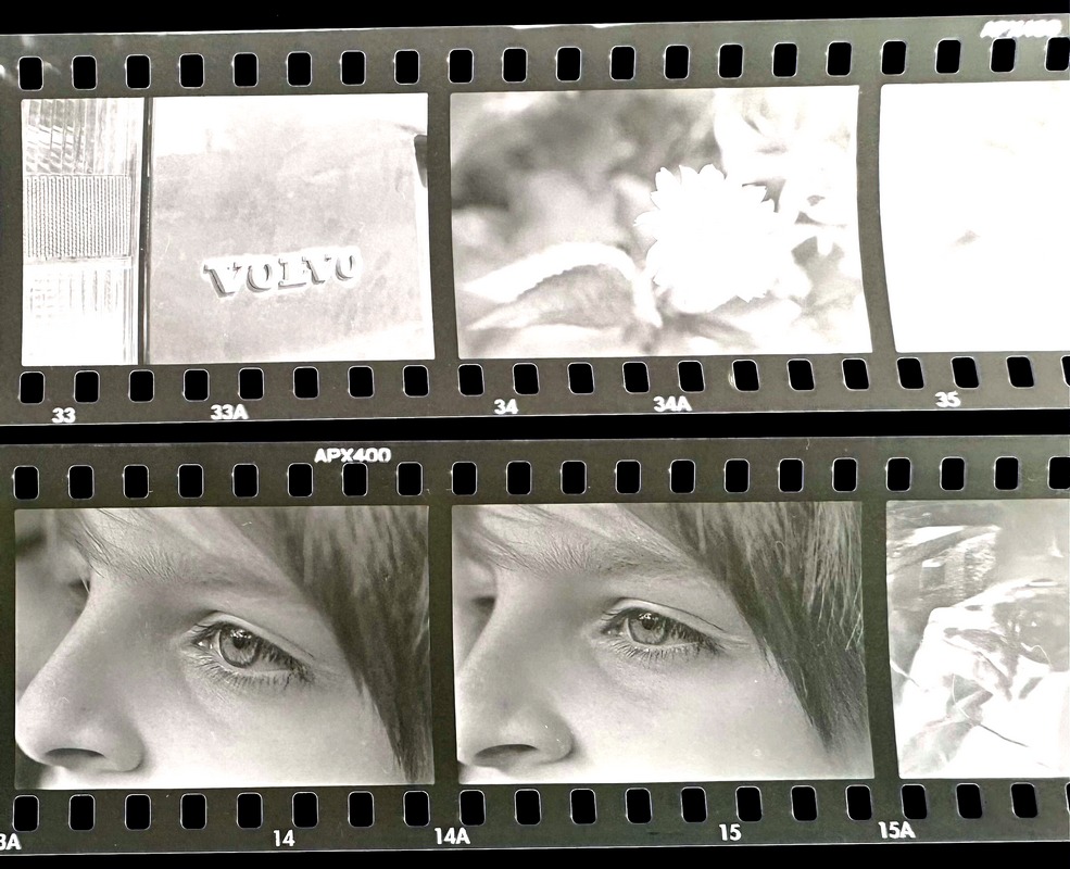

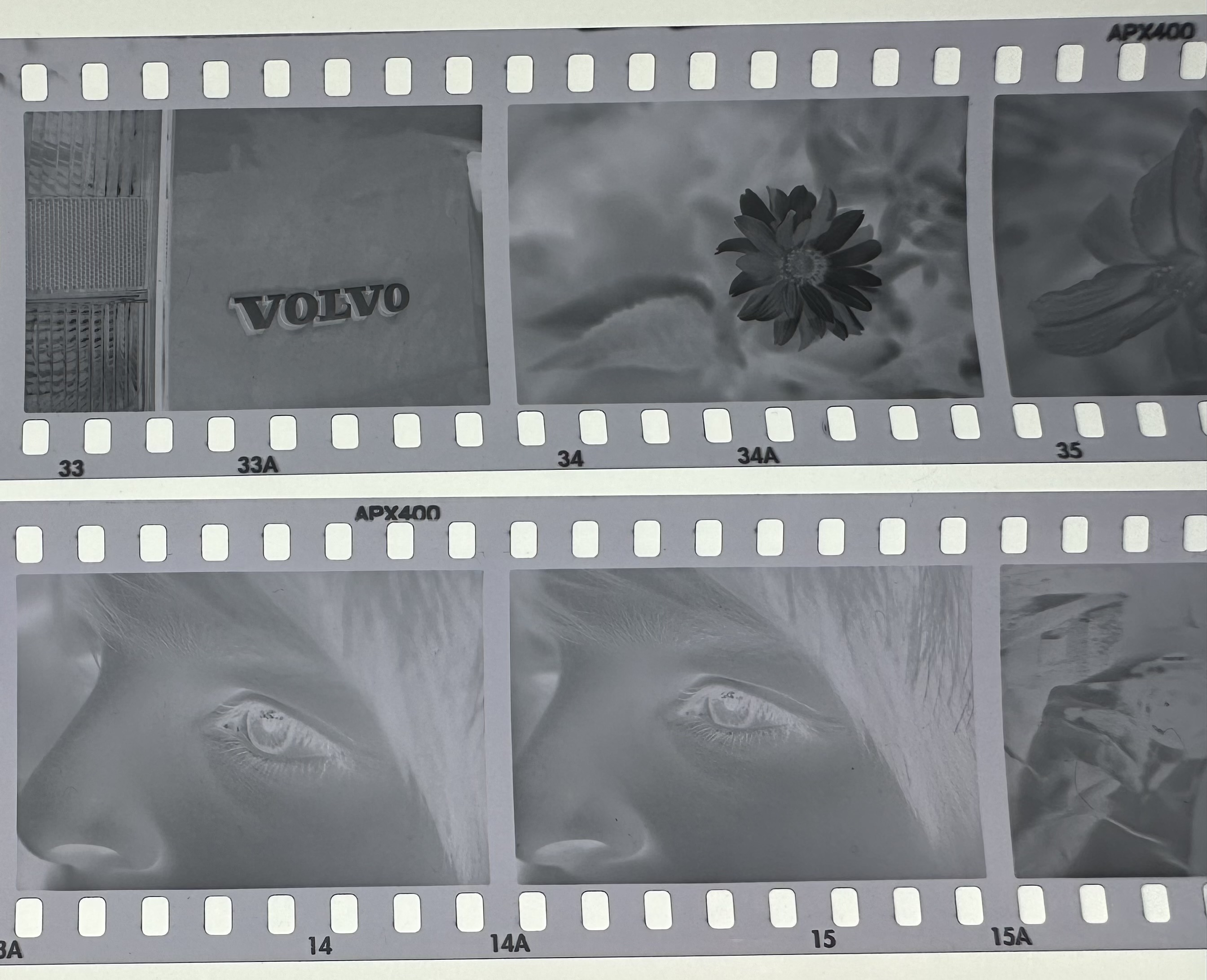

Here’s a comparison between the 60 minute roll and the 90 minute roll. The 90 minute roll looks a bit better to my untrained eyes.
The 60 minute time is definitely better!
After a bit of digital tom-foolery, and arbitrarily making some choices:

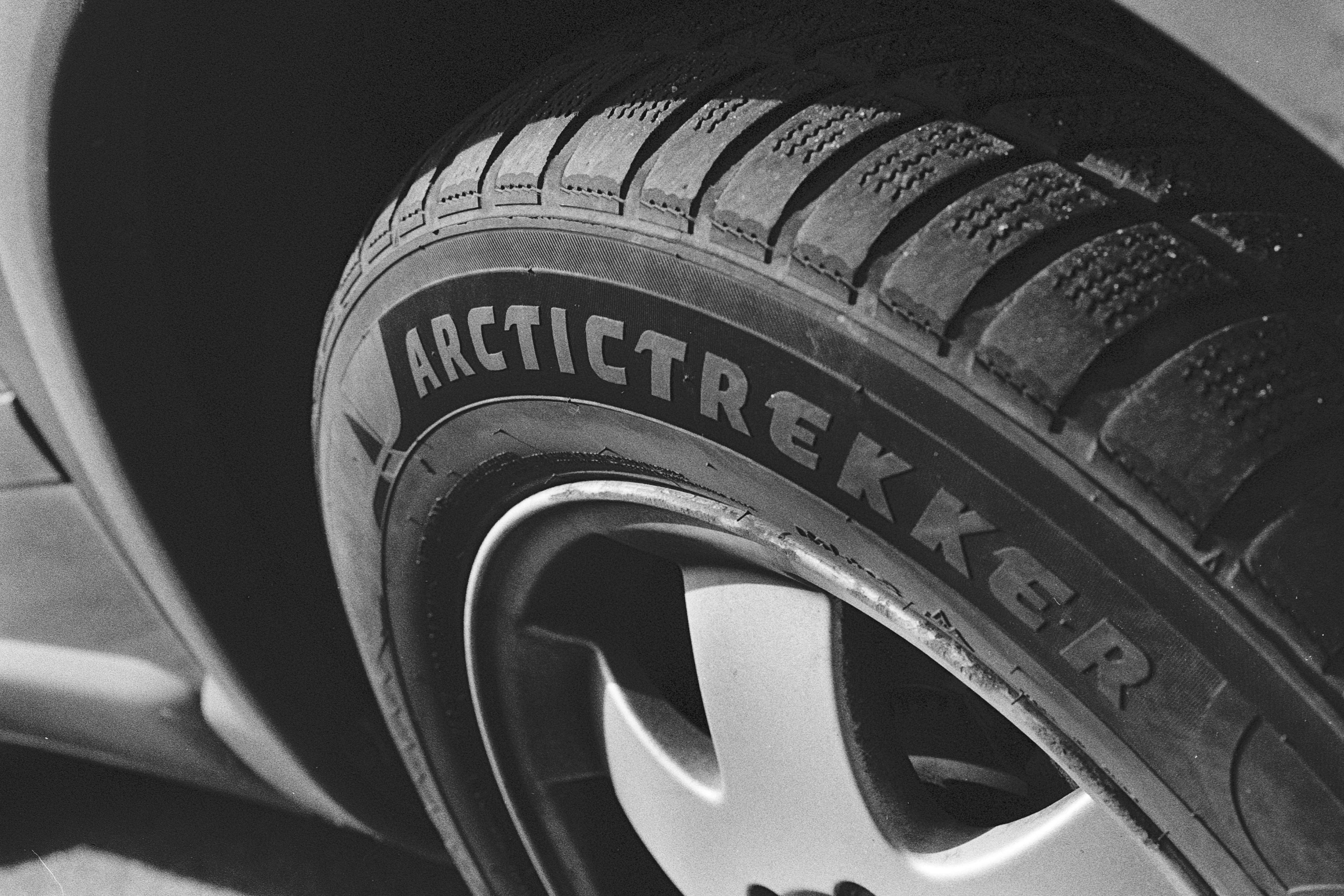

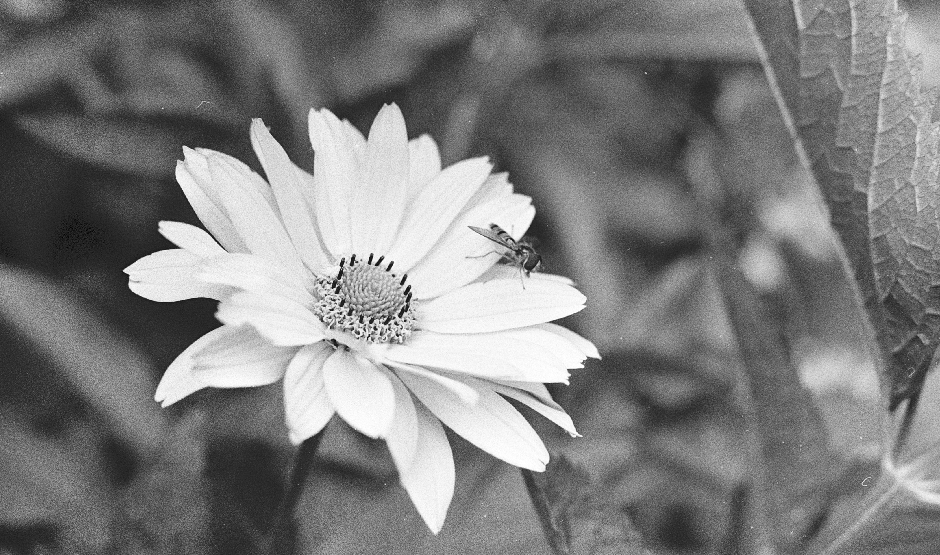

That is very weird. The 90 minute ones scanned much better than the 60 minute ones. I had to do quite a lot of exposure and contrast compensation in the scan software for the 60 minute strip. I did none at all for the 90 minute strip.
And another. These do seem a bit grainier than the 60-minute ones though.
A good negative doesn't look to the eye like a "pretty" print. The process of printing a negative inherently boosts the contrast of the result. So films and developers are designed to produce negatives that look low contrast to the unaided eye.
If those higher than ideal contrast 90 minute negatives are scanning easily, it means your scanning is set up to decrease contrast.

I am confused here. Which strip is the 90 minute one. There looks to be a difference in the only 2 negs that are the of the same picture of your son. In that strip, the lower one 15 is better than 14 in terms of highlights, namely on the face and looks to be the one with the greater time in the developer but are both on the same strip so presumably were developed for the same time? Hence my confusion
No confusion with the second set of pictures of the flower and tyre. If these are the 90 minute ones then certainly if these are straight scans they appear to be better for printing as well
Neither do I understand what Matt is referring to in terms of which were subject to digital tom-foolery nor what the arbitary choices but that is for Matt to comment on.
Sorry for the confusion :smile: the top strip is the 90 minute one. Both faces are on the 60 minute strip, same exposure only seconds apart. There were fast clouds, so the light might have changed a bit in between.

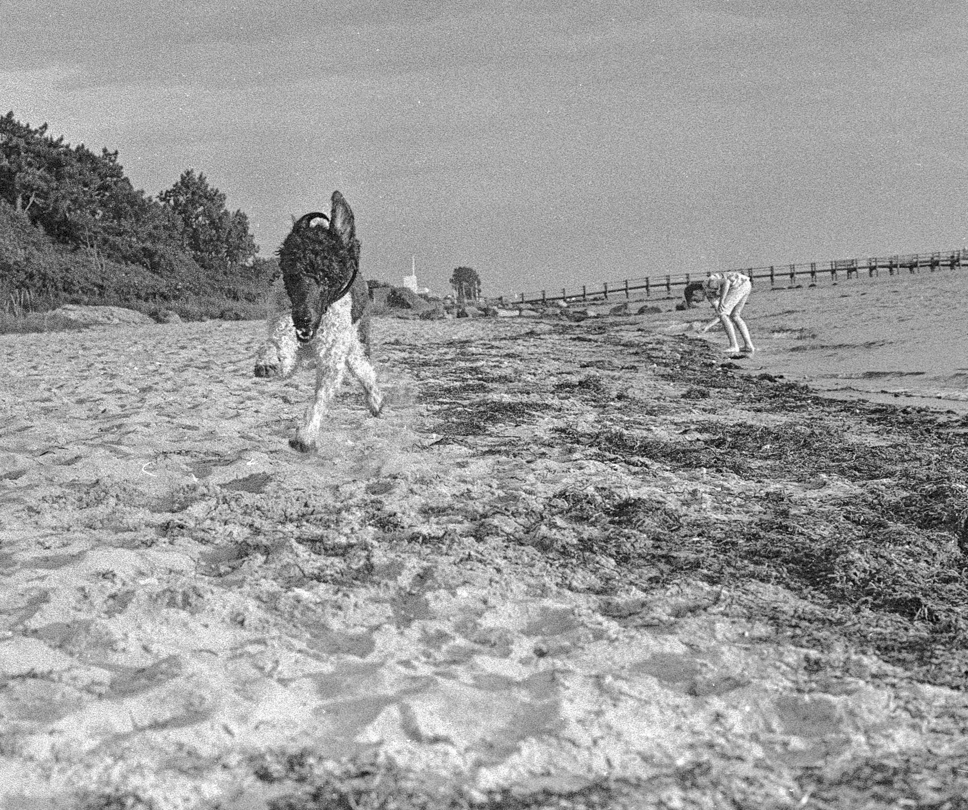

OK, last one. I think.
Remember, this is for the sake of experimentation :smile:
I did this one today, still same film, same camera, same lens, still pushed two stops. 60 minutes in Rodinal 1:200. The only thing I changed (to test if the developer depleted itself) was that I replaced the developer with a fresh batch of 1:200 after 30 minutes. Notice how incredibly grainy it is, they all came out like this. Compare it to the other ones above.

It may be time for a discussion on this from those who do both Can the tyre and the flower negs be reproduced as you have managed to do in your reverse scans to make them look as positive prints
Is it as simple as underdeveloping and printing at a higher grade to get the darkroom print to look like either reversed scans of the two negatives of your son or do you have to decide on either greater development and successful darkroom prints or lesser development for a successful scan and accept more and possibly much more difficulties in this case with producing a successful darkroom print?
From my possibly naive point of view it would seem that the magic of scanning in the case of the two negs developed at 90 mins has produced a good print and it is this allegedly over developed negative that others have said creates less problems in the darkroom than the 60 mins developed negative. So that suggests that longer development may be the better route
