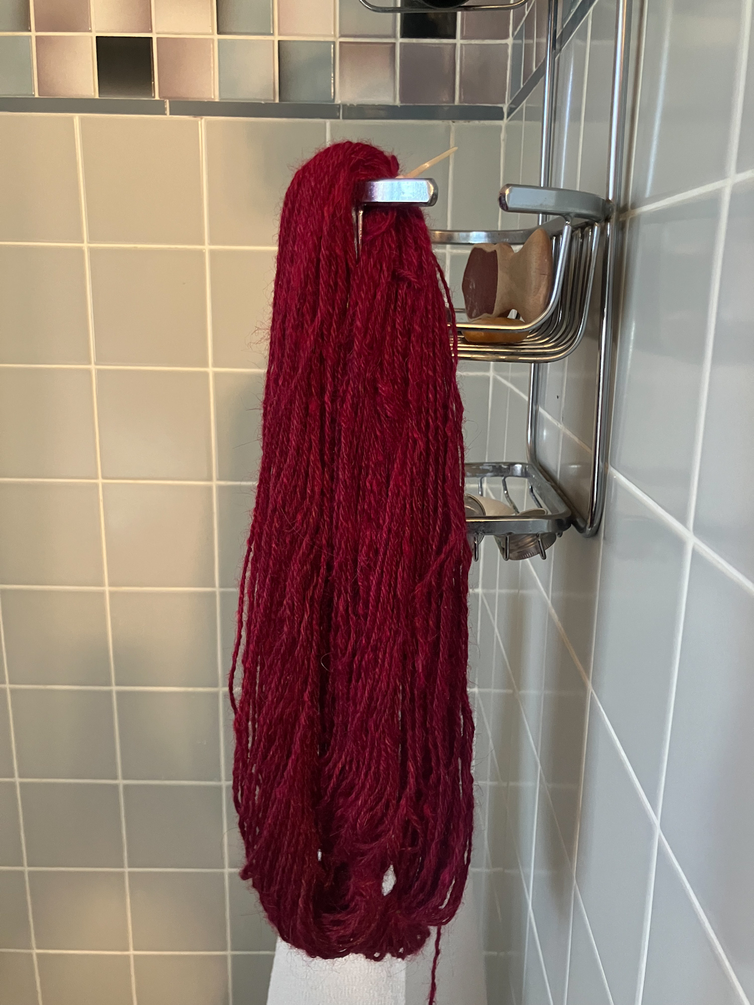

My wife used poke to dye hand spun wool last year with really astonishing results. So unfortunately I agree with F4U I think this will make your paper an amazing magenta.

My wife use poke to dye hand spun wool last year with really astonishing results. So unfortunately I agree with F4U I think this will make your paper an amazing magenta.
