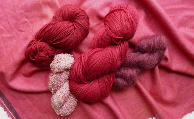

Started by just trying various paper scraps around to see how it would affect them and ... no effect whatsoever.
Startled that it has ZERO ability to tint my watercolor paper that i use for cyanotypes.
"Pokeberry does not work well on cotton, hemp, linen or other plant fibers"
"It seems to work best on wool, with silk turning out a coral color. The cotton cross ties in my skeins did not absorb any color at all. "
So what you observed might not be out of place. However, you should try again after heating the juice without boiling.

I had hoped to tint the paper first and then expose cyanotype over the tint, but guess that's not going to work.
Maybe I will try putting a small portion in with the A+B mix and, if it doesn't coagulate or precipitate, see what happens.
Not sure what you are trying to do here. You want to tint the whole paper magenta and then print cyanotype over it or you want to tone cyanotype with it. If latter, it is good that it does not touch the paper. That way your highlights will stay white. You might want to try and see what happens when a printed cyanotype is treated with tit.

Either way, I can't think of anything other than sizing that would make watercolor paper impervious to pokeberry ink. Maybe there's more to making the ink from pokeberries than just boiling the juice?

In order for poke berries to be most useful for alternative processes, you have to get it to bind selectively to either image or non-image areas.
The experiment that left paper untouched is actually a good sign. The beautiful dyed yarn is another.
Don’t actually know how to make image or non image area attract dye though. There is oil and water in lithography, batik
/ waxed fabric and those dyed Easter eggs.
The chemists here might know what things can bind to Prussian blue, and then what things can bind to poke berry juice
